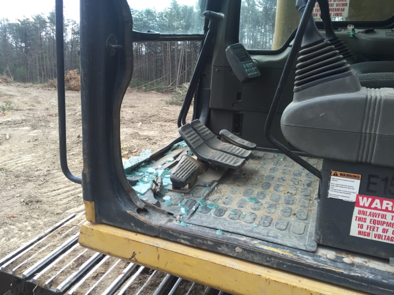

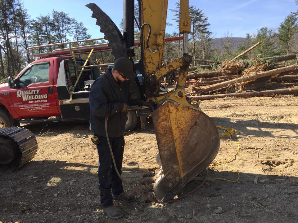

Having missed 5 days of use, and being near the end of my vacation, I pushed the envelope as hard as I could to get things cleared. I have taken down the trees on approximately 2 acres. I'm hoping my lumber guy comes thru and has moved them off that parcel of land so I can start using the tractor to prepare the soil. The night I got it running again, I broke the windshield.....The next morning I had to get online and put in a few hours for my day job. I got out there and put in some plexiglass as a temp fix.....and broke it within the hour. Too much enthusiasm.......and to top it off, a few hours later, I saw that there was a crack in my bucket. all I can figure is that I didn't dig as much as I should have on a stump, and instead, I was prying and pulling. That was an hour before dark....I kept working, trying to be careful with it...First thing in the morning I was calling around trying to find another bucket...no dice. Called a local welding shop and by chance, they had one of their guys finishing up a job that morning. at 9:15 they called me and said they could get him out there in 20 minutes. I met him and showed him the way and he had it repaired and I was back at to work a little after noon. Quotes for a new bucket were around 3 grand. I didn't find any used that would fit. Today, since I was back home, i called the local Komatsu equipment dealer who had the windshield I needed for less than the internet price, and also who could get me a bucket in 2 days for over a grand less than I was quoted elsewhere. I need an 18 inch bucket anyway, because I have to dig the channel to put in conduit for our power to get the half mile from the road to the homesite. It was an easy decision. This has been an adventure so far. weld.jpg

Nice that you got the welder there so quickly!!!!

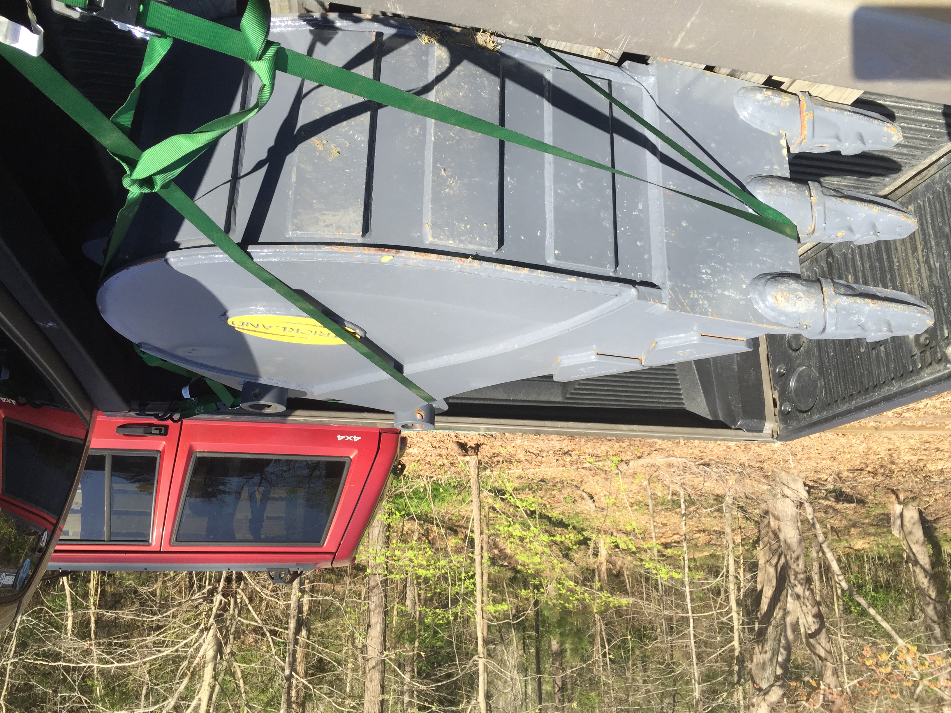

Since I will have a very long trench to dig, as well as footings for the house, and lots more stumps to deal with. I picked up a little something for the Komatsu today.
