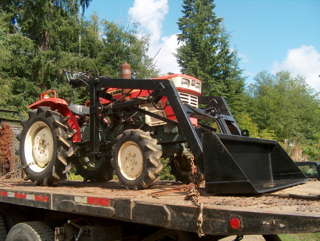

We manufacture, and sell loader kits for the Yanmar tractors. Our kit for the YM2210 is $1800, plus shipping to the nearest LTL terminal. We cover some of the shipping, but the rates we seem to be getting from Fedex are in the $300-350 range if you pick it up at one of their terminals.
Our kit uses all standardized hydraulics, cylinders, valve, and fittings.
I'm not on TBN too often, but you can call me if you had any questions.
Ray or Henry - 360-533-2160

I would wonder about the single curl cylinder allowing considerable bucket twist while putting heavy load on one end of bucket. May work great but I don't believe it is the industry standard. Pricing is sure in line.
   / Koyker loader quote #17
A "heavy load" on one end of the bucket is just unsafe whether you have one bucket cylinder, or two.
Industry standard? Kubota makes a 3 cylinder loader for it's compact tractors. Here is an image I borrowed from another TBN thread. This is a Kubota BX25 in the photo. Correct me if I'm wrong, but I believe it's a 25hp tractor. The YM2210 is also in the 25-26hp range.
A 3 cylinder design is not just found on compact tractor loaders. Take a look at wheel loaders, and you'll see many also use a 3 cylinder system for their loaders. A CAT 910 is a good example.
