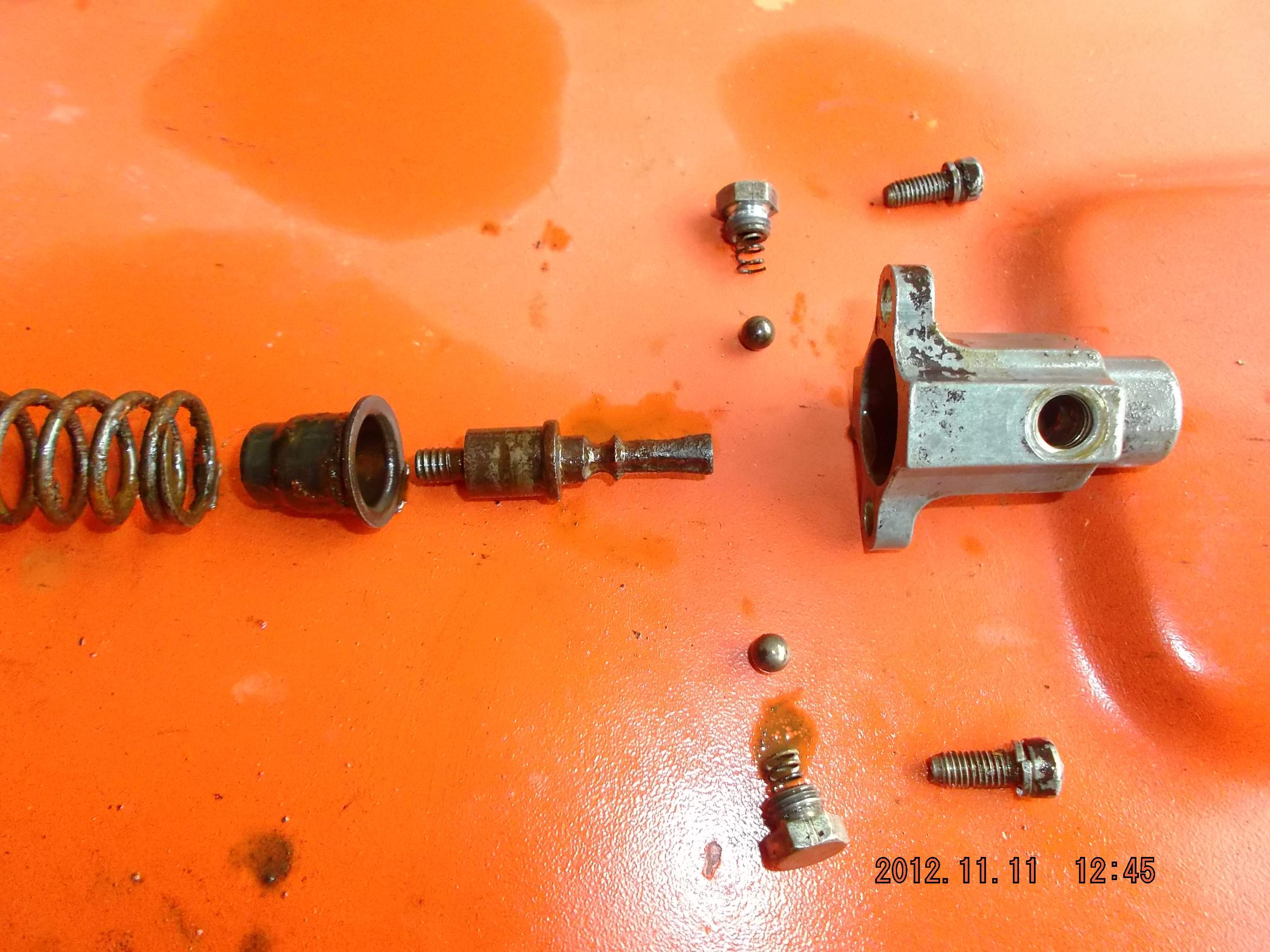

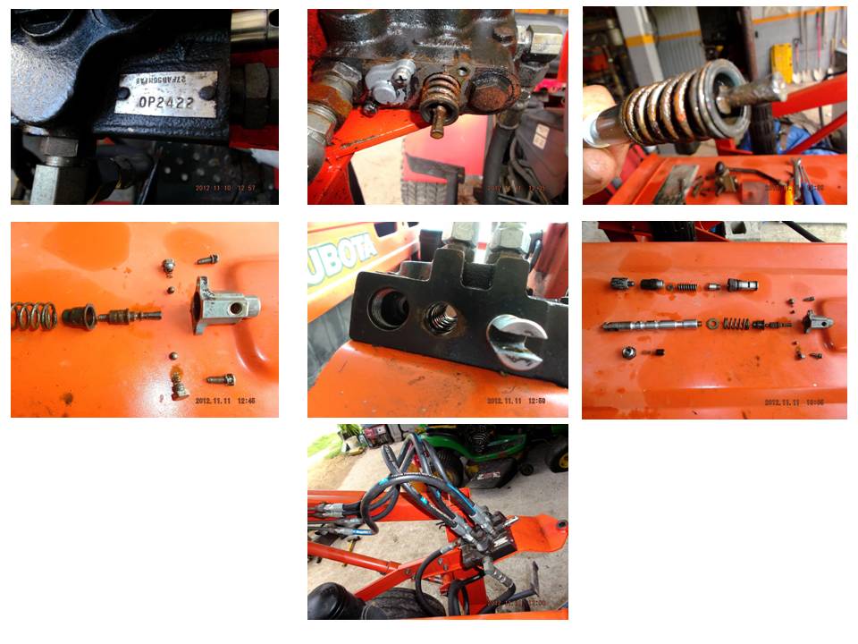

OK I got a little side tracked! I could not find any other tags showing manufacturer. I took some of it appart and here's what I found.(see attachment) There is a very worn out part at the end where 2 small ball bearings keep the actuator or spool in place. When I went to reassemble it I tightened the same tip and then losened it a quarter turn so a less worn portion would line up with the balls. After complete assembly I tried it out and the bucket no longer lifted by itself. The worn out tip on the spool was the problem! But! The loader still seemed to lift and drop way too fast and I'm thinking the problem with the pressure could be a missing "orifice". I'm guessing an orifice in the "A" or "B" side could slow the flow down some????? Also, if you look into the hole for the spool you'll notice there appears to be some O rings inside. I'm not sure if there may be one missing but without a a parts diagram for this unit I'm kinda dangling here!
   / KUBOTA 1630 loader attachment #12
You're wandering into dark territory here trying to repair that yourself
that worn spot and rusty parts may impede the stroking of the spool or not hold the spool during the "float" position or keep it engaged not spring centered.....but orifices missing is not your trouble
that oring blew out for a reason (ie: hoses hooked up wrong creating too much back-pressure in the return port)
the orings you see are just near the outside of the valve to prevent oil from getting out before it is diverted back to return tank.......technically that valve would work (other than it would puke oil all over the place) with out any orings in there, so the real trouble is getting troubleshooting done before you start yanking stuff apart
First you said it went up on it's own, now you are saying is goes down by itself (too fast?)......maybe you have cylinder troubles too
Looking at the condition of that corroded spool, you'd be better off getting a replacement valve anyways, those spools are precision fit and not a replacement part, then rule out crossed connections of hoses and/or cyl by-passing
Don't make this harder than it already is......try to find out what works and what doesn't work first

The tip screws off of the actuator for "A" and "B" that lifts and lowers the bucket. The spring and ball keep the rod cenetered The other actuator is completely different.
