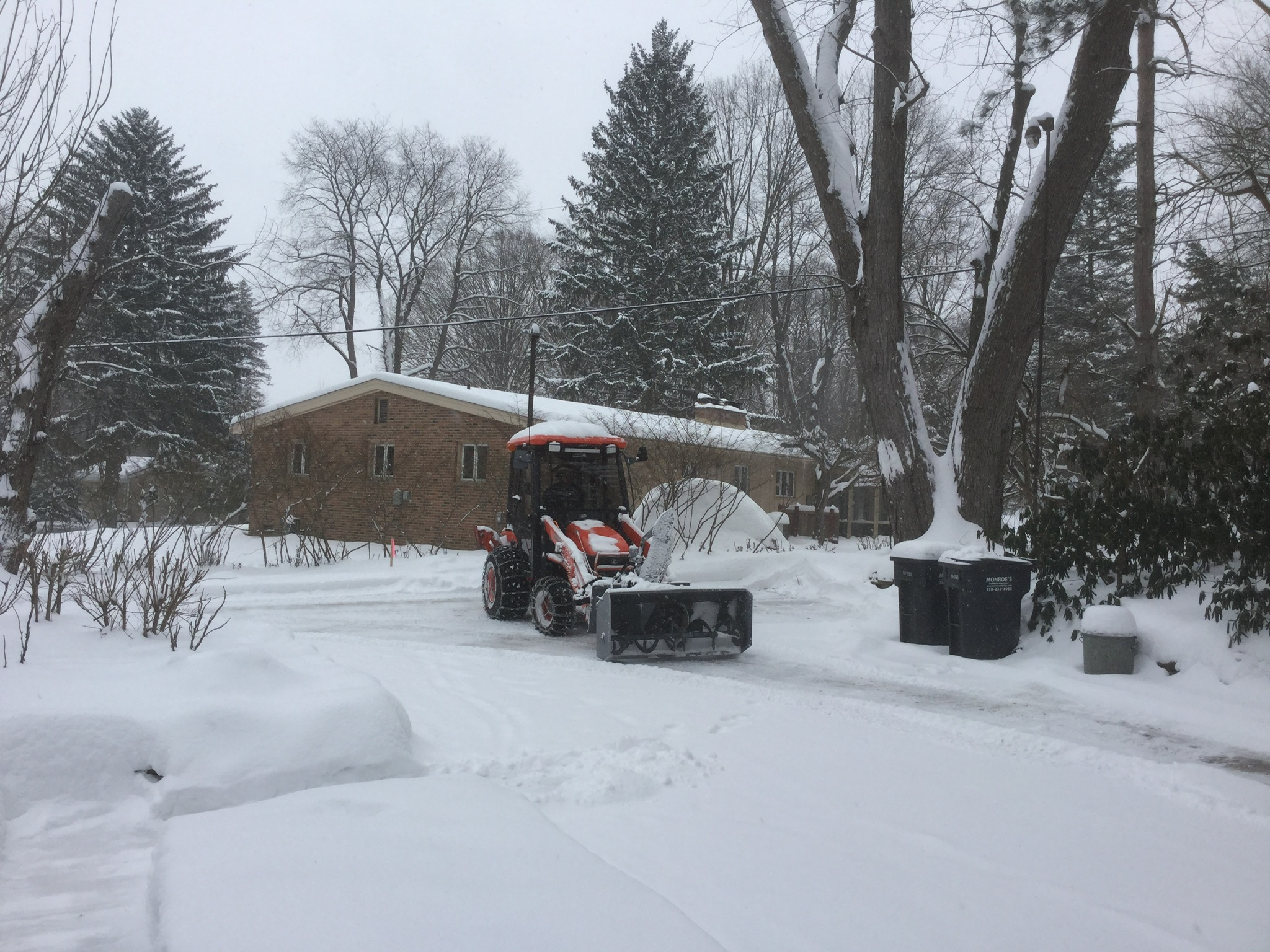

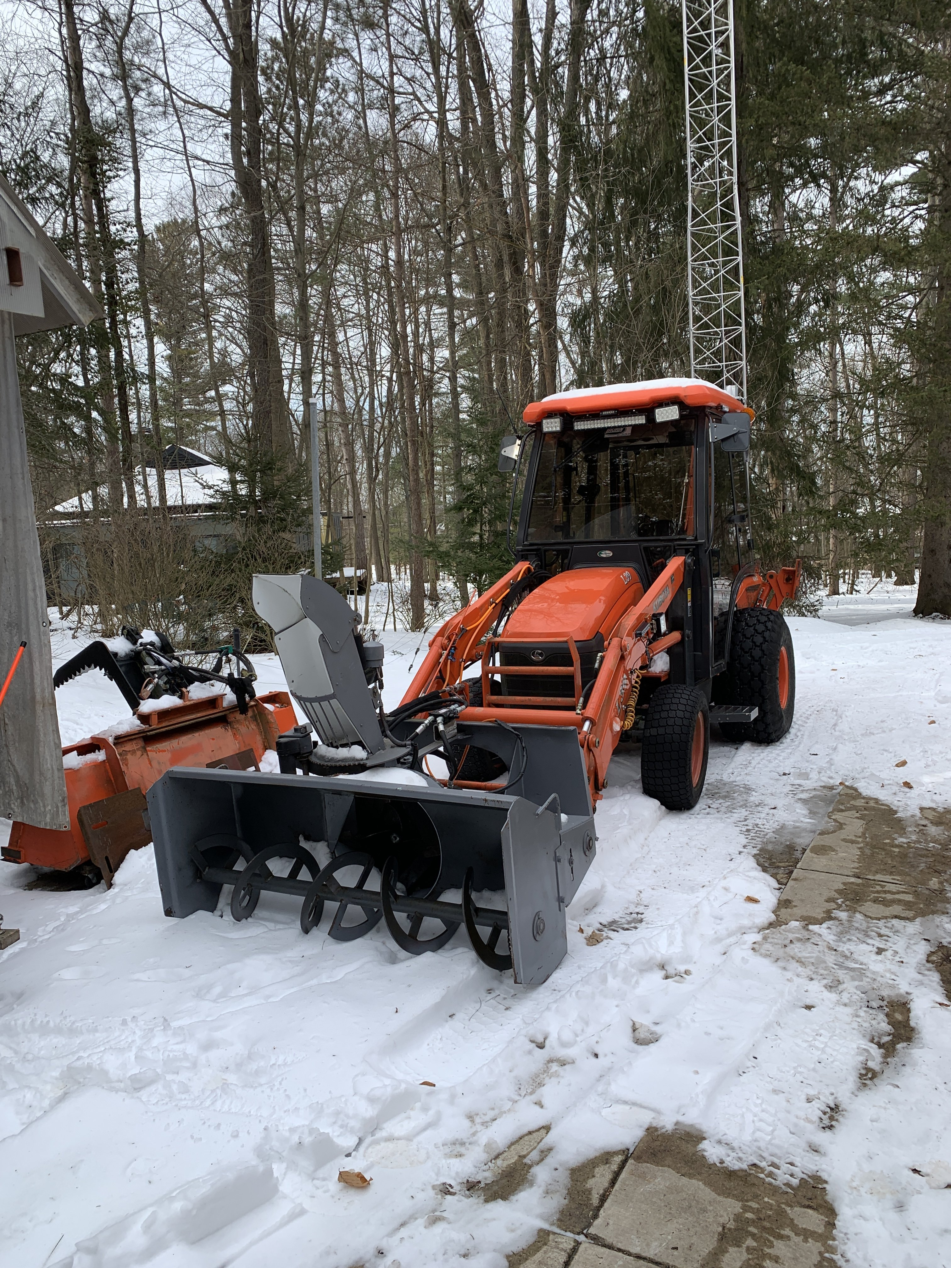

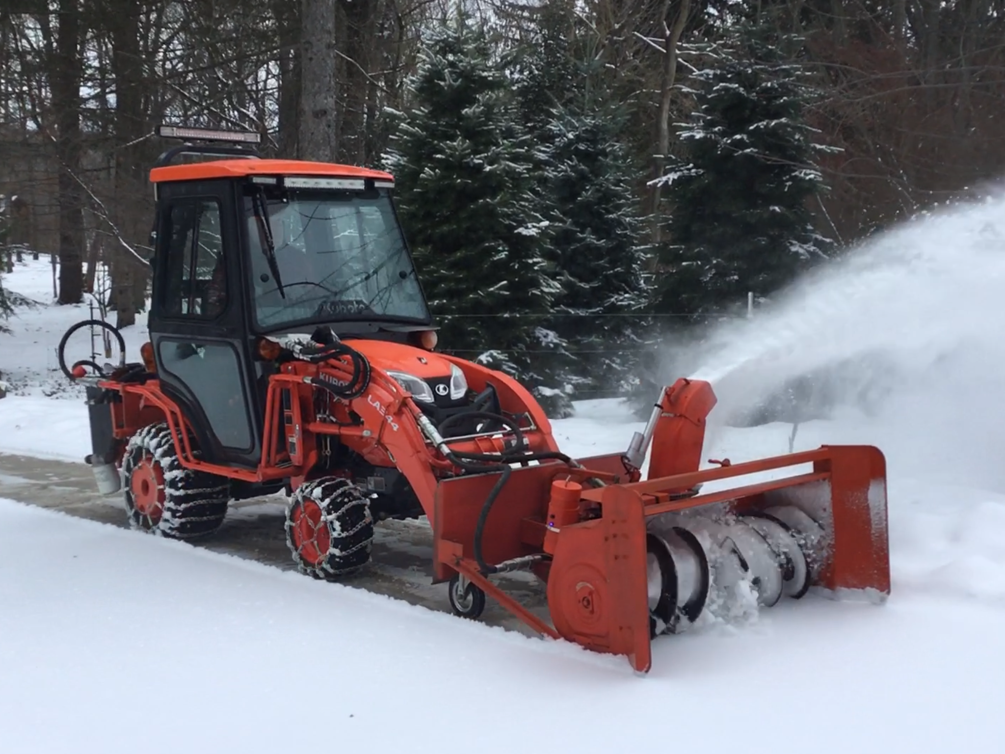

I have two tractors L39TLB and BX2680 and two hydraulic front snow blowers, commercial Loftness 60” and front mount Ariens 48” converted to hydraulic motor. I built my rear pto pump , tank, etc. First, in all setups I got good snow removal performance. I started with pump on back of L39 and hoses to front for Loftness. Didn’t like hose setup and added complexity when I added cab to L39. Rebuild Ariens 48” to use rear pump and this winter completed hard pipe to front. I don’t get a lot of snow in SE Michigan. But my rear pump will slow down my 2680 with blower load... so I slow down the feed. My rear pump is 9.9 cu in 540 rpm pump. I’ve lined my blowers with uhmw poly.... and have not had any blockages. I have concrete drive so no rocks, although gravel road and I clear that partly. I have a pressure gauge on pump and watch with varying snow load. Max pressure has been under 1000 psi . Full pressure and flow from pump takes 30 hp.. BX is like 19hp. But I vary my tractor rpm and generally do not run at full 540 pto / volume to motor 3.3 cu in.
On L39,, I changed motor from 4.9 in to 3.9 cu in and now run that off my front aux hydraulic tap. Blows fine, but rig is big and with backhoe on, hard on nearby garage doors or anything else I do not see until too late. So I like the smaller rig, but it is still longer than mechanical setup. I should add, both blowers have electric shute controls. L39- hard wired with plugs and BX has wireless key fob.
First pic is BX , then L39
