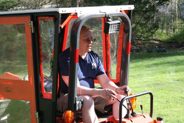

Check this out. It's a soft sided Curtis on a BX 2200 using a Woods BH600 back hoe. Just remove the rear canvas for the summer. The cab sure is nice in the winter during a snow / sleet storm!:cool: Don't forget to get the optional heater and windshield wiper!:D

I take my Sims cab off in the summer, takes about 15 min to undo the bolts and lift it off. I have a hoist in the garage to lift it off. I had a jig made up to lift the cab off at the 4 corners of the cab. An easy 1 person operation. I will be puttng it back on in a few weeks for winter, if you need pictures let me know. WINTER IS A COMING:mad:
