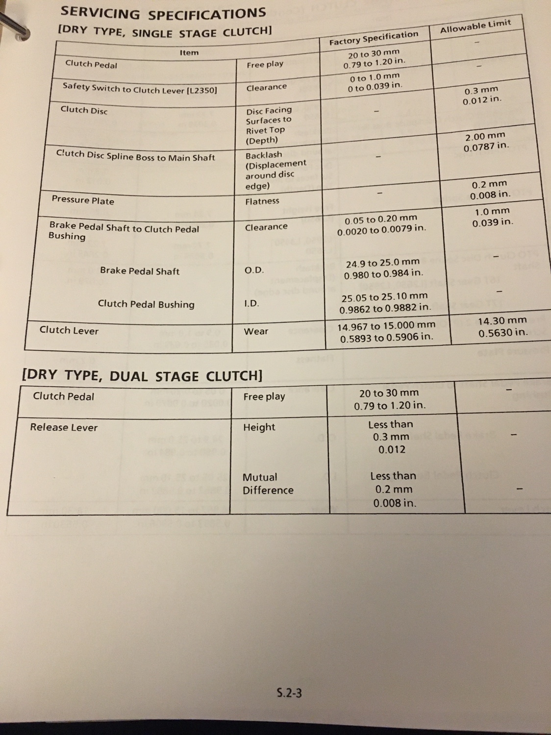

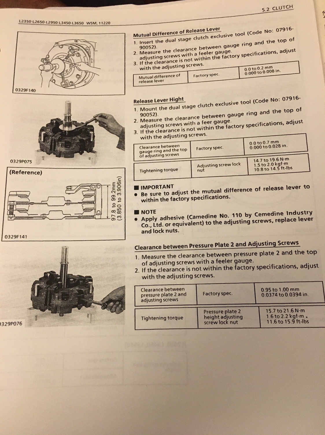

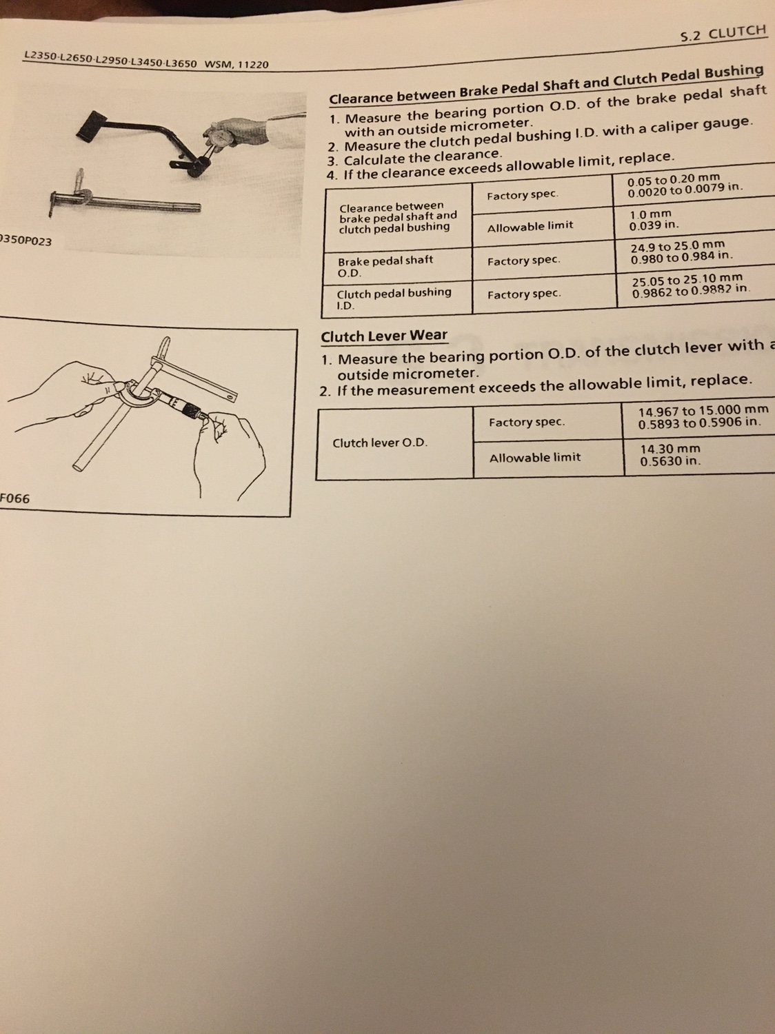

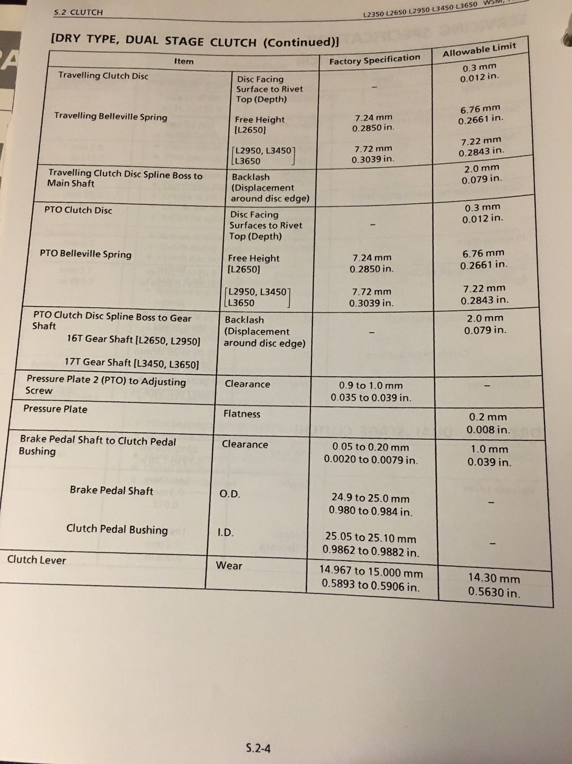

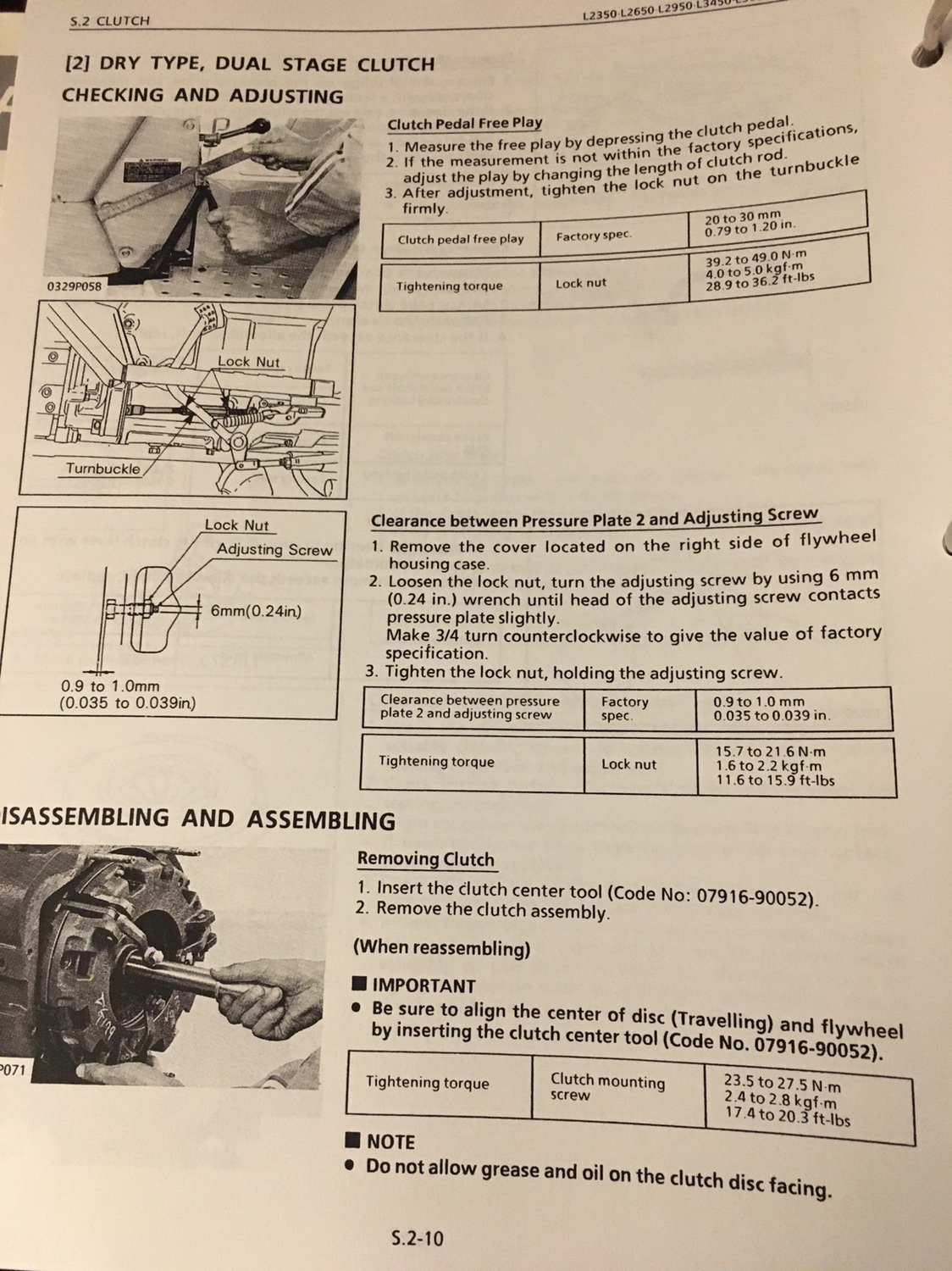

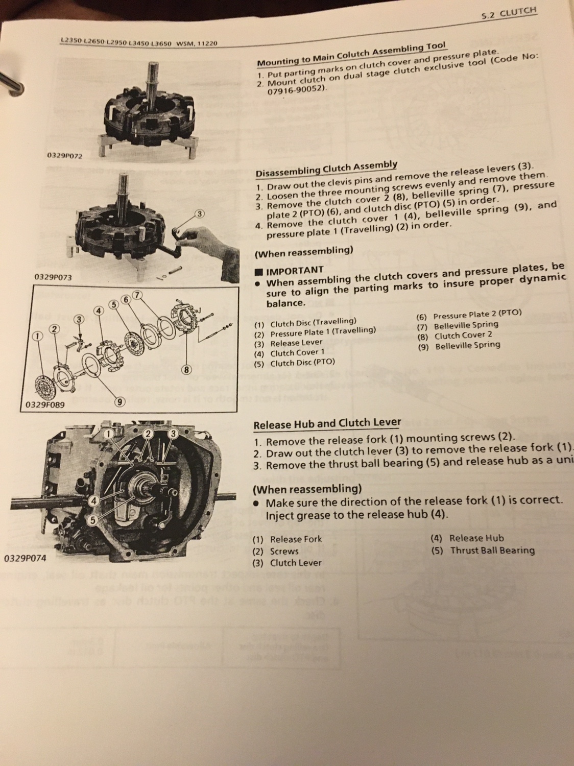

Excellent! Thank you for posting those shop manual pages. On your tractor, can you see that cover plate were the 2 stage clutch can be adjusted? I cant on mine w/o removing some massive parts of the Woods loader that is on my tractor. Getting there is surely worth the gamble as a last resort. -- But a 1st resort of finding somebody who has a L3450 where that cover plate is right out in the open and could open it and take a look in would be great. Can you/anybody see the throwout bearing through there?

The bearing definitely has clearance with the clutch out. The audible freewheel coast to a stop is really just the happenstance indicating the adequate clearance and the sound the dryness. Yeah, If there was only a grease fitting. The shop manual linked by Alan W. refers to "change or lubricate" a noisey bearing. No info I see on lubing it. MAYBE theres some way apparent behind that cover. Kubota would probably not provide an external grease point. ... Youve heard? "If a littles good a lot is better, and too much is just right." :eek:Doesnt work near a dry clutch!
