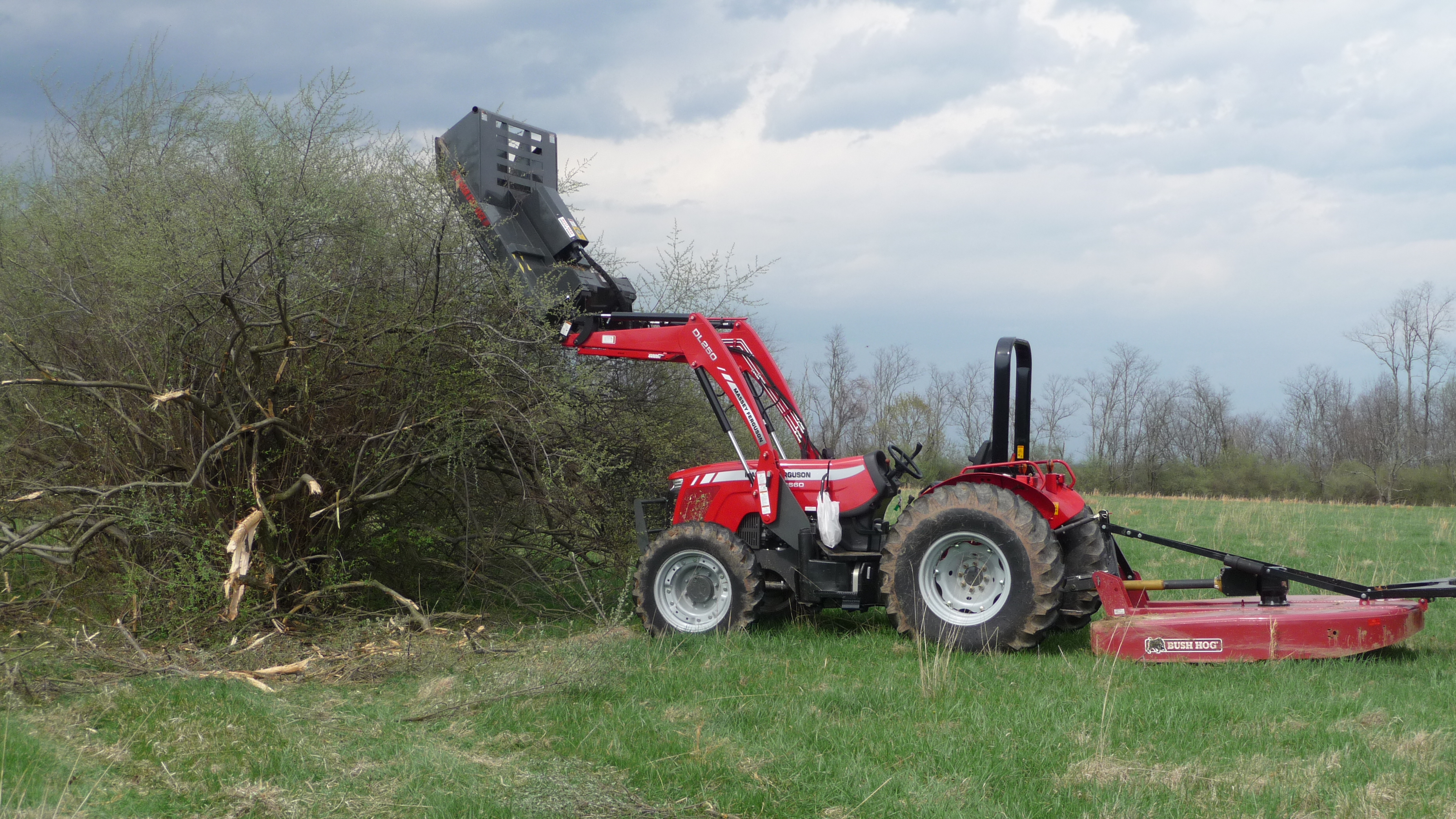

Yes, I do not have a closed center system. And it may have always been that way but there are many who do not understand everything about what they are operating, like me. Also a wide variety of configurations of course. Somewhat off of the original post, but a couple of years back I was running a 5ft rotary brush cutter (more typically used with a skid steer) mounted on the FEL of a MF2660 tractor. A dealer had sold me the entire rig, plumbed it for me, and saying that, on paper, I had adequate hydraulic flow, etc. The hyd motor for the cutter was run off the 3rd ftn lines going up to the loader (which I normally use for a pinch bucket.) It came as a surprise to him and nasty shock to me that any lifting of the FEL or curling or dumping (other than gravity assisted moments) shut off the hydraulic motor driving the cutter momentarily and then turned it back on with a bad jerk after you stop moving the loader. That created a lot of unwanted stops and starts of the rotary cutter, needless wear and tear, etc. I might have gone to serious lengths with flow control valves, etc. except for the fact that the tractor really did not provide the flow needed to run the cutter without nuisance clogging when cutting brush. Other things I use like a hydraulic top link are so intermittent / rarely actuated that they did not matter. P1160623.JPG
End result was I traded the cutter off on a rear mounted boom cutter with 2 of it's own pumps and totally independent of tractor hydraulic pumps.
