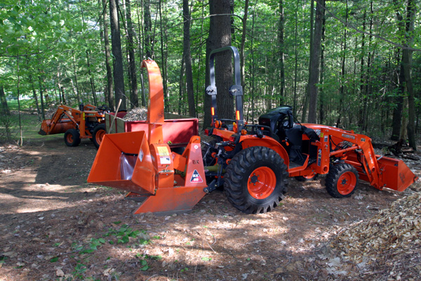

I have a B3030 that I use with a 6 " chipper. It handles 4 to 5 inch softwoods. Hardwood limbs are not a problem. I don't tend to chip the hardwood ... burn it. Decaying punky wood is tough to feed without jambing.
I use the B3030 to care for 6.5 acres. The only other Kubota machine I considered was the L39. I chose the B3030 based on size to get around in the woods.
I'm sure you will enjoy either machine
D

What kind of Chipper are you using and if you don't mind asking what did you pay for it?? Any problems with it and how do you like it. I am in the market for one and still collecting info on them. Thanks.

The 6 inch Wallenstein weighs approx. 630 lbs. I have never had the chipper on without the loader. The tractor has no problems with this chipper.
