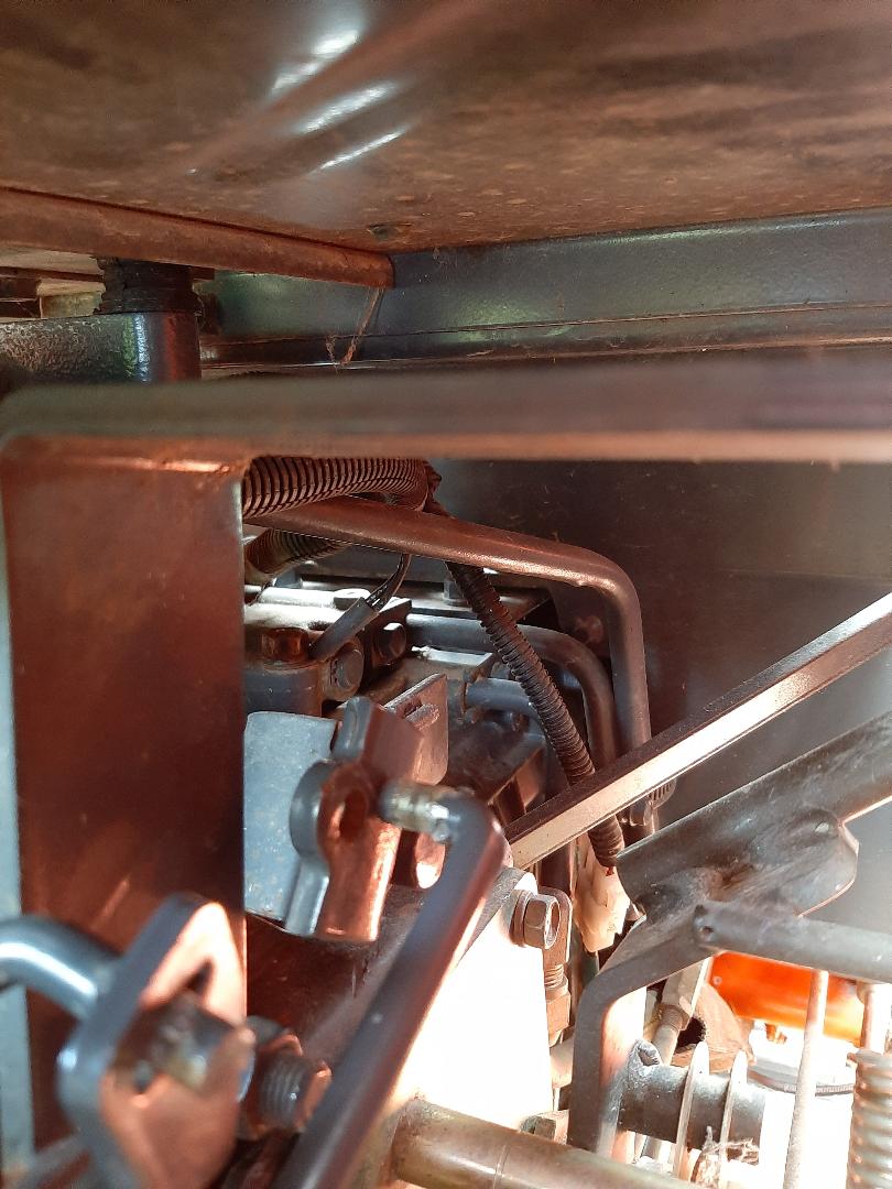

Started poking around underneath and found this part disconnected. What does it do? Is it part of the 3ph linkage? tractor linkage.jpg

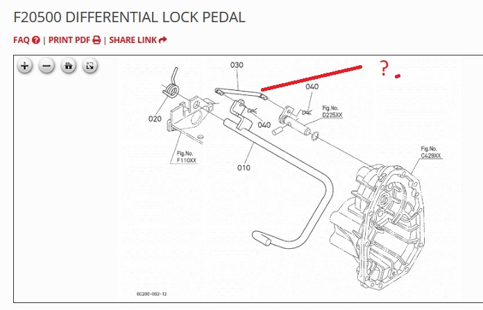

My first thought is that it is the differential lock mechanism.
Hard to tell from your photo.

   / Kubota B-3030 3pt won't lift #14
Dave M7040
Dave, thanks for the response. Presuming you are correct, how do I get it back into the hole? Or do I leave it alone?
   / Kubota B-3030 3pt won't lift #15
It should go back into the hole. If it is the diff lock linkages, pressing the pedal on the tractor floor should produce some movement first confirming my guess is correct and second allowing you to align the rod with the piece with the hole.
Dave M7040
   / Kubota B-3030 3pt won't lift #16
Dave M7040
Dave, you were correct, pressing the pedal moves that part. I think I've got the rod aligned with the hole, but it doesn't just move in. How hard should I work to get it back into the hole? Any recommended tool or process?

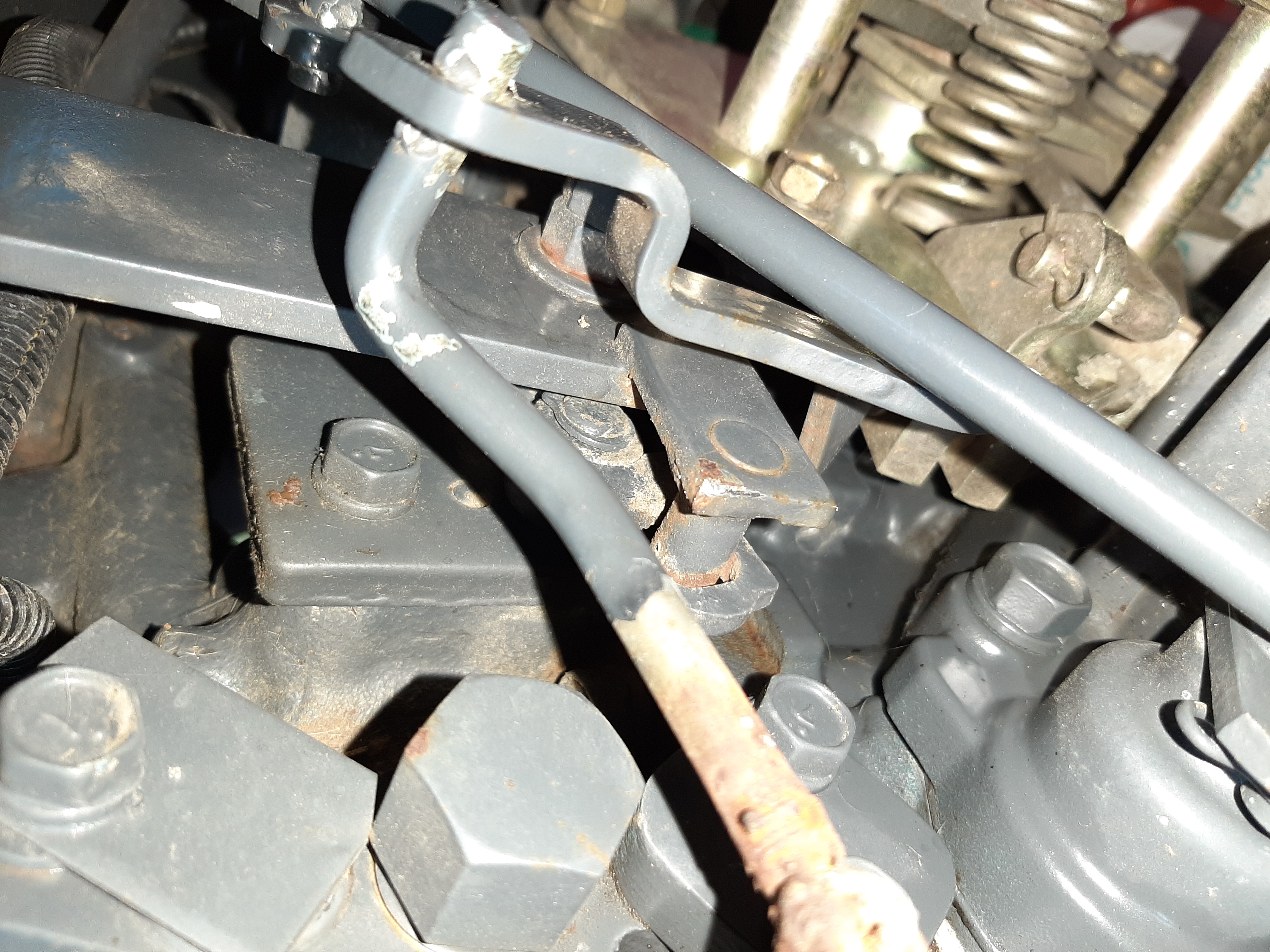

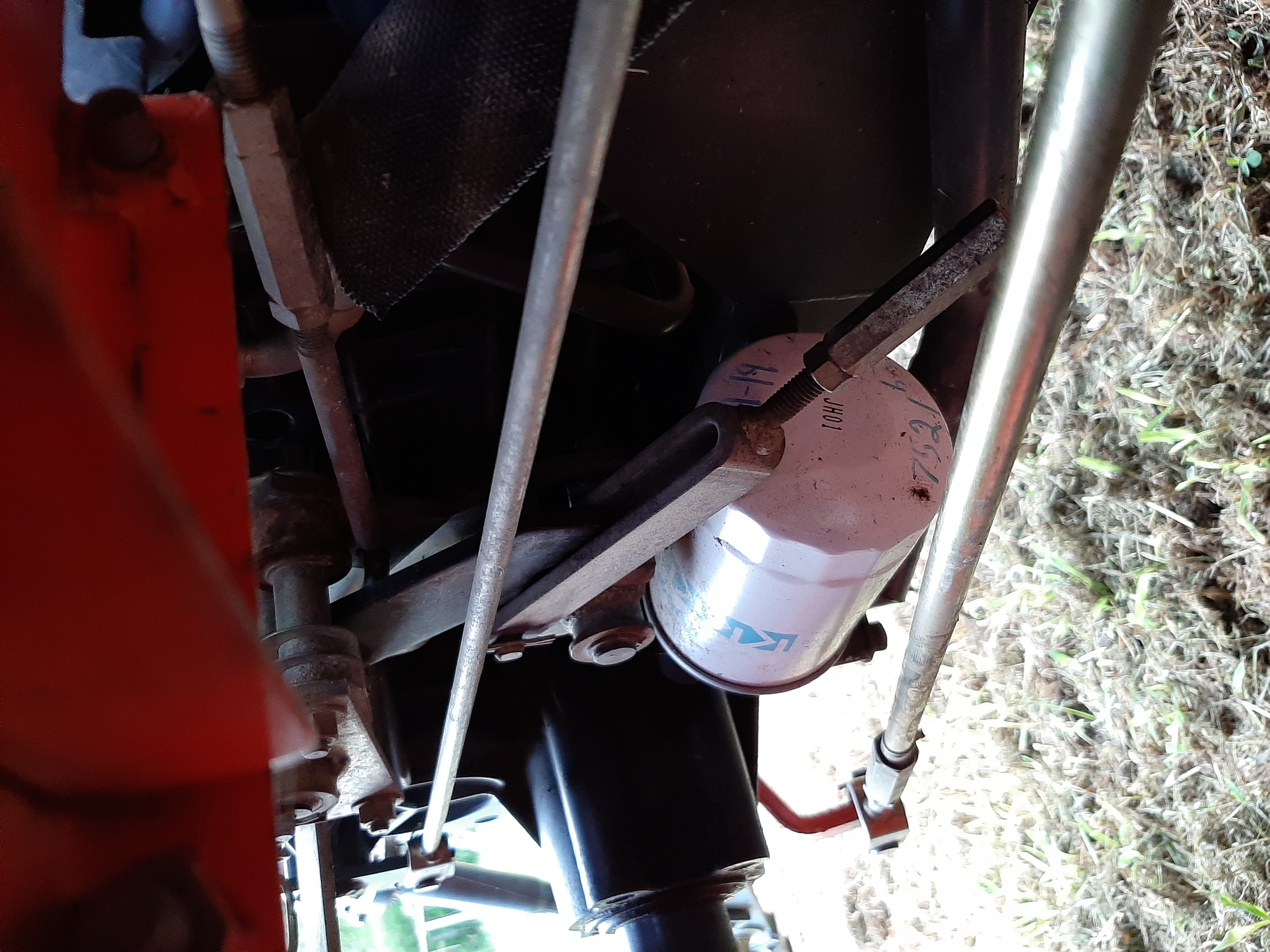

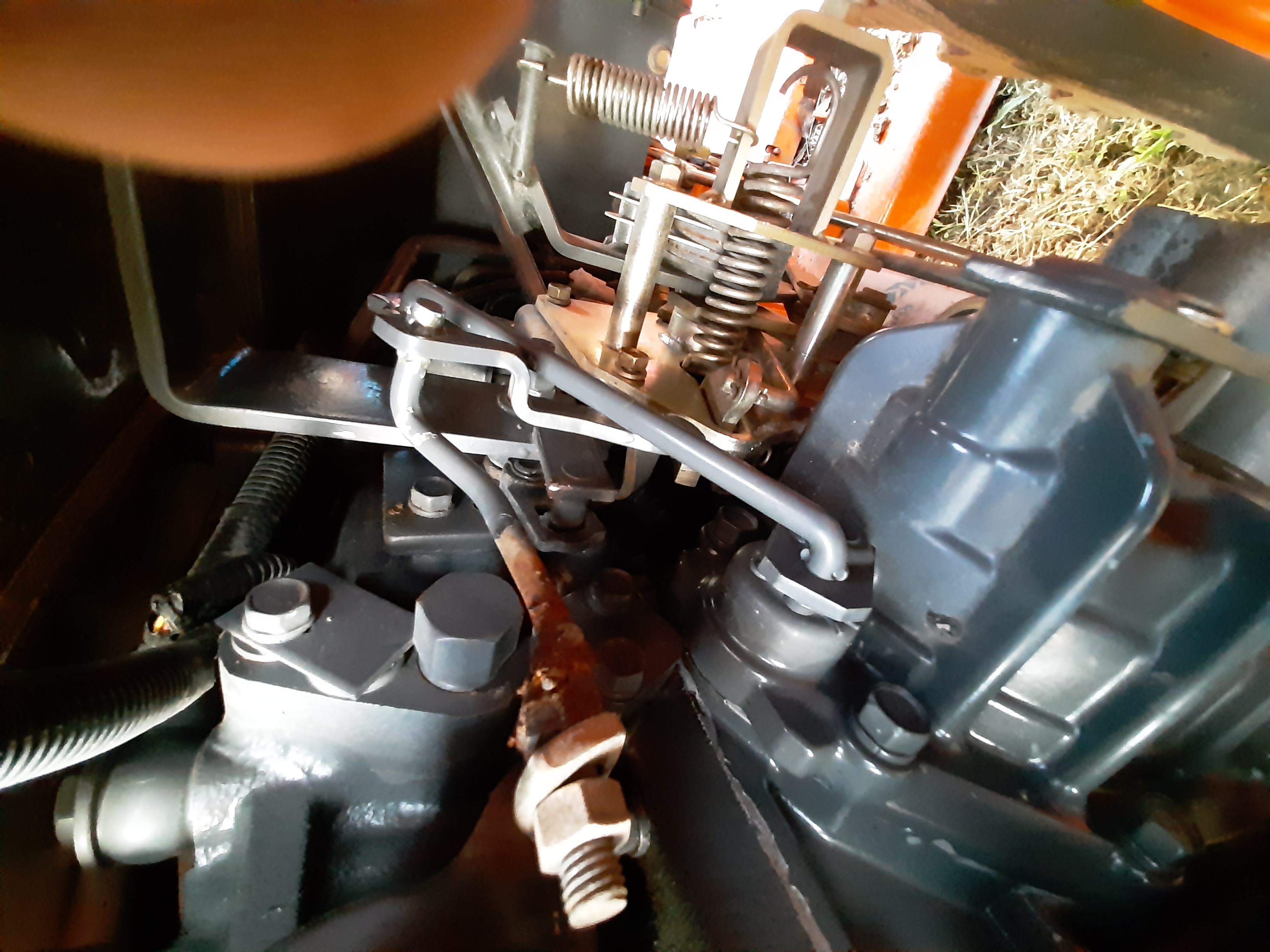

Thanks to some great help, got one piece figured out, but 3pt still won't lift. I've checked the fluids level, just to be sure. A few more pictures of the linkages that seem to either part of this or that could be, including one that is not connected to anything. If it's the pressure relief valve sticking open, where's the valve? Full disclosure, I wasn't having problems until I stuck the front wheels down to the axle in mud. Any suggestions would be greatly appreciated. If you need more information from me, I'm pleased to provide. Just another newbie trying to learn.

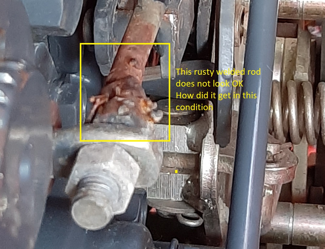

Look at your photo I marked up. Clearly someone has done poor major surgery on the controls in the past.
In your last photo there is an adjustment device with one end with nothing screwed into it. The other half has possibly fallen out and then unscrewed to not be present.
Take a couple of photos a bit further back so it is possible to see more of the rear end to help discern what is what.
What model of B3030 do you have?
Dave M7040
