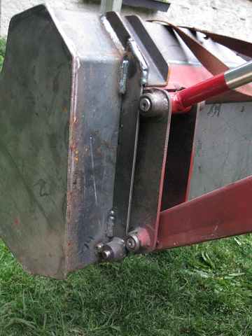

Phil,
I like your quick hitch design. Is there more pics.

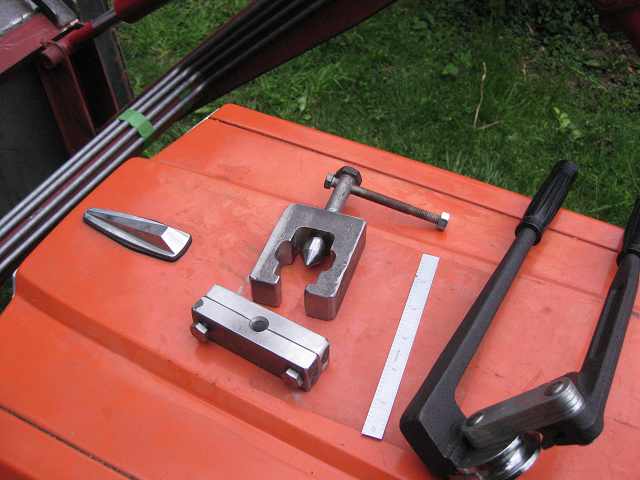

Sorry for the delay, was stumped for a while on what size of fittings to use on the hydraulics. I ended up making the quick release for a 1/2"pin instead of 3/4. Will make up some hardened pins for that. Started bending up the 3/8 line today, need to add the fittings and flare the ends yet. Also make some blocks to hold the line in place. One of the pics shows a 37 degree flaring tool I made up last night. Seems to work well.

Wow Phil, I'm sure impressed with the quality of design and outstanding craftsmanship. Makes my projects seem wimpy by comparison. Keep up the good work and posting pictures of your progress.
Larry
