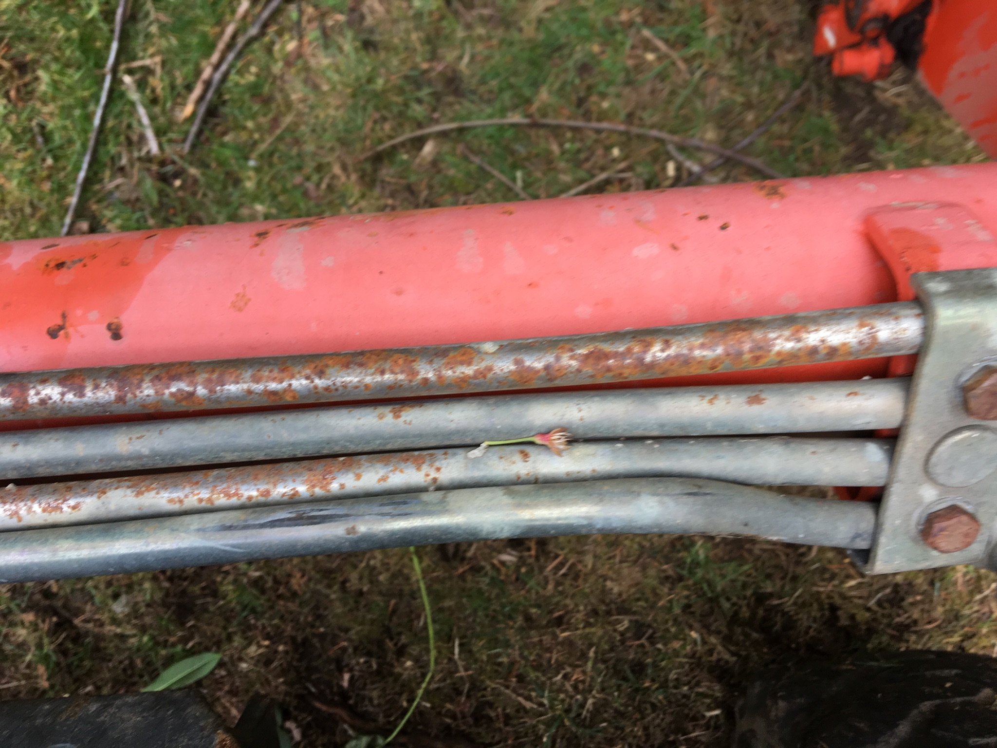

I finally got to the NAPA store to have some hoses made up. OReillys locally does not do hoses. Question after I get new hoses. The original owner was hard on the hard lines on the old girl. Can they be straightened or would there be too much fatigue?
   / Kubota B21 Hydraulic Hose Replacement #20
Those hard lines are not easy to straighten. Unless you have good equipment for bending tubing you are almost certain to create weak spots (as you say fatigue places) in the metal which will eventually cause problems. It may not be pretty but leaving them alone is the best option. To my pocket book they are too expensive to wholesale replace all of them. Maybe sand off the rust would be good.
Your paint is not so good either, etc. If you decide to spend money for restoration and appearance, do the new hard lines when you do the paint job.
