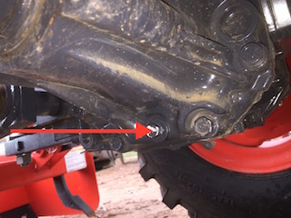

I have a Kubota B2320 HSD that I purchased in December 2014. I have been searching how to change the hydrostatic/transmission fluid and I have not been able to find anything showing how to perform this service. My tractor just hit the 50-hour mark and I decided to complete this service myself. As I did this, I documented what I did. Hopefully this will help someone else.

The manual shows three drain plugs for the hydraulic/transmission fluid but there are four drain plugs. The two drain plugs on the rear axle that the manual shows are incorrect.
Following are the four drain plugs.
First one is near the PTO underneath the tractor. Photo 1.

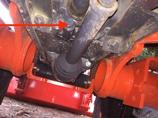

Second drain plug is on the right rear axle. Photo 2.

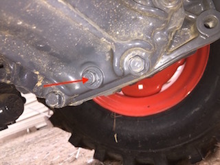

Third is on the left rear axle. Photo 3.
