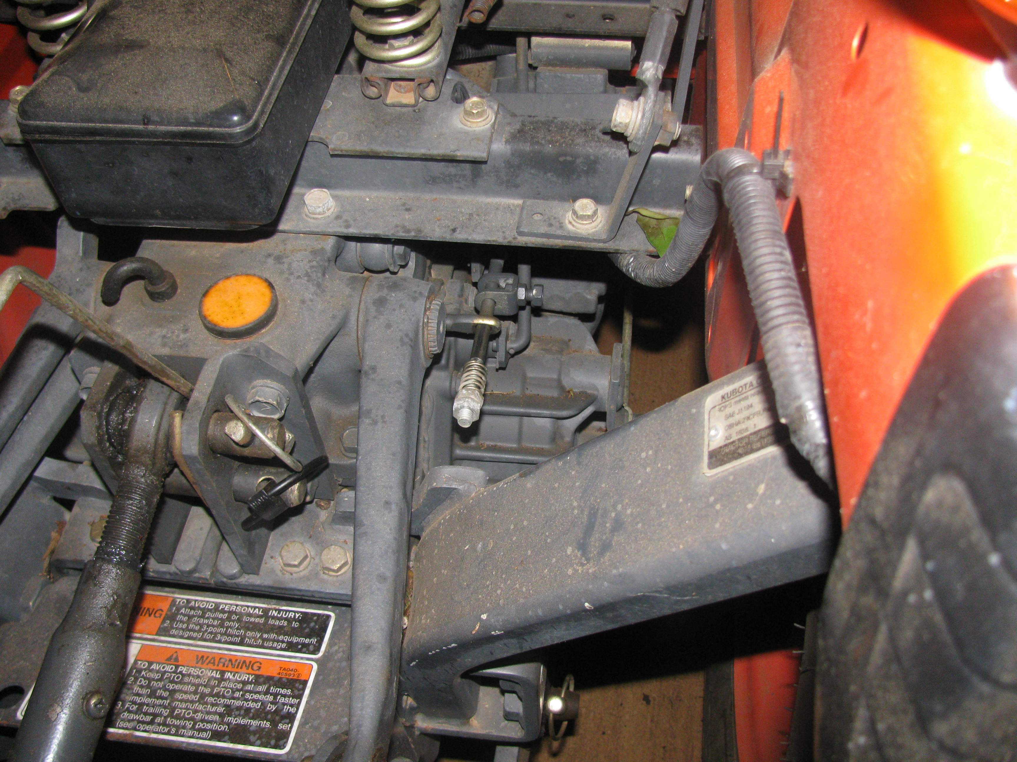

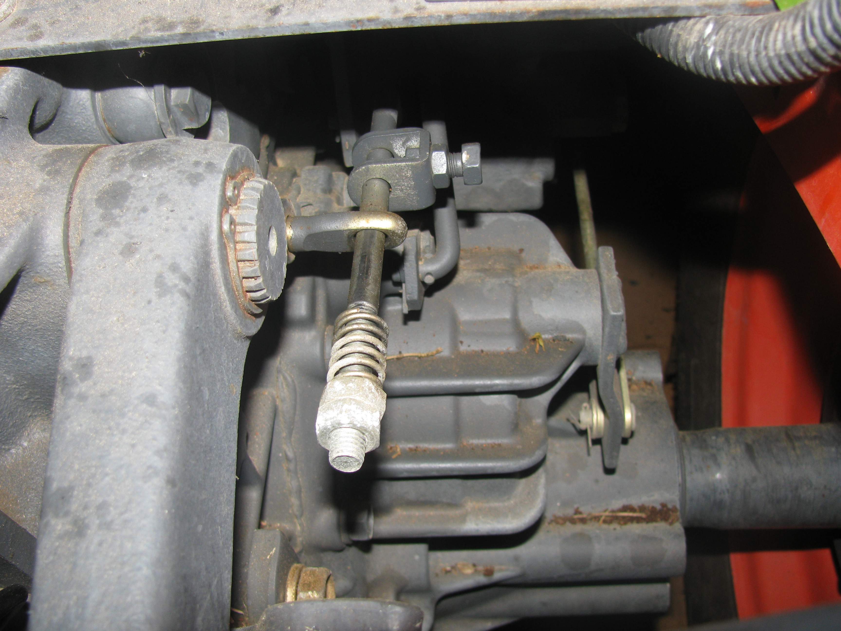

   / Kubota B2320 TPH hard to lower #3
My 3 pt on the tractor has been a little jerky since I got it (B2920). It had 112 hrs on it when I bought it. This past weekend I sprayed some liquid wrench on the feed back lever where it passes through the feed back pin. It seemed to be binding. The 3 pt is smooth as silk now. If you are saying what....feed back pin????? Go to Kubota.com/Parts/Illustrated Parts List/accept terms and conditions/search B2320 then click on Hydraulic System then click on Feed Back Lever. Then you should be looking at a schematic that shows what is what. Feedback pin is 120. If I were home I would just post you a picture. It's worth a shot. Let us know if it helps.

   / Kubota B2320 TPH hard to lower #5
Here are some pictures from my B2920. Before I get back on it I will put a little grease on the feed back lever. The liquid wrench doesn't last very long.
McRebel & GPintheMitten: thanks for the feedback & help, I thought something major was wrong. I sprayed it with liquid wrench late last night when I got home and tried it. I also tried it again this morning before leaving for work. It works smooth as silk now. I agree with using grease instead for longer lasting. I will add this to my routine for PM greasing. Thanks again for the feedback! Maybe Kubota should add a grease fitting there....
