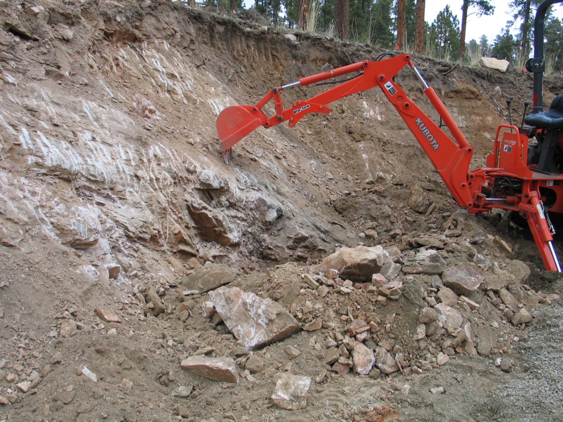

The L35 is a good machine. I've used one on my property, but it would have taken me a little more time to get smoother with the GST on my mountain property. A used L35 nowadays will most likely have a lot of hours and seen a lot of hard use.
One thing to consider with the B26 is your elevation. I assume you're not anywhere near as high above sea level as I am? I'm at 8500'. The B26 would not have a good enough power to weight ratio as high up as I am, so that took it off my short list. Another thing about the B26 is if you're only using it mainly for your own property, and not in a commercial setting, you'll never wear it out. One of the large B series or the L series should handle your property well enough. I was very pleasantly surprised with how well my non-commercial B3030 TLB handled all of the tasks I threw at it, and I have a lot of decomposed granite and rocks to deal with.
Here are some pics showing some of the work my BH75 did on a rock ledge hillside that I needed to dig out. I started with a full size TLB, but found that the bucket alone couldn't chip away any faster than my little machine could, as I couldn't utilize the significantly larger bucket when breaking up the rock ledge.
These little machines are pretty amazing. Don't think you'll be unhappy with whatever you decide on.
