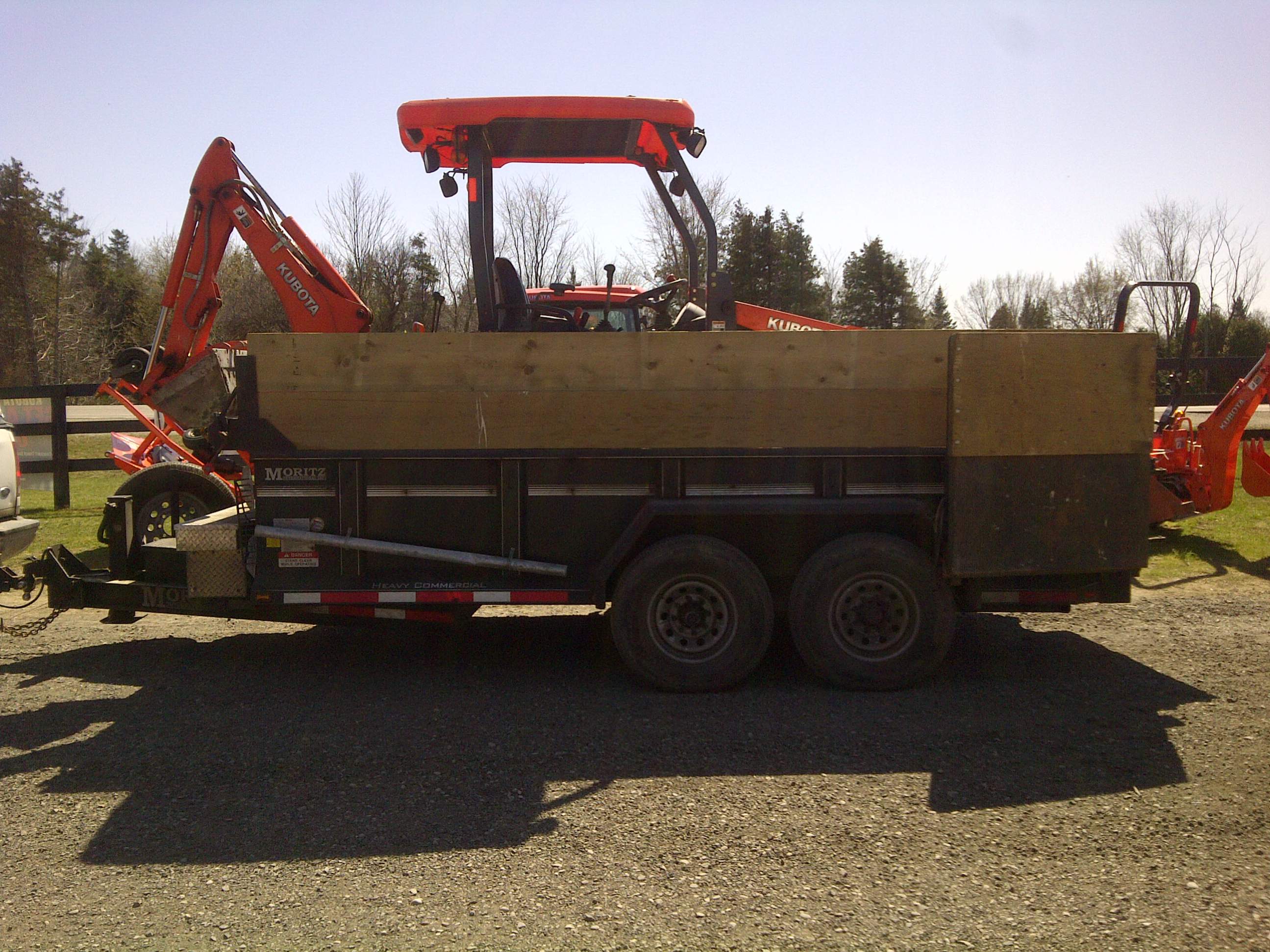

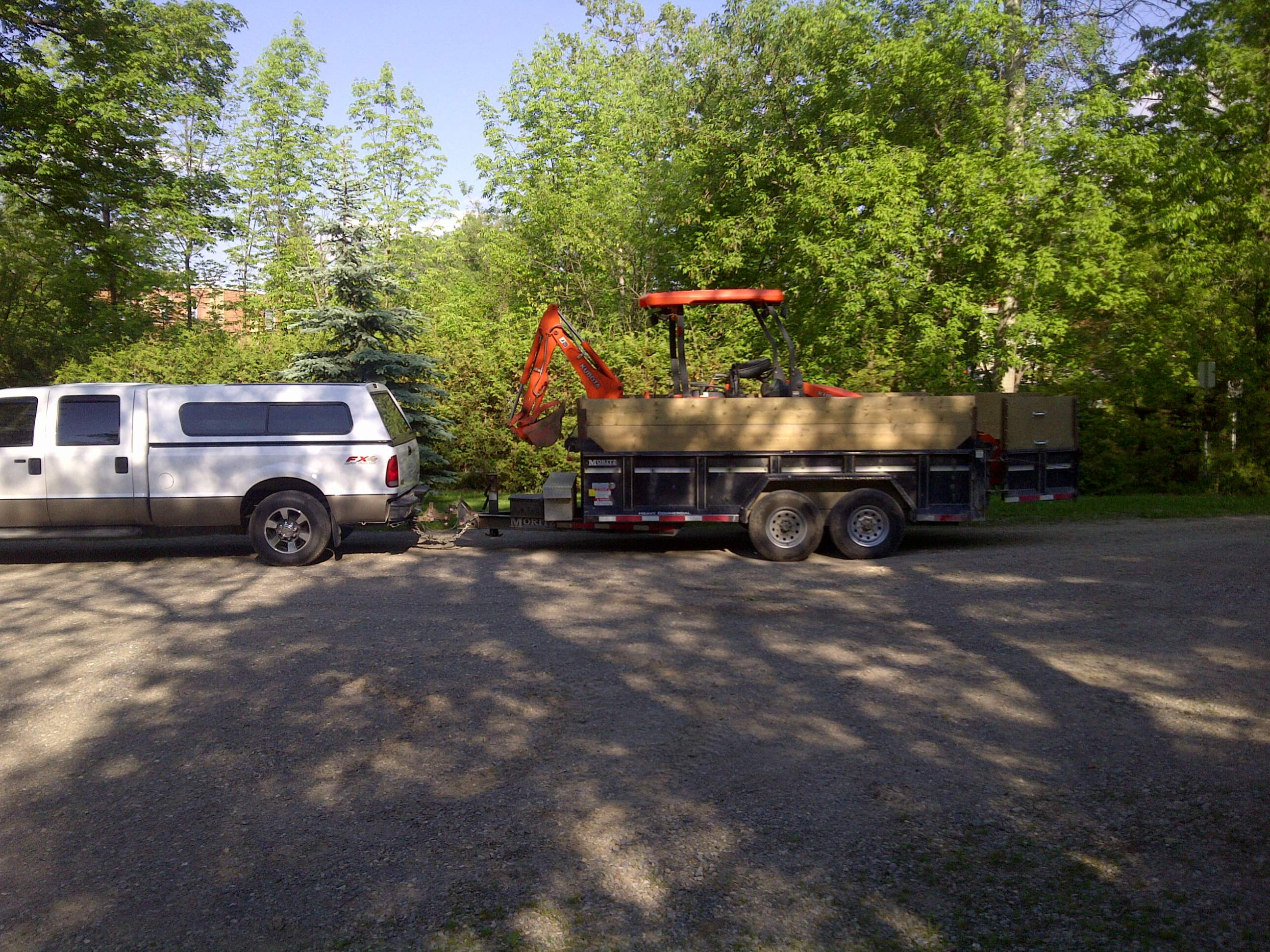

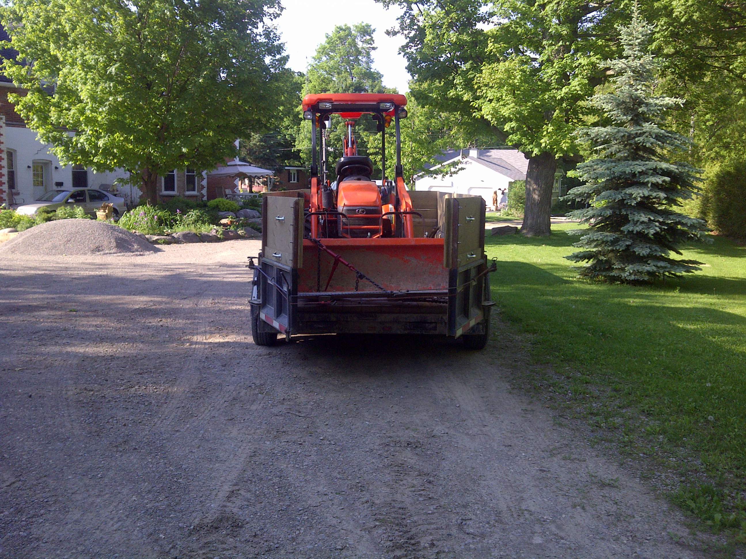

Hi Wade M
Here are a couple of photos of my former B26 in my 7' x 14' Moritz dumping trailer. In the end shot you can see that I have chained my 4in1 bucket to my forks as I always like to have my forks with me. For me I found that I did not like driving the B26 on as you have to put the bucket over the front of the trailer in order to counter the weight of the hoe on the back. It worked much better for me to back in and have the hoe overhang the tongue. As you can see the doors don't quite close so I just put a couple of bungees on them to keep them from swinging. Since I do not overhang the back of the trailer by 5 feet or more I did not require a red flag.

Hi Wade M

Thanks for taking the time to post these pics. I'll probably take the FEL bucket off to be able to close the doors.

   / Kubota B26 yes or no? #28
Hi Wade
I'm not sure where you will put the bucket as I don't know if there is enough room between the front tires and the closed doors. It might work and you could let the loader arms sit on the bucket I guess. The FEL bucket definitely won't fit behind the B26 as the backhoe boom is touching the front of the trailer in my photos.
I forgot to mention that I also chain the bucket or the forks so they can't sag as the hydraulics bleed down. I have a centre hook on my FEL bucket so I wrap a chain around it and the cross beam on the loader arms to keep it from leaking down.
