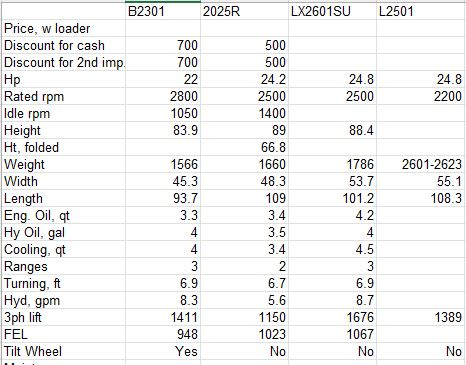

doesn't the deer lift more than the bota ?
No. Kubotas have far more hydraulic flow and lift at both ends. Here's a recent comparison. No contest at all. There are videos that show this as well.
seems like I saw a Tim the tractor guy compare a Kubota and a deere of equal size and the deere lifted more than the kubota.
He was comparing the B series with the equal deere model

The specs are published and available. There is no need to speculate.

I wasn't speculating . I saw the video .
You can put anything on paper. It's real life that count

That’s a Kubota BX tractor vs a John Deere 1 series, not the B series or 2 series the OP asked about.

That’s not relevant. Not even the same tractors we are discussing. The BX only has one lift cylinder, unlike other models.
