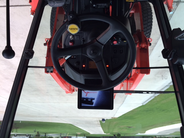

I also just upgraded to a B 2650 with cab and my first mod was a rear camera. The bracket for the safety triangle in the rear is a great place to mount the camera and the monitor is mounted at the top center of the dash. The next was to add a ballast box filled with 400 lbs of concrete. Before I poured in the concrete, on each of the inside back corners of the box I taped a 2" length of PVC that is now sealed in by concrete. These sections of PVC are now tool holders for a rake and shovel. Mu next mod will be wheel spacers for increased stability . Coming from a B 2920 open tractor I find the B2650 a little top heavy with the cab so spending the rear wheel base is a safety concern. Since the installed radio does not have bluetooth I'm going to mount a small blue tooth speaker near the top of the cab close to my head so I can hear the phone if it rings. I also added a 12 volt pigtail with a dash switch to control the electric pump on my rear mounted sprayer. So far I am very happy with the B 2650, plenty of power and the A/c great in the Texas heat

Got any pictures of your camera setup? Yes the A/C is going to be great in this east Texas/Arkansas heat!

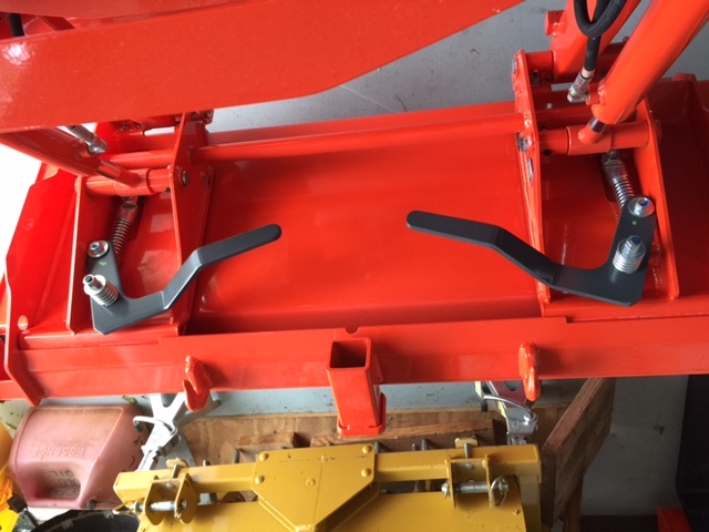

for those that asked, I will try and get some pictures this weekend of the new style 3 point set up and my camera instal. I am also going to add some wheel spacers on the rear for a slightly wider track
As for the three point changes, both arms now have pins and numerous holes for adjusting the width quickly eliminating the turnbuckles. There is a also a ratching adjustment on the right arm to fine tune adjustment . These two changes really make attaching implements much easier and quicker

Here are shots of the new style "quick attach" FEL makes it a snap to change from bucket to ballot forks. Also see the changes to the new style three point hitch

Showing rear camera mount and monitor on dash
