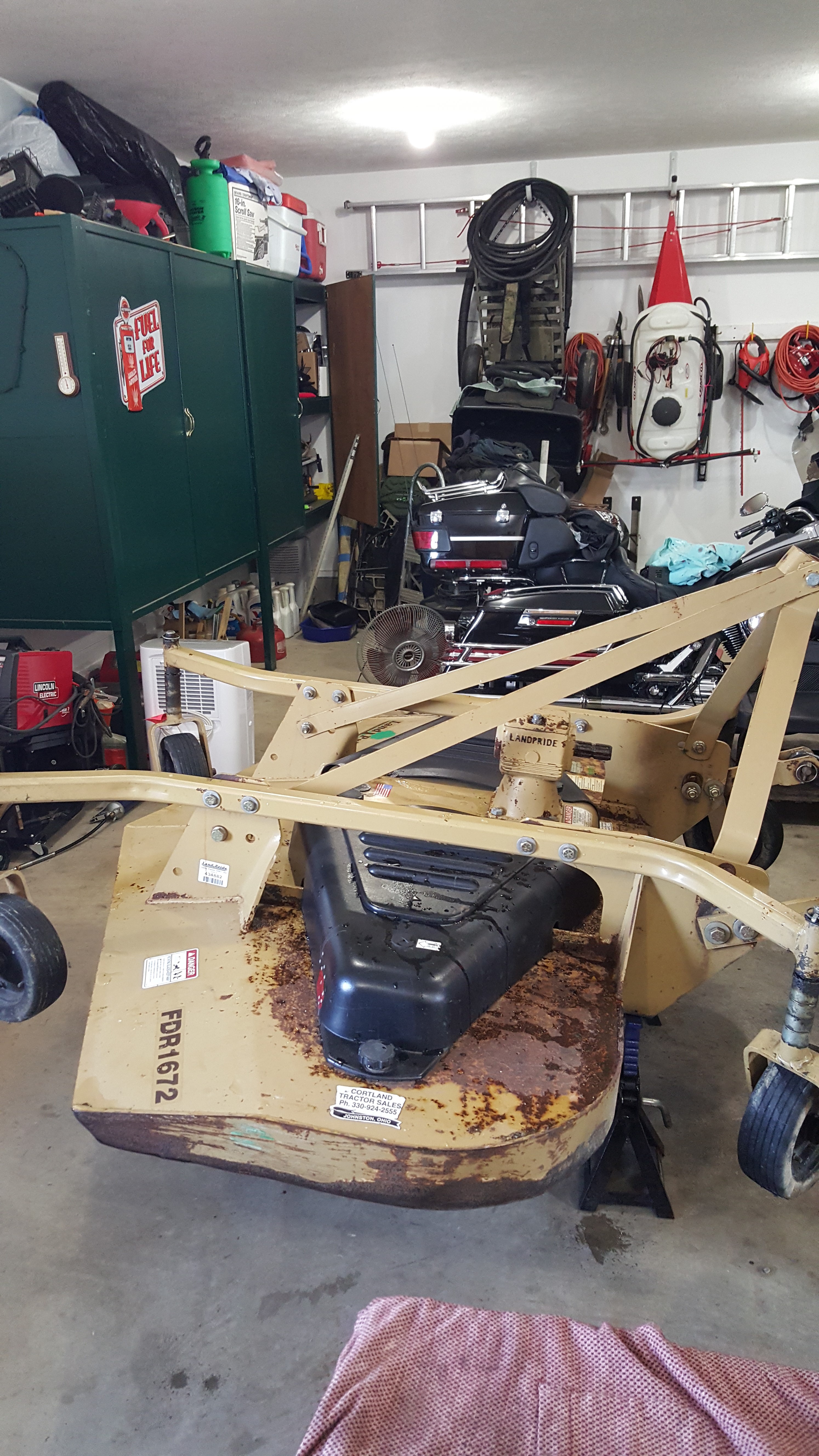

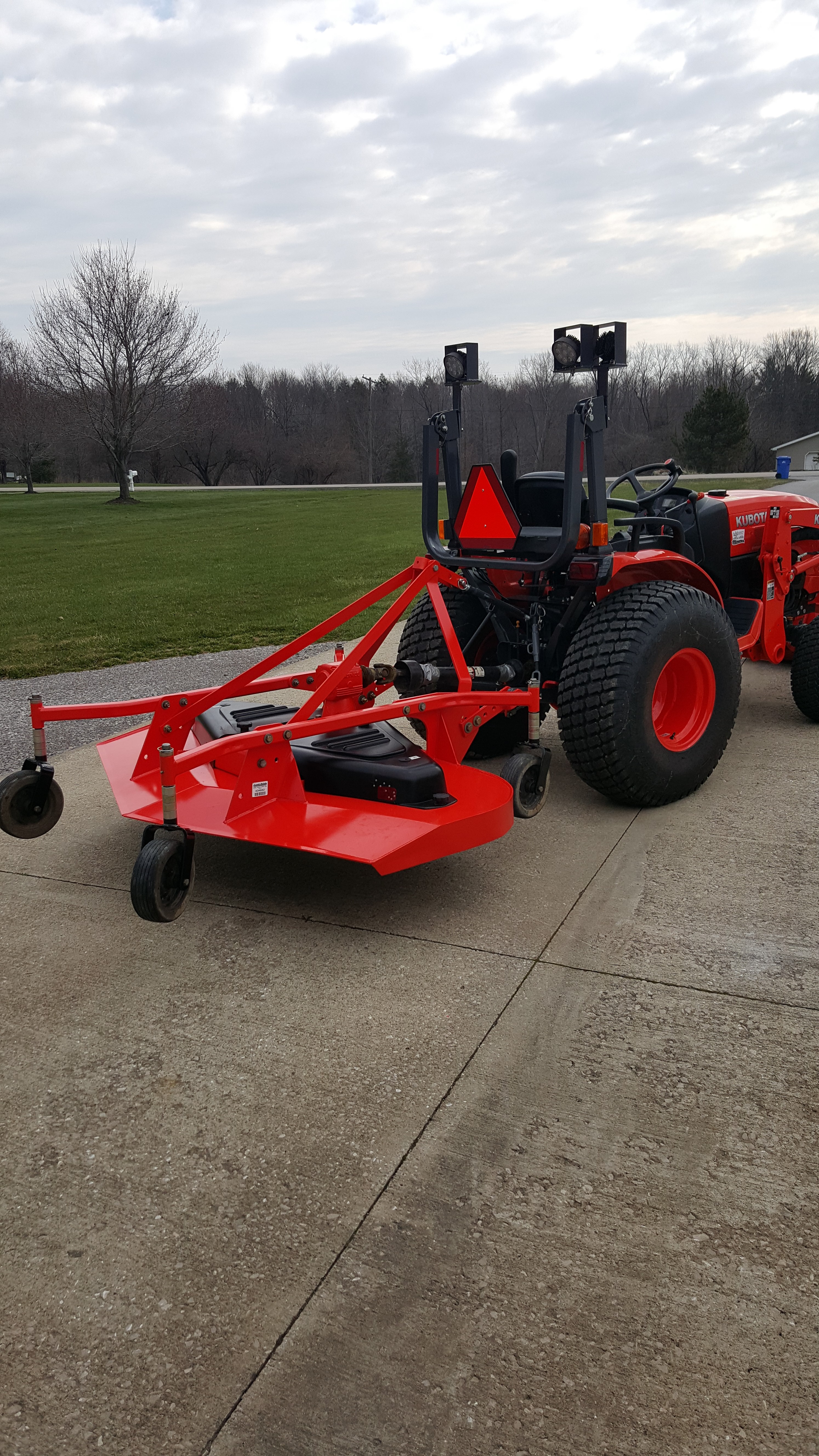

Hey Larry. That is a steal for that mower. They are over $2500.00 new for the FDR1672 that I have and that one is even heavier duty. I mow 3 acres with mine and it mows really well. I have been very happy with it. The tractor handles it no problem even if the the grass gets a little high. They are very good heavy duty quality mowers. Highly recommend them. The gear box does take 80-90 gear lube as I did change mine when I bought it used. I cant really answer about mowing the slopes you are talking, but they do ride on 4 bogey wheels, with the weight on the ground, so I cant imagine it pulling really bad down hill. Mine was the yellow also, so after I bought it I stripped completely down, went through all of the mechanical stuff, stripped off the paint, primed and repainted everything. Even put on new decals to match up nice.

Dude, that looks super awesome! Did you go to a kubota dealer to order the stickers? That's pretty much exactly what I want to do, I want it painted Kubota orange, Rust-Oleum paint the underside Kubota orange and replace the stickers. Basically, I'll do belt, blades and fluid, paint it like new and hopefully get many years of service from it cutting my 2.5 acres. I'll still cut the half acre around the house with a garden tractor, to many steep angles and obstacles for a small farm tractor.

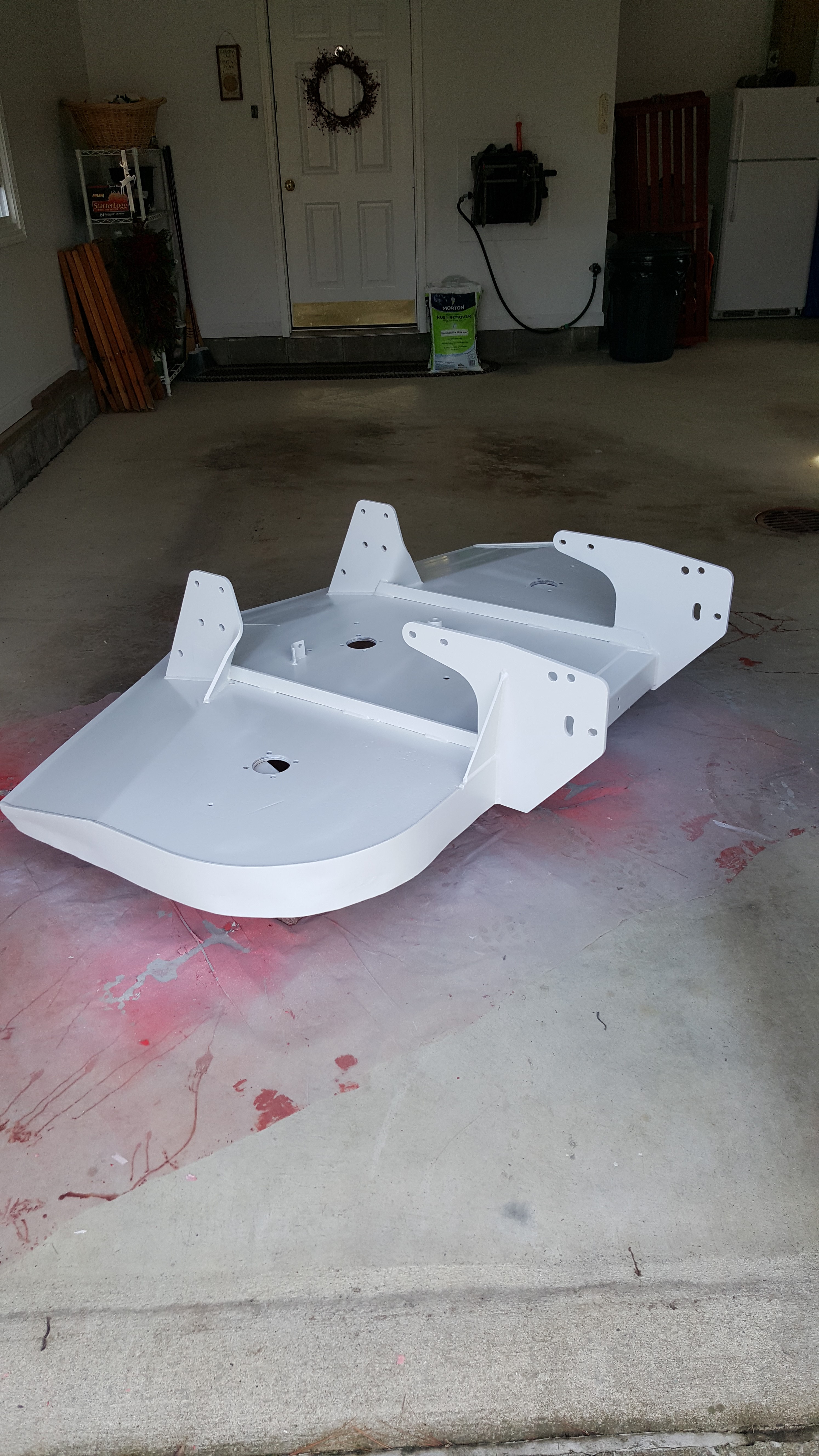

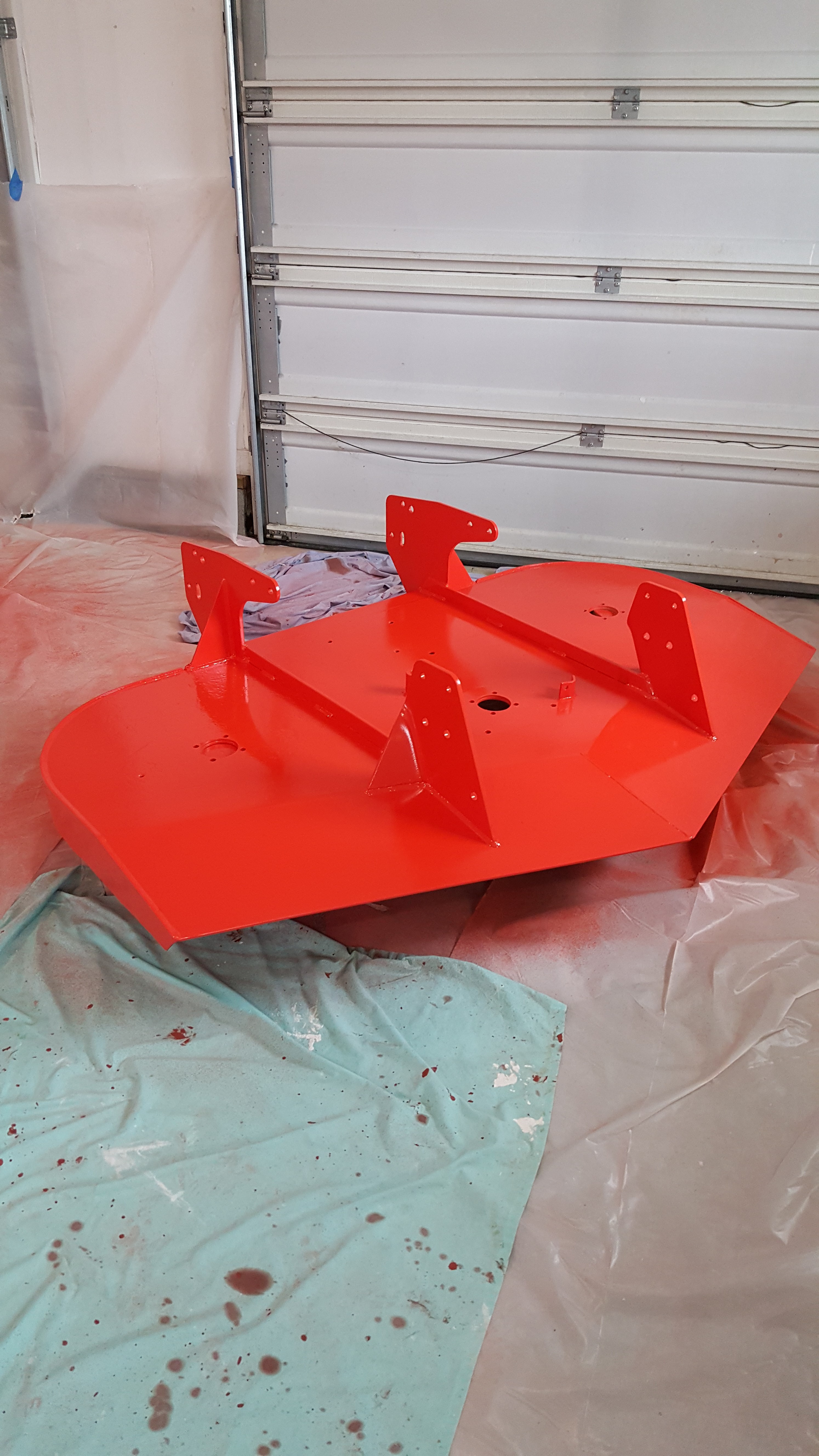

Yes I did get the decals from my Kubota dealer. I just got the 2 main ones and not all of the warning ones. I was surprised but the 2 big decals were less than $20.00. For painting, it is a big area, I bought a paint gun from Autozone, and a quart of Kubota orange paint and hardener from my dealer as I knew I would be doing other projects. This was my first attempt at painting, but it came out really well.

Was it a single stage paint, or a base coat/clear coat?
   / Kubota B2650 with Land Pride FDR2572, and LP cut quality? #7
It is a single stage paint. I believe acrylic enamel. I just primed and 3 or 4 coats of paint. Covered and worked really well.

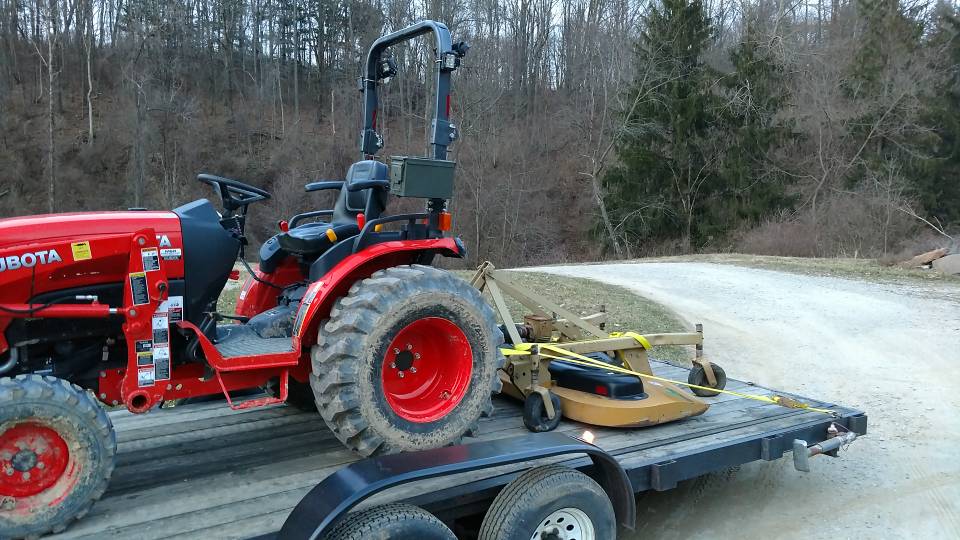

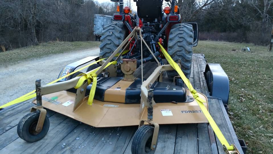

I got it last night, I think I got a deal of the year here. I'm excited to get new belt, blades, tires and paint on this beast!IMG_20180316_193748044.jpgIMG_20180316_193759237.jpgIMG_20180316_193811568.jpgIMG_20180316_193830438.jpg
