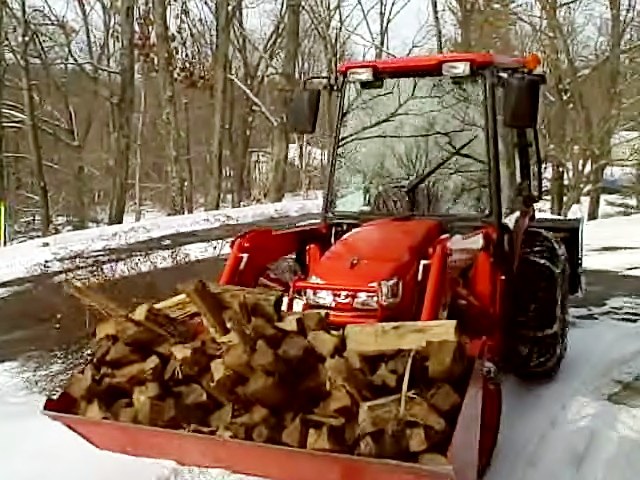

I run a Meteor 60" rear-mount blower. Personally I prefer it over the front mount. As you pointed out, it's cheaper and more rugged. In addition to being more expensive, use of a front mount disables the use of your bucket. Plus you lose ground clearance due to the sub frame and the pto shaft coming from the mid point of your tractor. To me, a tractor being able to switch between two attachments is nirvana. Try hauling firewood on a cold winter day with a front-mounted blower.

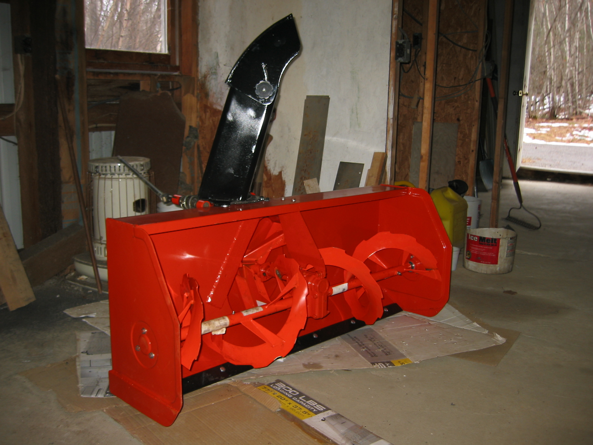

Not for nothing, but I think the front mount blowers are a horrible rip-off. they cost the same as similar rear-mount, and are 1/4 the weight. PTO mount blowers are made out of plate steel, and are designed to have their transmissions in the rear, so the whole chain-drive auger is open and the transmission is protected. The front mount blowers are built with the same design and materials that walk-behind blowers use, with thin stamped-steel body and a weak tranny hanging right out front just waiting to be smashed. For the $2000 a BX2750 blower costs, I can buy a similarly sized walk-behind, except with the walk-behind, I get an engine, wheels, and drive transmission.
I have a BX2750 that I recently did a full restoration on, as the PO had somehow mangled the heck out of it by sucking up a rock or 50. I made some design changes based on my 3pt blower, such as extending the side skids to full-depth, and adding a blade on the fan's chute entrance. I have the BX blower only as an emergency backup to my big 3pt blower that is on my L4200 (which could easily eat a car). There is no comparison between the two different types of blowers - total apples vs oranges.

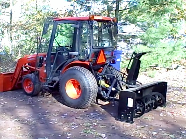

I have a rear mount snowblower on my BX22 (Pronovost Puma 54") and it's great. I can't imagine not having the use of my front bucket. As for driving backwards, I sit side saddle and use my heel on the HST pedal, it works fine. And I have a very long driveway, over 500' with curves. I also have side view mirrors, which come in handy when maneuvering in tight spaces with that bad boy hanging off the back.
