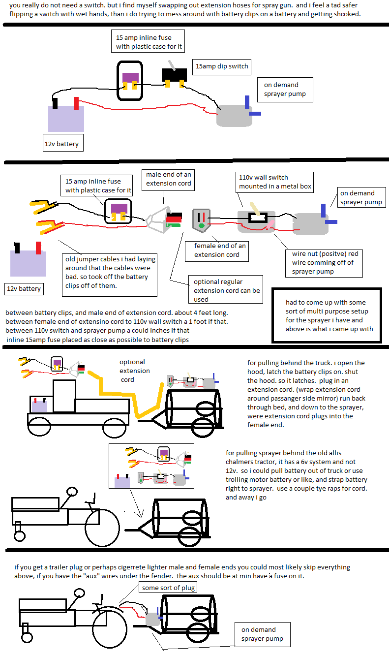

I just purchased a Kubota B2920 tractor. How do I establish a 12V plugin connection for my sprayer attachment?

The connector for auxiliary is under the right fender. I can't remember what it is fused for, but it terminates to a male and female bullet connector. It is only hot when the key is on.
   / Kubota B2920 how to make 12v connection #5
various diagrams. *shrugs*

Yes, I checked, the connector is there under the right fender !!!!! Thank you very much for the info..... I just need to get the correct bullet connector size and I am in business..... Thanks again.

It's there. Under the right side fender. Just understand, the B2x20 series is like the budget small AG/industrial tractor. The BX is more of the estate tractor. More likely to have a 12v accessory socket and cup holder.

Yesterday I got a bullet connector and an SAE plug to match the one on the sprayer, made the wiring attachment on the tractor for the plug, attached the sprayer, and it works just fine !!!!! Thanks again "skspurling" for the information...
For your info, I called my dealer and ask about the plug before posting on this site, they wanted to sell me a separate wiring harness with the plug included for $55.00.....they didn't tell me about the one already there under the fender !!!!!
