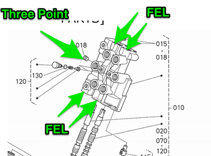

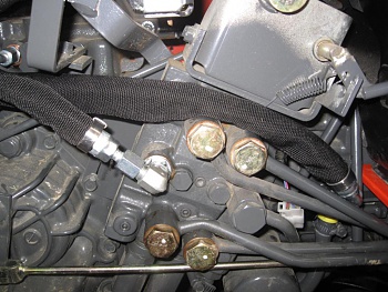

   / Kubota B2920 Power Beyond Port #39
I'm trying to hook up a third function valve to a Kubota B2920, and I'm trying to determine where the power beyond port is
This is a picture I got off the net, not mine but same valve
Here is a valve diagram and where the hoses appear to go
Watkins,
Getting back to your original post: I am not sure what you are trying to do, only assumption I see is a 3rd function to operate a grapple, is that right? If not, then what is the the purpose?
The picture appears to depict the distribution block on the rear of the HST and the diagram appears to be the FEL joy stick valve; right?
Is the intent to install a manual valve in the circuit at the FEL control or at the rear of the tractor at the distribution block? Or do you have BH connections and want to connect there.
How to you want to control the 3rd function: Solenoid valve in the lines to a set of FEL cylinders (normally the curl), manual spool Valve, manual double selector valve?
Answer these questions and maybe we can collectively get you a good answer for your perusal.
