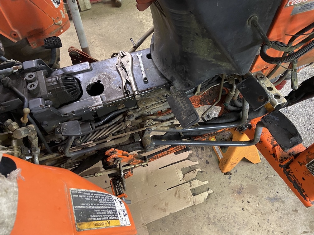

Here's some pics:
Last pic shows the location of the hole that has be drilled in the "tunnel" to access the roll pin holding the old yoke on so that it can be removed and replaced.
No guarantees that the locations of the hydraulic hard lines are the same on a B3030 though.
Maybe compare B2910 ---> B3030 exploded parts diagrams up on Kubota's website ? Might give a good idea.
IIRC, the u-joint/yokes are a single assembly: rear yoke/u-joint/front yoke.
