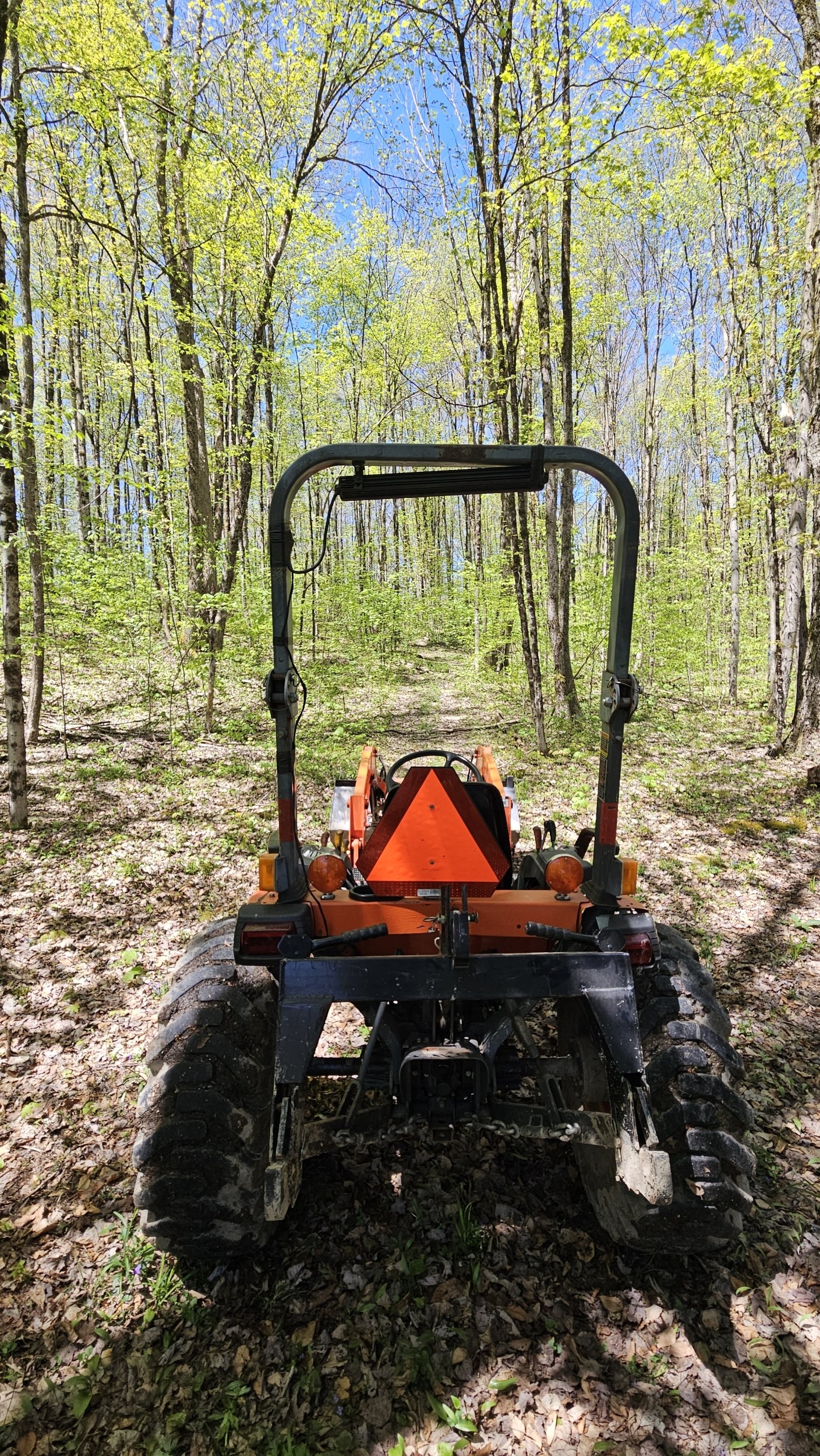

New to TBN as well as to Tractor life. Happy to be here. I'm shopping/researching a grader blade or box blade - are these the same? - for maintaining and repairing a muddy driveway with a Kubota 3200. plus lots of loads of gravel.
The market seems to be filled with different brands. Just trying to learn a bit more and get recommendations to help me funnel my shopping:
- Good brands that will work well with a 32HP Kubota? Maybe brands to avoid?
- Used x New?
- Good prices?
Thanks in advance!

you need a uphill ditch on that driveway first and foremost. A box blade isnt going to do that.
   / [KUBOTA B3200] Grader Blade / Box Blade Recommendation for Driveway Maintenance #6
I would remove a couple more trees and straighten it out. Looks tough to get a large truck in there (when dry). 2% slope to the downhill side might do wonders also.
   / [KUBOTA B3200] Grader Blade / Box Blade Recommendation for Driveway Maintenance #7
Holy crap, thats your driveway? No offense intended, its just so, so far away from being ready for daily automobile/truck traffic. Is this your future homestead? Beautiful forest!
You need an excavator first, not a box blade for your tractor. (ok you need that also, but not as tool #1). You could rent a mini-ex for a weekend and get things shaped up.
You need a 12' wide, crowned or sloped road bed, with drainage/ditches on each side.
Then you need 6+" of 2-3" sized rock. Then whatever final gravel type you want atop that.
This is just my opinion, but if you don't start with a proper base, you'll be fighting this driveway for the rest of your life.

Here is the rear end of my tractor:
