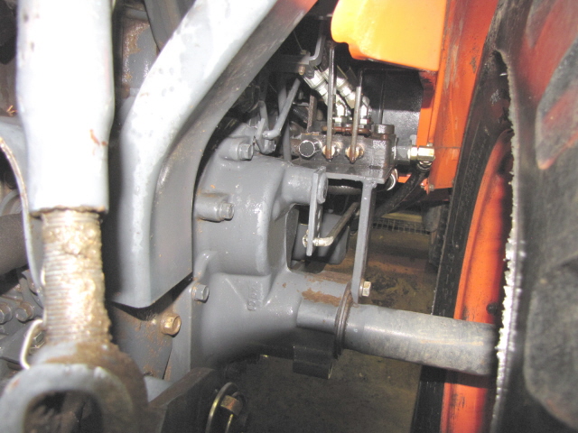

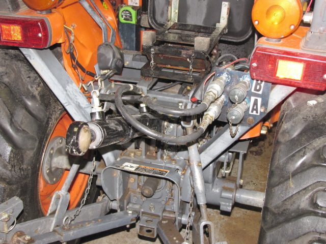

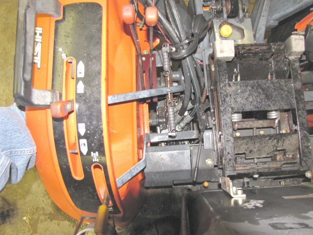

Here are the pictures. You might not have the room on yours with the loader valve where it is. Maybe you can get some ideals from them. The valve I used is 8 or 10gpm and is small.

The local Kubota dealership. The Kit which includes hoses, mounting bracket, and valve was $700. Probably the 3/8" think mounting plate was the culprit in the excessive costs. I will be moving my valve off of that mount to a spot that is not so obtrusive.
