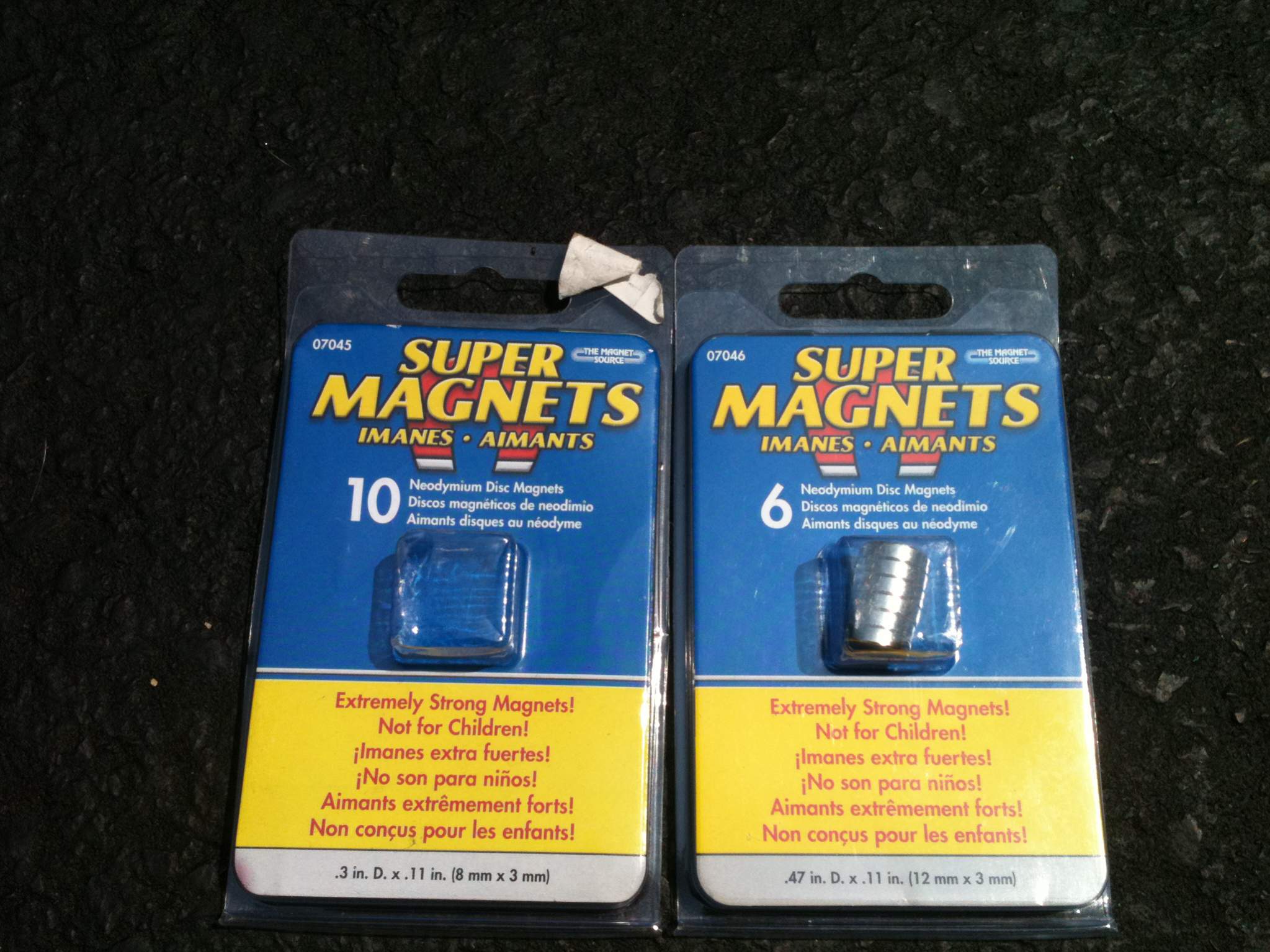

2. Added "rare earth" (neodymium) magnets to the all the drain plugs. Rare earth magnets are much stronger than then conventional household magnets. Plus they don't lose as much holding strength with temperature.
3. Added "rare earth magnets to the various filters.
Thanks for the info. I'm new at this so what are the magnets for anyway?
I didn't see this answered yet - the magnets are to capture any metal filings or shavings that might end up in the oil to lessen the chance that they get pulled back into the engine. It shouldn't happen anyway because the filter should catch them - but better safe than sorry.

Where did you get the magnets that you used? I'm going to have to do the 50 hour service on my tractor shortly and it would be a good opportunity to add them.
   / Kubota B3200HST 50 Hour Service #18
I bought them at a local hardware store, but it is more like hardware stores of 20 years ago when they actually carried useful items. Below is a picture of the ones I bought. They can be had in a variety of diameters and thickness. Perhaps a local hobby or craft store might carry them. These magnets are incredibly strong.
Here is one example of where they can be purchased online. K&J Magnetics - Strong Neodymium Magnets, Rare Earth Magnets
