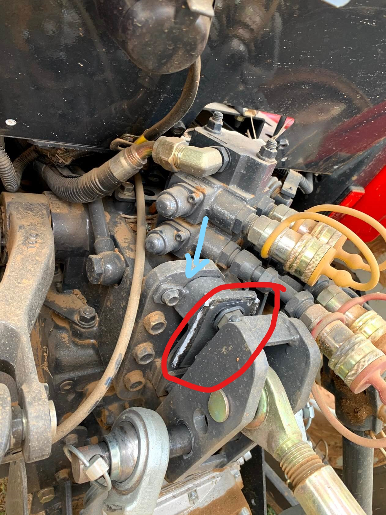

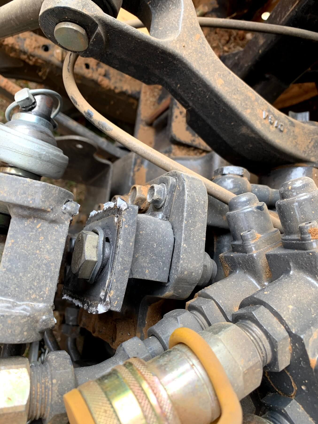

The first pic makes my eye twitch. Trying to figure out the second pic. What are the link(s) on each side of the top link and what is broken?
Those are two additional links, to prevent the backhoe from pushing the 3 pt hitch up when digging. Also, part of the reason of why it failed. Whoever used that backhoe, put all the top links basically in the same top link mount, concentrating all the digging forces there.
Maybe these two pictures help clear things up. It basically ripped the top link mount apart. You can see the broken welds (red circle) and the lock for the draft control (blue arrow). To unlock, the lock flips outwards and lets the top link mount pivot in and out.
View attachment 771094 View attachment 771093
Thanks for clarifying! My eyes were seeing the white areas as sealant residue of some sort rather than broken welds. The welds do look rather paltry.

You have the understanding of how it works basically correct. The automatic draft control responds to top link compression by lifting the 3pt arms when the load on the implement is increased.
That increased load happens when a plow either goes deeper or hits a rock or root - all of those cause the top link to be put into compression.
At the tractor, the top link connection which seems so rigid is actually a very heavily built pivoting spring mount that triggers the auto draft control when the pivoting mount moves a fraction of an inch. It takes tons of compression to trigger the automatic draft control, but when it does, the reaction to raise the 3pt arms takes place in an instant. Usually raising the arms an inch or two will allow the implement to rise enough to clear the obstruction. As soon as the plow clears the obstruction it returns to the previous depth and all is well.
But with a backhoe pushing down to lift the tractor - as long as there is downforce on the bucket the compression on the top link can't go away, and the arms will continue to raise until they are all the way up. Crushing anything in the way against the back of the tractor. The lift arms go up in a series of violent jerks as the auto draft control works at max pressure in conjunjction with the 3pt relief valve. Everything bounces, shakes, and pops as the arms raise and crush the intervening parts. The draft control lift system cycles so fast it sounds like a a machine gun. This all happens so suddenly and is so violent that it is hard to keep your wits working.
As the lift arms raise under unusual pressure they may only move an inch at a time but they do so several times a second. That's necessary when plowing of course - which is the purpose of the auto draft control in the first place. And it is why the lifting force is to unusually high and the motion so abrupt.
When a 3pt backhoe is fitted between the lift arms and top link it is compressed right along with everything else in the way as the arms lift. It's not uncommon to break the top link mount and bending the top link as well as squashing everything in between arms and top link.
Safety strut systems are one answer, and are simply beefed up extra struts that are stout enough to keep the lift arms from raising. That requires some serious steel. The problem there is that the forces are so extreme that if the strut holds, something else breaks.
Hope the explanation helps. It isn't a problem if you just remember to turn auto draft control off.
