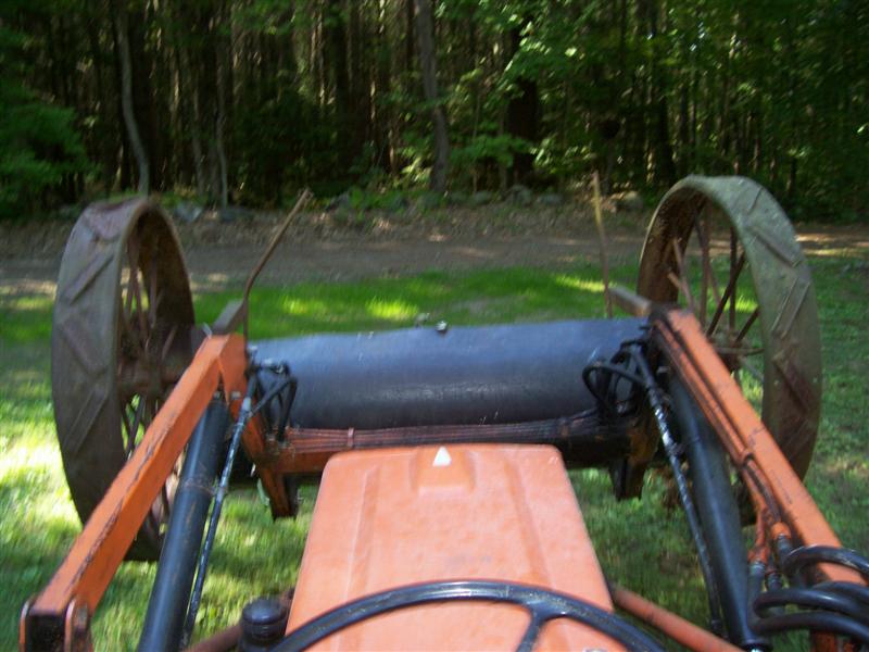

I have either a 506 or a 515 loader on my kubota b6000. The bucket is croaked on it. it seems like the left hand side lift cylinder sits down lower than the right. so I took a tape measure to it and the left side is an inch lower than the right. I rebuilt both the rams not even 4 hours ago. It is still the same. the loader is full of hydraulic fluid. I can get some better pics tomarrow if needed. But I would really like to fix this so I can sell it. If someone knows something please let me know. any help would be great. oh ya and it does it without weight in the bucket too!

I would not be surprised if the arms were bent or torqued.
or maybe the sub frame.

eI unhooked both rams and worked them both. the one on the left that is an inch lower works slow. and once the one on the right that is alright is fully out or in the one on the left works fast. idk what could be wrong with this thing.

thats normal. every loader in the world will do that. the hyd fluid pushes the loosest ram out first, then as it tops out it supply's a bit more pressure to the other ram.
my guess is the loader frame is either bent or the mounts have moved on the tractor. as a start loosen the mounting bolts where the loader meets the tractor, then lower the loader until the weight just comes off the front axle and re tighten the bolts. this will square the loader bucket to the back wheels. if it doesn't start looking to see what is bent.
