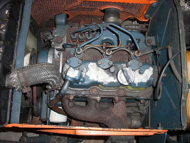

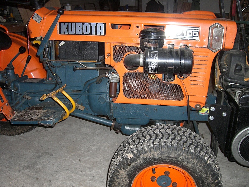

Okay ... the pix showing the engine does not look like the one my B7100. For one thing it appears you have a different generator/alternator. and the exhaust manifold appears somewhat different.
If I had to bet, I would say that you have basically a B7100 which has been fitted with a slightly different replacement engine and hood and ????.
The specs say that the B7100 has a Kubota D750-A engine.
Hope that helps
Sherweld

It definitely looks like a hybrid. The front frame on a B7100 is not as long as what shows in your picture. The B7100 hood hinges at the bottom just below the radiator. The fuel tank looks right for a 7100 (off on the left). To my knowledge, all 7100s had the D750 engine.

Frame looks right, engine looks too short, how many cylinders is it?

It's a 3 cyl diesel
I could look for a engine serial# if you like

The fuel tank and batt look exactly like mine. AF and fuel filter loook similar too but I'm not near the tractor right now so not 100% sure.
The pic of the tranny looks like mine too.

Here are a few photos of my B7100 jon. See if you can make some comparisons with your machine. If you need more photos, let me know.

There are diffidently a couple of differences that I notice right off
1. It looks like your tractor has a larger radiator
2. Mine has a water pump (in your photos It doesn't appear that your tractor
has a water pump but I might be wrong so please correct me if I am
2. On the dash of my tractor there is a label that reads "decompression knob"
but all there is, is a hole. As far as I can see there is no decomp option on my engine.
3. and as already noted the alternator is diffidently different
I am going to talk to the dealer I bought the tractor from and see if they can connect me with the original owner.
I will report what I figure out as soon as possible
Thank's everyone for your help, Jon
