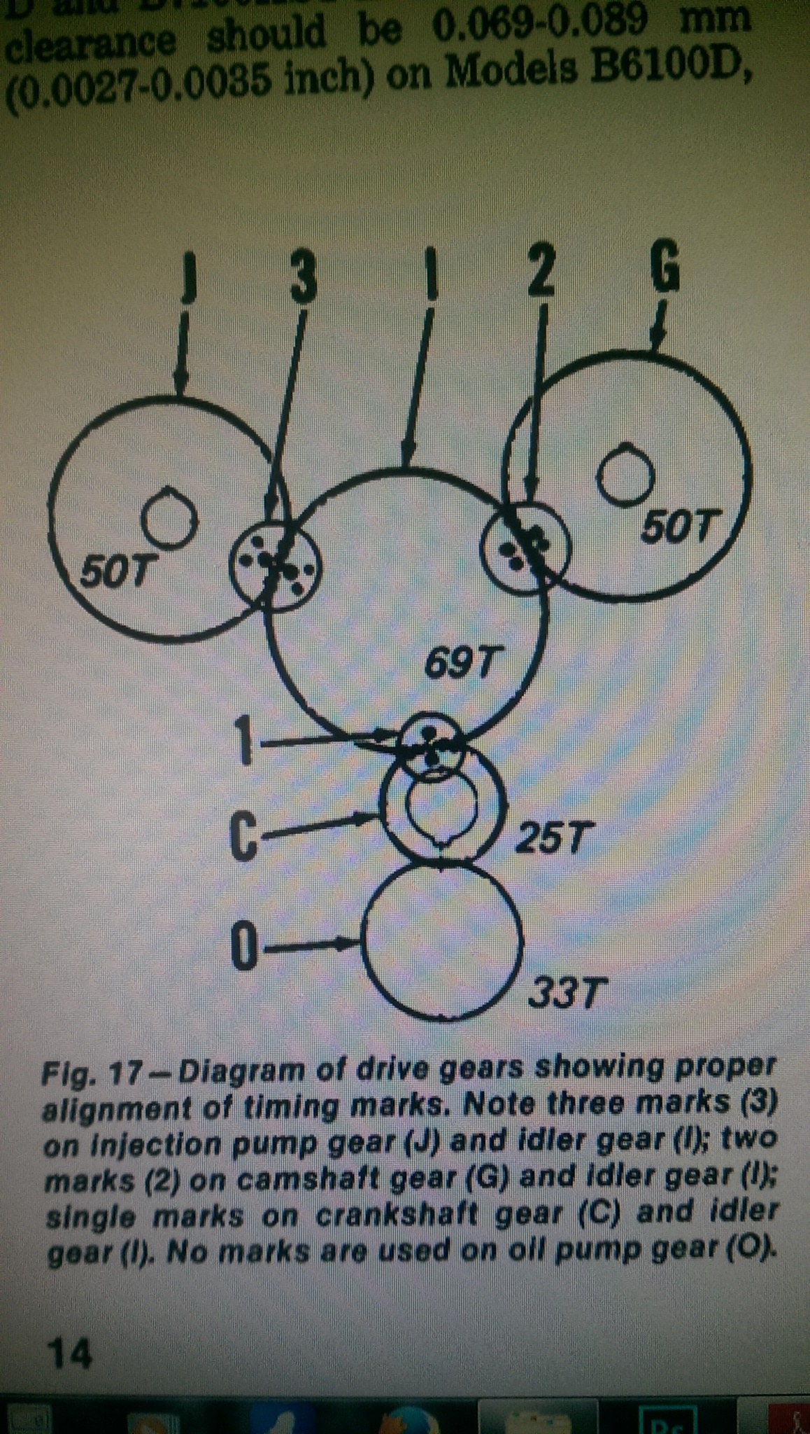

I know the timing is set correctly in regards to the gear set as shown by Eagleview. The repair manual discusses using a plastigage to check spacing between piston and valves with min. allowance of 0.6mm and says the gap may be increased by using a shim gasket. I don't particularly like the idea of stacking head gaskets but the overhaul kit did include a regular head gasket, which I used, and then a second thinner metal?? head gasket. The thinner gasket is I assume the shim gasket referred to in the manual. I thought I would also increase the valve gap to max end of the range to possibly provide a little more clearance.
What other recommendations do you guys have??? If you go back to the very first page you will see a picture of the alignment of the timing gears with the dots not lined up as shown in the manual. This is what I found when I took it down, the dots were not perfectly aligned as shown in the manual. When going back, I lined up the dots as shown in the manual.

Where was your piston at when you took the pictures on the 1st page?
   / Kubota B7100 Overhauled now will not run
#39
I cannot recall now, as I took the pictures back in December. I checked back through the pictures I have left and none show the position of the pistons. I do recall spinning it around and around that was the closest they ever came to lining up with each other.
If I were to pull the timing gear cover off to recheck, where should the piston (assume we are talking about front piston #1) be when these timing marks are aligned?
