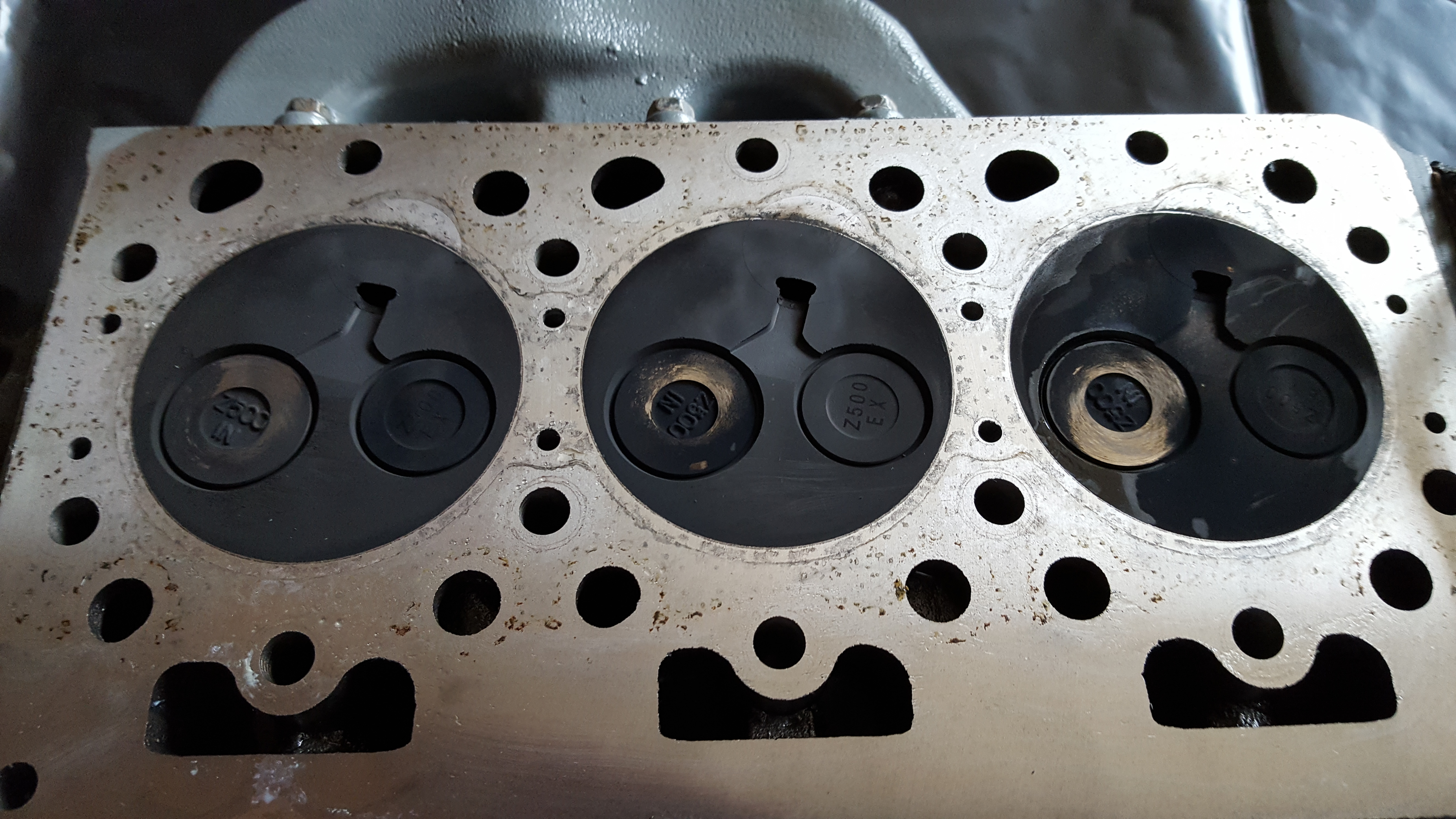

It should be at TDC on the compression stroke. Look in your manual and see if they are setting the timing on #1 and see what one front or back is #1. I do know if the valve timing is just a little off the valves well hit. After you get it all set turn it over by hand while holding you hand on the rocker arm. If any are hitting you can fell it. The crank mark and idler mark should be dead nuts on. Make sure they do not move while lining the others.

I would also back the rockers off a little to give you some more lash as there is something going on with piston to valve clearance .

I will back off the rockers a bit to help with the clearance.
Thanks, I may take the timing cover back off to check this again. I know both the crank/cam and crank/injection pump marks were dead on when I put it back together. I cannot now recall when the piston was at that point but I did slow turn it over by hand and made sure that all valves were opening and closing in time with the pistons on their compression/exhaust stroke. Everything seem to work just as expected and I am surprised by how close the piston and exhaust value are running. Looking back to my first post and pictures, it looks like it was set up so that the valves and injection timing were both slight ahead of the pistons???
The attached pictures shows that the clearance is not the same on all three and hopefully some valve adjusting will ease the situation. 20160416_100546.jpghat20160416_100546.jpg

I got to correct myself, the piston should be just BTDC to TDC.

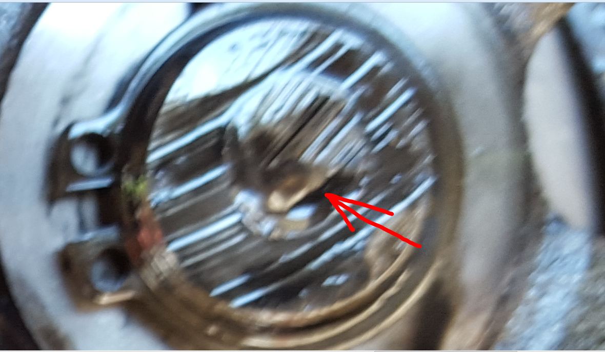

Oh, forgot to mention on the last run today the oil light did not go out after it started. This is the firs time I noticed this and I am pretty sure it was pumping oil; I did install a new oil pump. And, it was pumping oil out of of the missing oil galley plug right after I first tried to start it a few weeks ago. I noticed this and got a new plug, as it was left out at the machine shop. Also, when turning the motor over by hand to set the valve clearance I noticed oil begin to drip from beneath the motor before I put on the oil pan.

These engines are notorious for having low oil pressure due to the aluminium oil gallery plug coming out of the camshaft . People put a piece of steel in the hole and weld it in and they regain their oil pressure . Judging by the grind marks on your plug and the ones on the cam not lining up , someone has done this and now your plug is likely loose . The Red arrow is pointing to what appears to be a gap where your oil pressure could be escaping from . Probably where the weld tore out and the plug has turned a little .
It takes 7psi to put out an oil light , an engine needs 10psi of INITIAL oil pressure and 10psi for every 1000 revs after that . An engine doing 3000 rpm needs at least 40psi for example . If you have only got 6 0r 7 , it is likely your Mains/Big Ends and cam bearings are swelling with the heat and acting as brake on your cam and crank .
What did the bearings look like when you pulled the pistons to fix the ring gap ?
I have no idea what holding the Glow plugs on is doing to help unless it is just the 20 seconds that it takes you to do it is allowing the crank and bearings to cool , just as they do when you said you can leave it for a few seconds and it will wind over .
YES, I HAD READ ABOUT THE PLUG IN TH END OF THE CAM COMING OUT AND IT APPEARS THAT HAS ALREADY BEEN FIXED. IT LOOKS LIKE A STEEL PLUG THAT HAS A SMALL "SPOT" WELD HOLDING IT IN. I CHECK THE PLUG CLOSELY BEFORE AND IT LOOKED TO BE GOOD AND TIGHT. THE PICTURE I TOOK IS NOT THE BEST, BUT I WAS AWARE OF THIS BEING A POTENTIAL PROBLEM AND DID CHECK IT TO MAKE SURE THERE WERE NO SIGNS OF IMPENDING FAILURE.
THINK I WILL RUN DOWN THE FITTINGS NECESSARY TO REPLACE THE IDIOT LIGHT WITH AN ACTUAL GUAGE SO I CAN SEE EXACTLY WHAT IS UP WITH THE OIL PRESSURE. THIS IS SOMETHING I HAD THOUGHT ABOUT DOING IN THE FUTURE ANYWAY AND NOW APPEARS TO BE THE TIME TO DO IT.
The rod bearings looks good, very little indication of any wear and no discoloration to suggest any problems with those. I did not pull crank, so did not get a look at main bearings.
YES, I DO NOT THINK IT HAS ANYTHING TO DO WITH THE GLOW PLUGS, BUT RATHER THE TIME DELAY. IT IS VERY INTERESTING THAT THE MAIN BEARINGS, WHICH CERTAINLY COULD BE THE PROBLEM IF NO HYDRAULIC ISSUES, WOULD COOL DOWN THAT FAST AFTER GETTING HOT ENOUGH TO SEIZE THE MOTOR.
