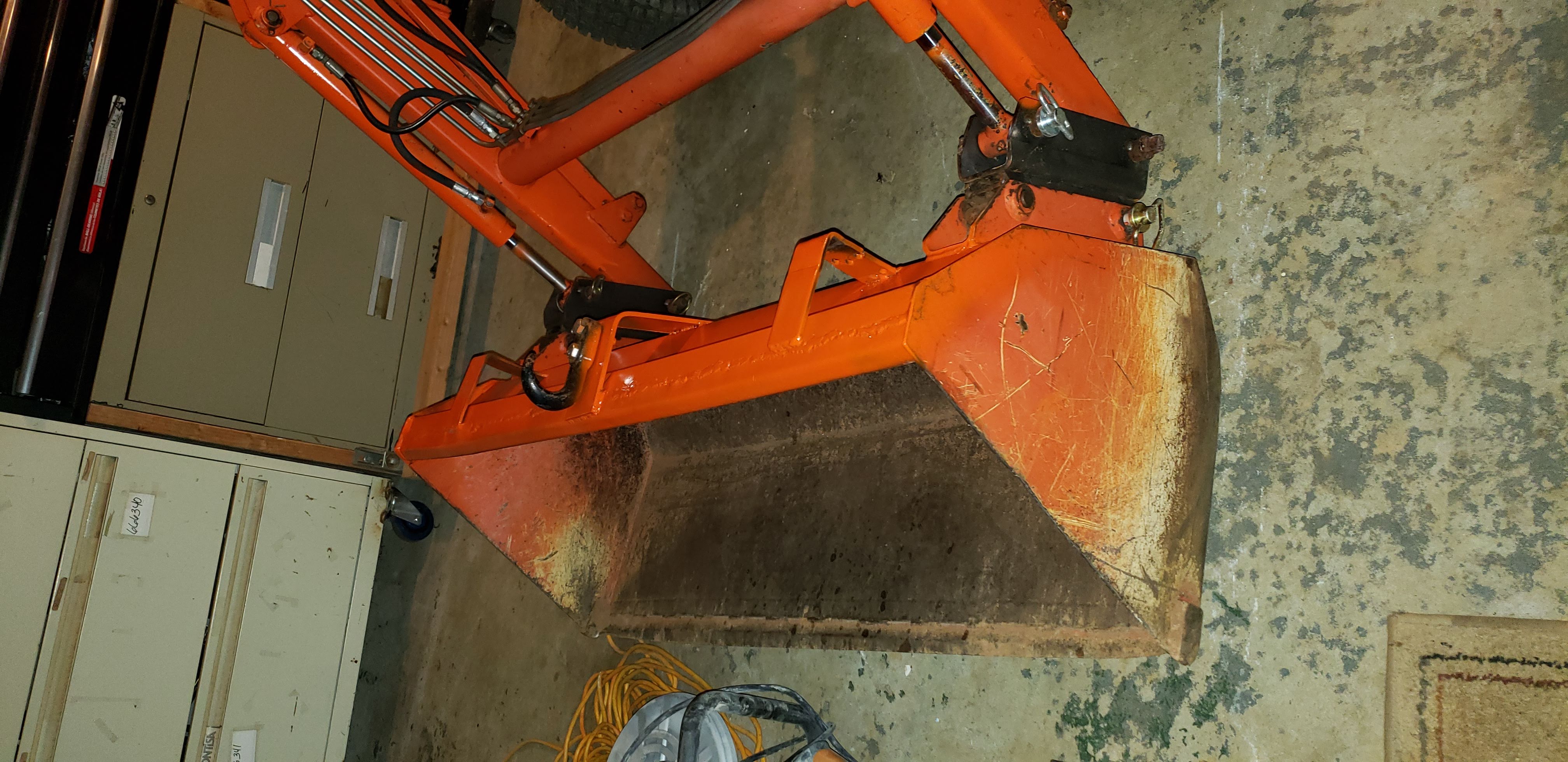

Spirostats - I like the frame shape. How did you make the bends in that heavy flat stock? You did a good job making them the same for both sides.
Im sorry I somehow forgot to subscribe to the thread and have not been notified of your post. I just saw it now. I ordered these ones today from asmazon https://www.amazon.com/gp/product/B01KJ94Q1K/ref=ppx_yo_dt_b_asin_title_o00_s00?ie=UTF8&psc=. We ll see how it goes
As far as bending the metal....no special technique. I made a mock up using a thick aluminum wire and kept checking the angle little by little as I was bending it on my harbor freight 20 ton press which is equipped with a "swag offroad" brake.
I want to thank everyone for their suggestions. I ordered the headlights and will later put the lightbar somewhere else to use as an auxilary. I will update this when I figure out where. In the mean time I fabricated a hook mount for the bucket. Here it is ...
PS I also added another angle brace on the other side for symmetry ......I have a "slight" case of OCD ...:(
