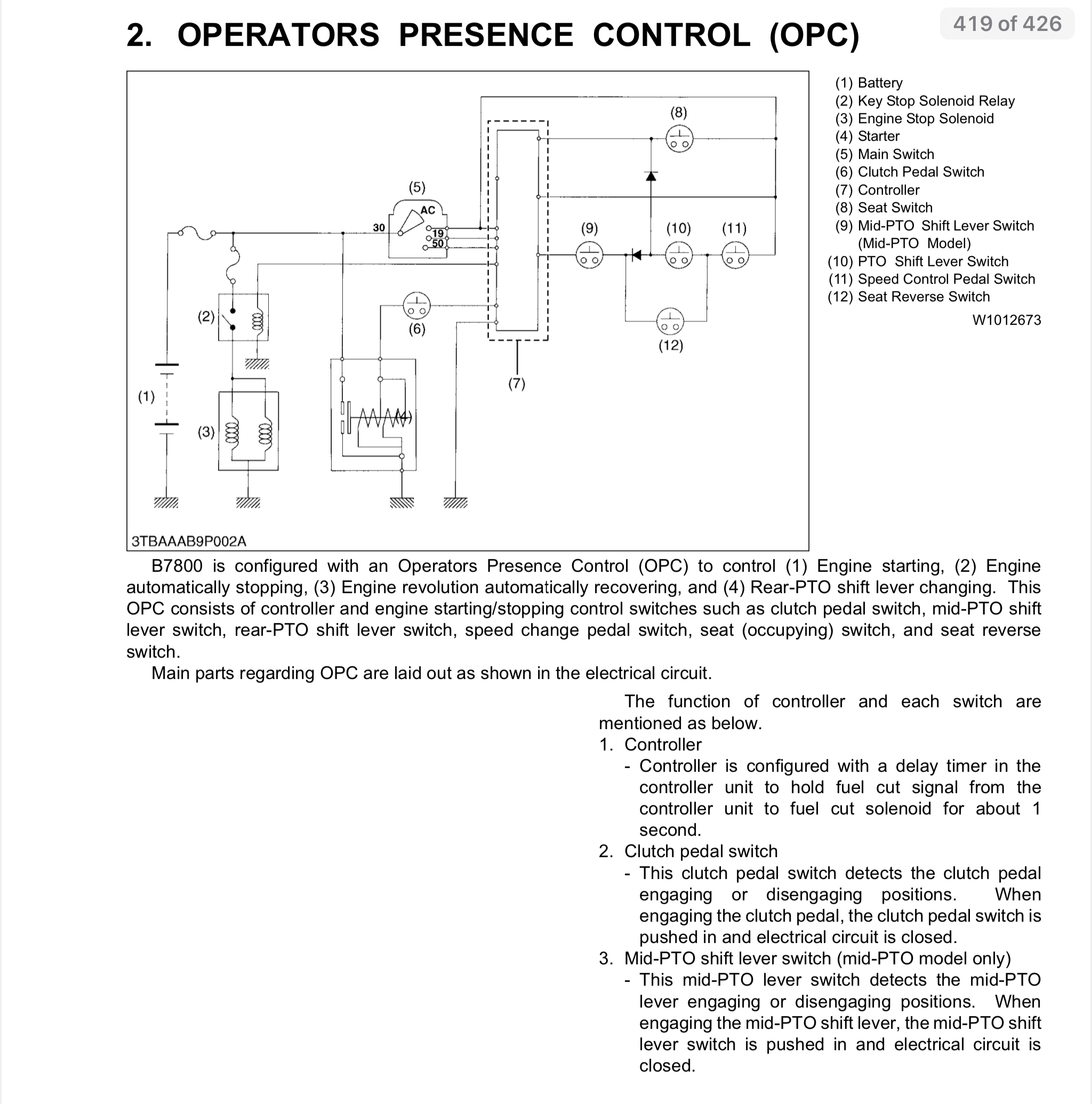

It's Memorial Day, 2022, tractor is dead in the vineyard.
What I learned:
1) Both seat sensors are working (Side lesson; seat tip-up sensor is so you can operate rear PTO WITHOUT your butt in the seat and tipping it back will shut off the unit),
2) Typical fuel solenoid is 2 wire, 12v HOT to remain open and supply fuel.
2a) "It should Only have power supplied After the key is turned off, and then Only for about 5 seconds.
It may have 3 wires "then it has a Pull winding and a Hold winding...
Kubota has used both types on various tractors & engines." KennyV
3) Relay under the dash; (TomJ, "...fuel relay... ACA12115 (CA1a-12V-A-5)" via internet. TomJ
I'm going out to feed the mosquitos, jump the fuel solenoid to try and get this back to the shed. I hope to do this without tearing the dashboard apart. I can't access the center, rear PTO safety switches or the Fwd/Bwd pedal safety switches safely on the soft earth of the vineyard.
to be continued...

This may help. From the B7800 supplement to the B2910 WSM.
   / Kubota B7800 No Power At Fuel Stop Solenoid #15
I do not understant the Controllers function delay timer to hold fuel cut signal from controller to fuel cut solenoid for 1 second.?? unless that is for the off the seat fast to run stationay pto equipment.
   / Kubota B7800 No Power At Fuel Stop Solenoid #16
On that model the fuel solenoid is activated to stop the engine,
after the time delay it de-energizes and lets the fuel stop return to the run position.
   / Kubota B7800 No Power At Fuel Stop Solenoid #17
Thank you LouNY (so no one pronounces "LOONY" do they? :)), thank you also Henro & Ed. I don't understand the relay logic either.
I hot-wired the normally closed fuel solenoid, took a butterknife to the battery hot + solenoid, key on, and it started up.
There was, however a click-click-click-clicking from the fuel stop (or somewhere around there) the whole time at about 1Hz or less and it was running rough. (??)
I think it's to prevent nuisance power losses from things like bouncing up and down in seat. My wife is so small that she barely trips the seat safety switch and when she bounces up and down in the seat on our lawn tractor the engine is constantly losing power briefly as she bounces across the yard driving way too fast.
In the schematic above, switch #12 (the seat reverse switch) is what allows the rear PTO to run while the seat is folded forward.
