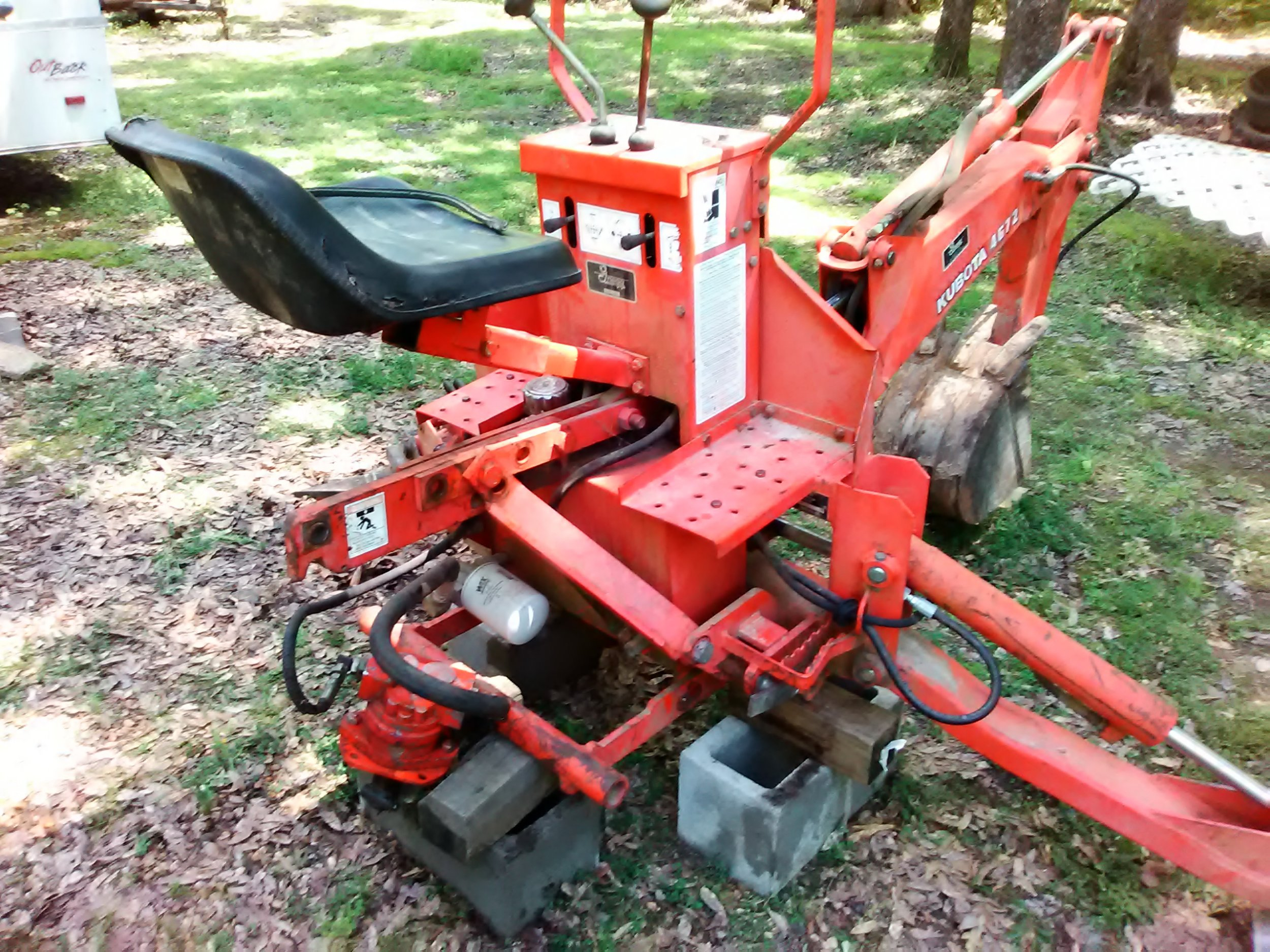

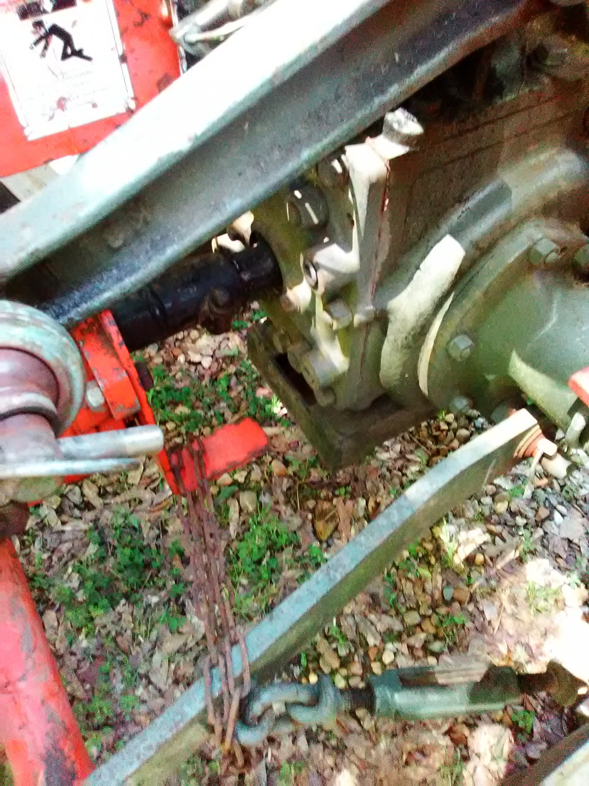

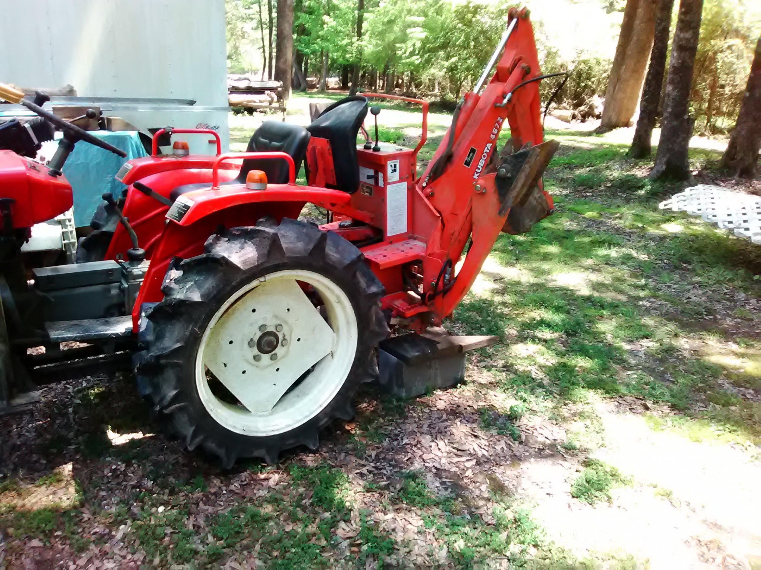

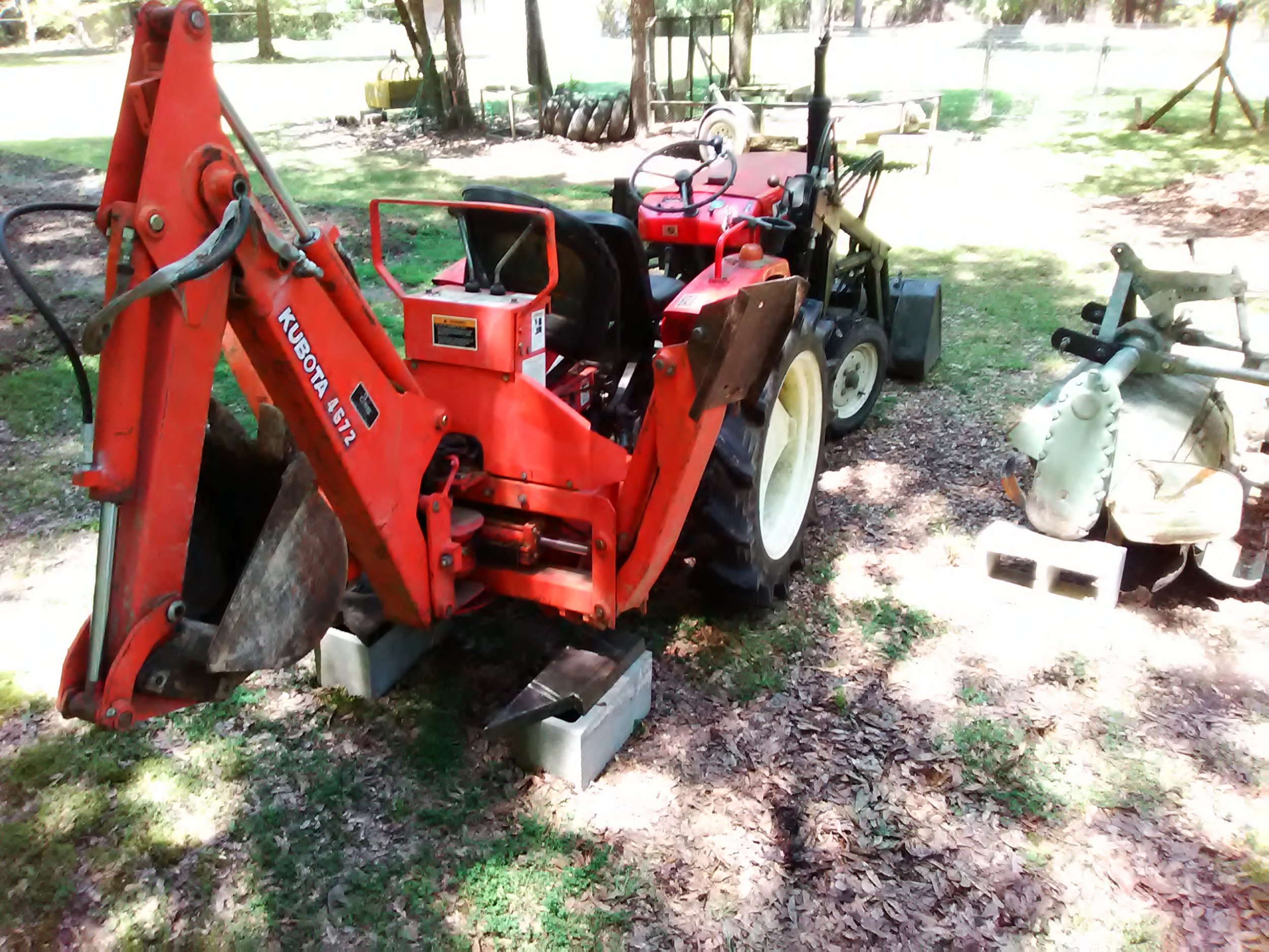

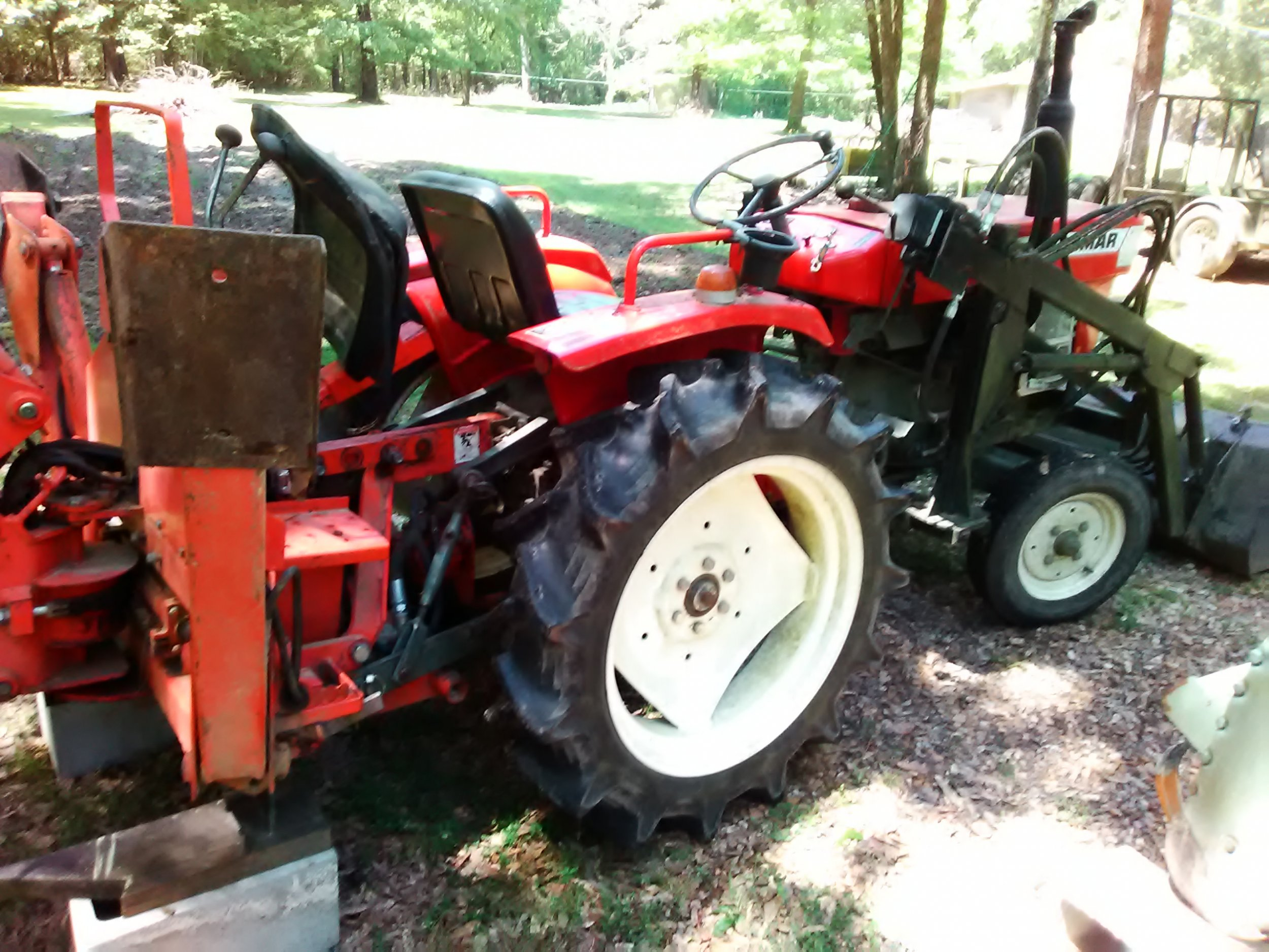

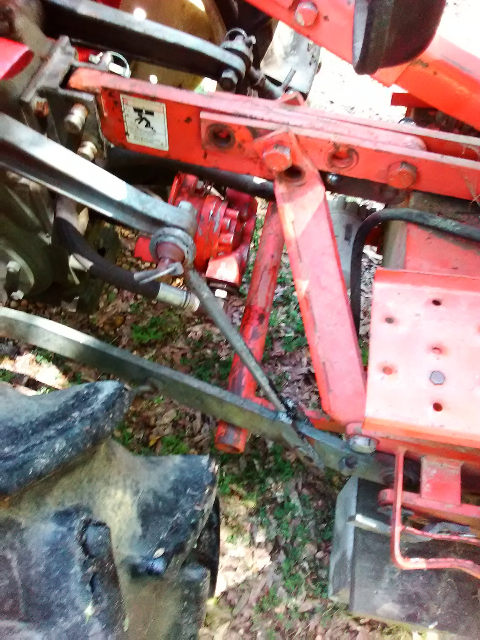

With about 200lbs in the fel, it rides pretty good at slow speed. One question, should the holes where i have the lifting arms attached to the uppers, in the correct hole ? It's in the upper hole now, is that for max weight or no? Like i said this is going on the 1720d, i believe like the other ones limit is around 1400lbs on lift. But i'm only using for small jobs in sandy soil and clay (about 12-18" dn), fairly level ground.

If it is the case where this thing is to big for this or the 1720d, that i have. One thing i don't want to do is screw up what i have, a bh, one does have options on. It is sorta heavy and i do worry about it, but not about getting money back on it, that's for sure. I don't believe those data.com sites on tractors much, only what i see and feel on my tractor, what it will and will not do. I do know that picking up some logs with my boom, only about 600 lbs. is the heaviest i have lifted with it. And that's w/some counter balance in the bucket. My land is pretty sandy soil and flat, so this my be, a little over kill for my needs. But i couldn't let it go from this area, before checking it out and deciding more on it. Hey, it's not eating nothing and it's paid for, or maybe for sale soon. Thanks again folks !
   / kubota backhoe on a yanmar #15
It's not the weight of the implement at all, it's the force imposed on the rear case from the digging and bucket action of the BH that imparts strain, especially on the upper 3 point mount. Years ago I had one just like the one you have and sold it. Exactly like it.
That upper steel arm that pins to the top link bracket allows the BH to exert tremendous force on the mount and the mount is directly connected to the axle case which is a thin wall casting.
All I can say is be careful, Never use the bucket to move the unit around, never set the stabilizer pads down to the point where they lift the back wheels off the ground and never curl the bucket against an immovable object like a root and try to break it free by curling the bucket and retracting the dipper stick.
All those things allow that top strut to impose unnatural strain on the top link and will crack the rear gearcase casting.
Know of a guy with a hoe like yours and mine that cracked his axle gearcase and it cost him 7 grand to have it replaced, an expensive lesson and why BH's are all direct frame mount now for the most part. With the frame mount ones, you take the lower lift arms off entirely and there are steel rails that run up the tractor frame rails that impart the load to the tractor frame and not the gearcase casting. With yours, the entire load force is on the upper mount, bearing down on the gearcase casting. It's not designed for that. It's designed for moderate pulling horizontally and the drawbar is for hard pulling. Good luck and be careful.

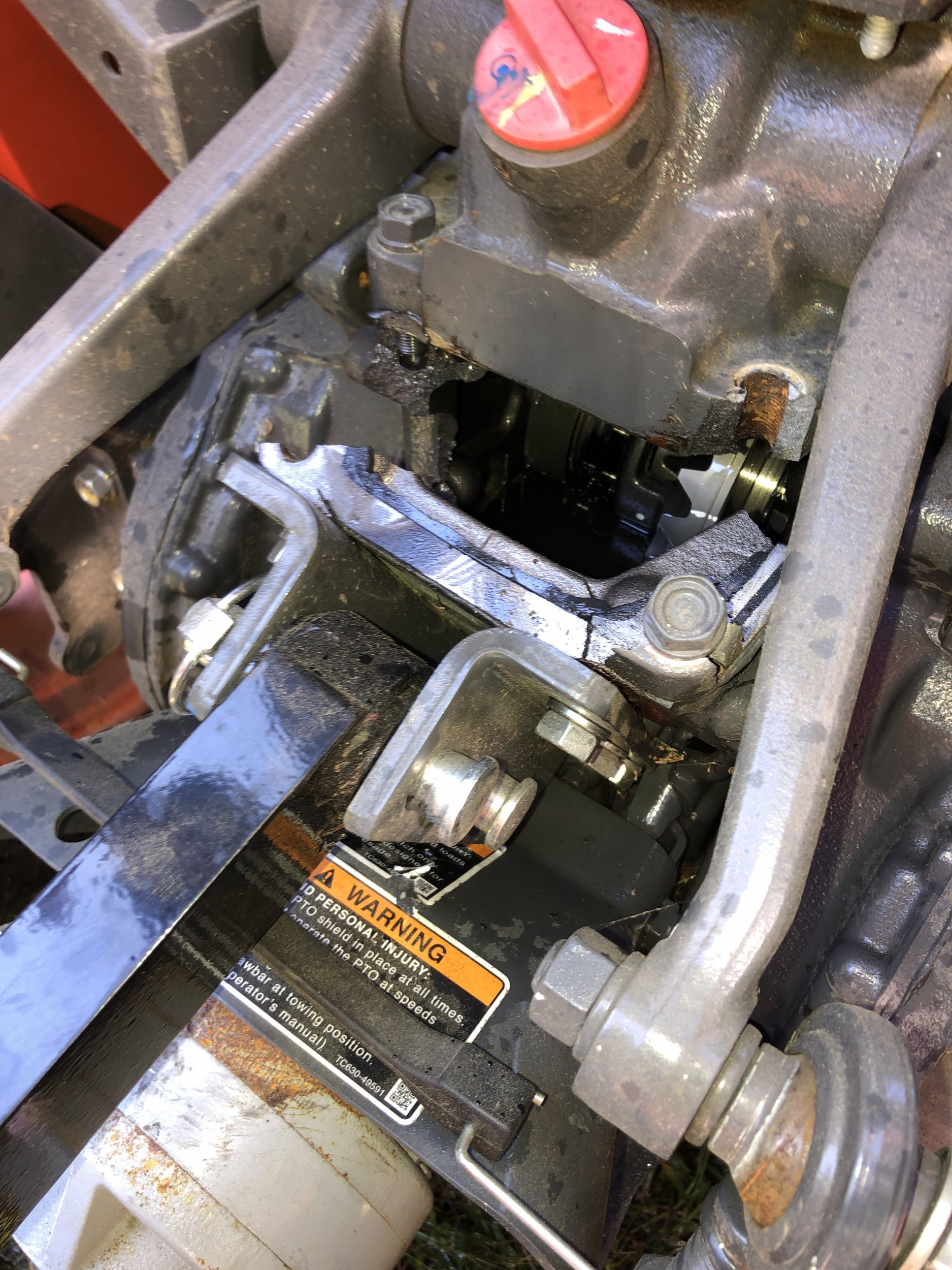

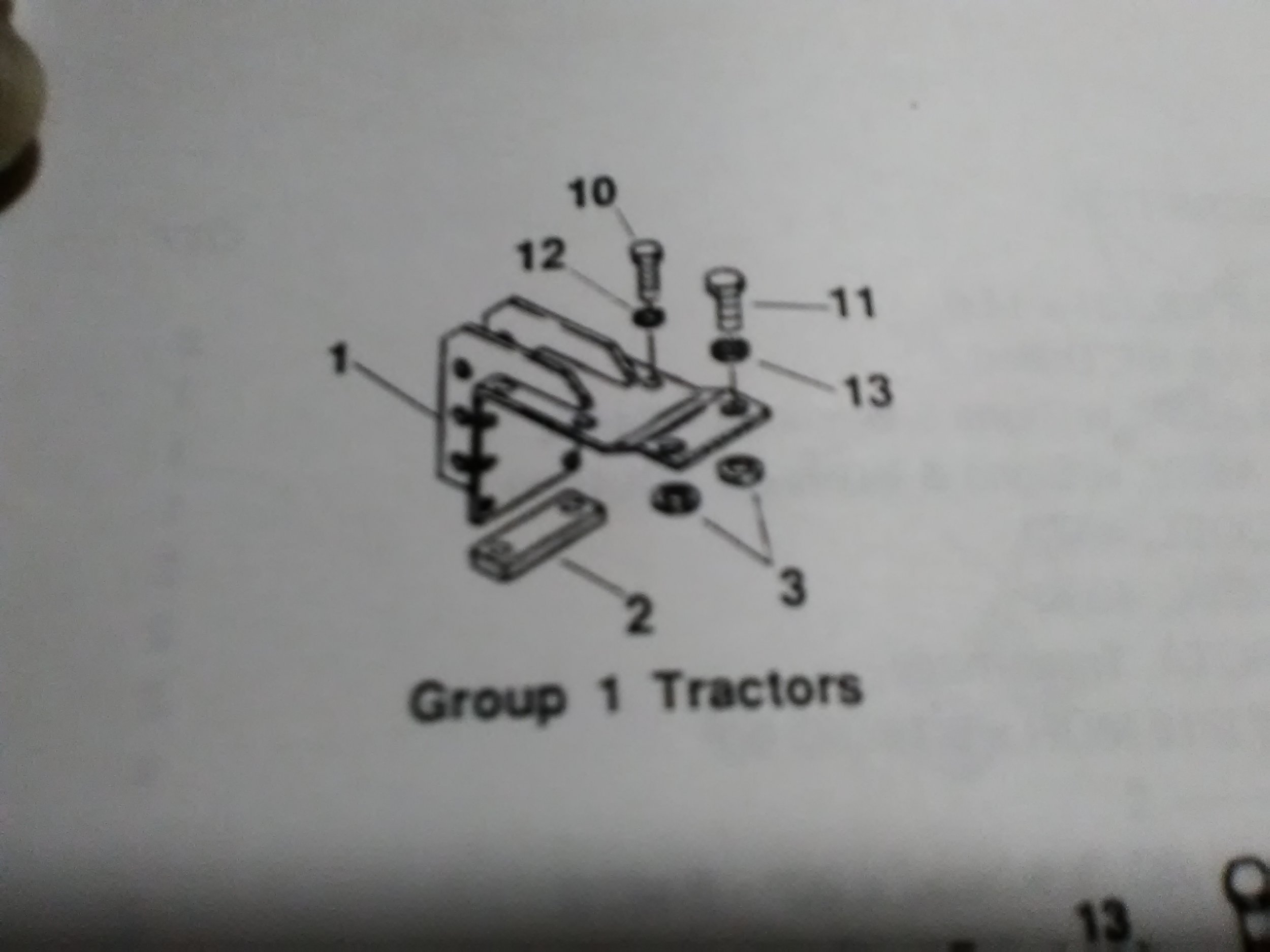

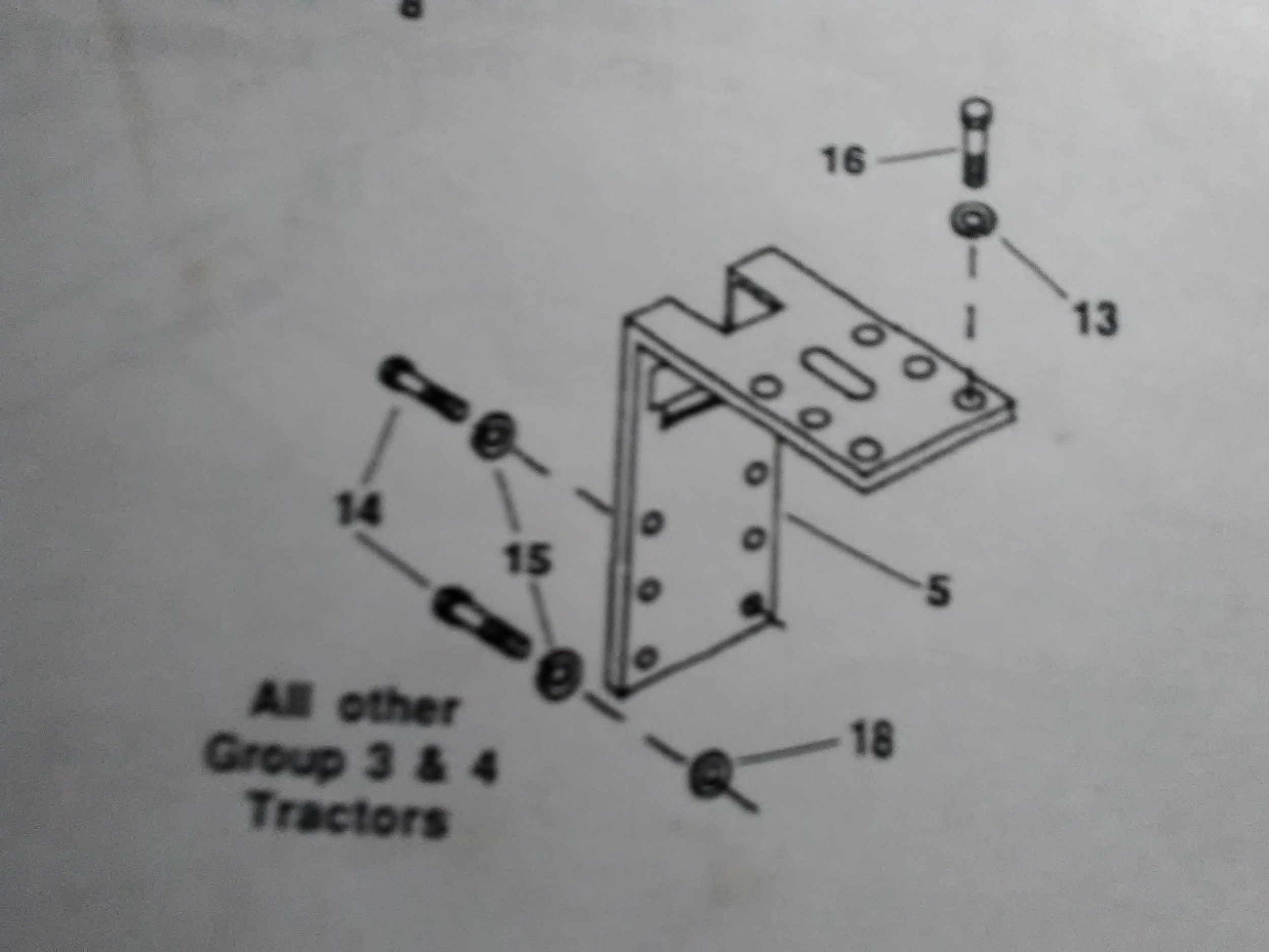

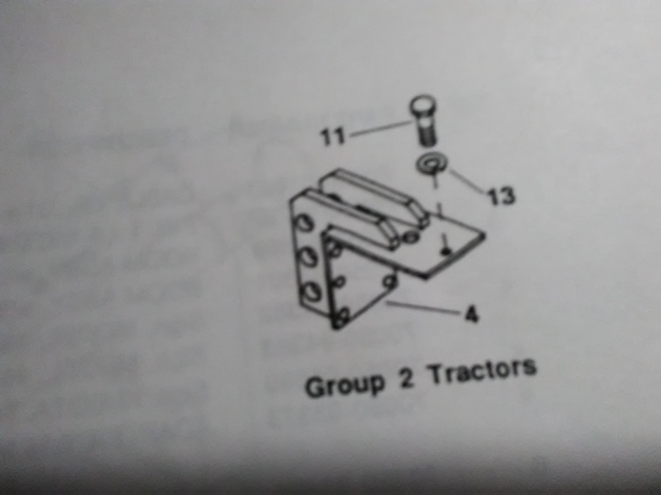

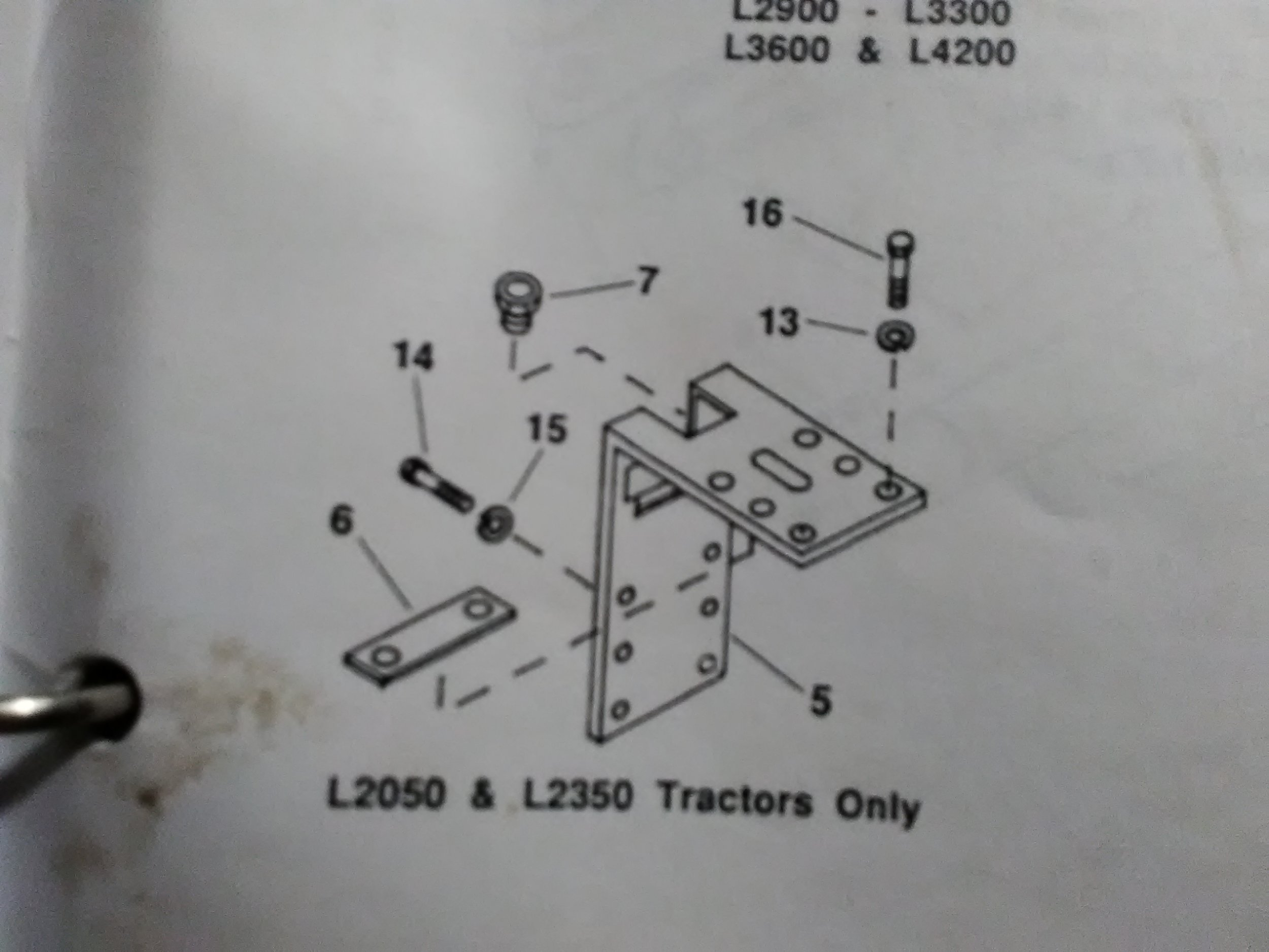

I read in the manual, that there is a special plt / mount for the top link on Kubota's. It goes over the rear casting and bolts on under seat area etc.. Maybe someone can use this as a reference, for bh attachment warnings.
