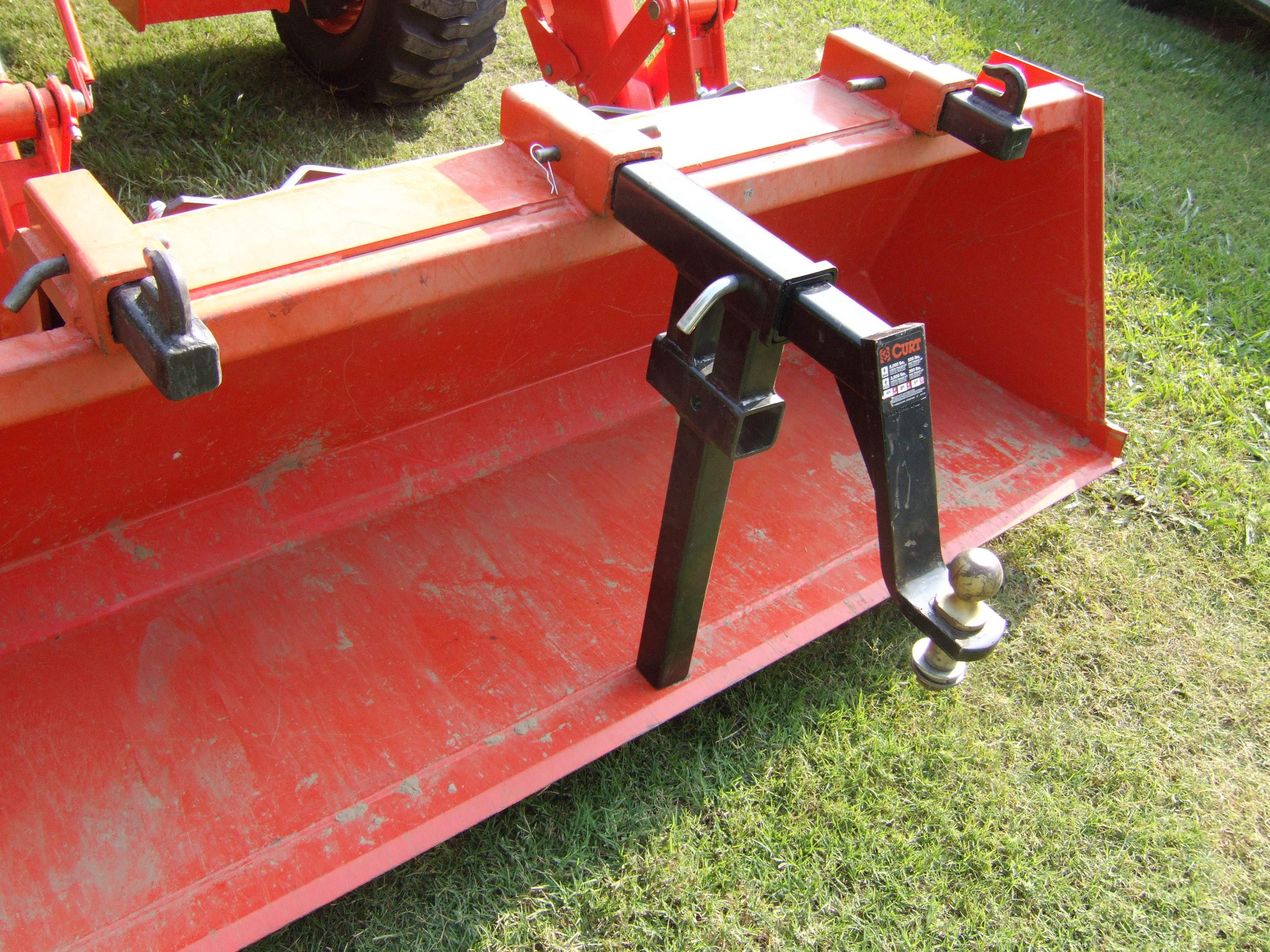

Here's what I did. The receiver in the center can be used for either a slip hook, grab hook, or a trailer hitch with ball , and all are interchangeable, and the possibilities are limitless. Works well for me. DSCF1294.jpg
   / Kubota bucket hooks #28
Here's what I did. The receiver in the center can be used for either a slip hook, grab hook, or a trailer hitch with ball , and all are interchangeable, and the possibilities are limitless. Works well for me. View attachment 277907
Very nice.:thumbsup:
   / Kubota bucket hooks #29
Added a reciever like TripleR did!! Works great!!
   / Kubota bucket hooks #30
For clarification, Curtis Gray did the receiver; indeed very nice.:thumbsup::)
