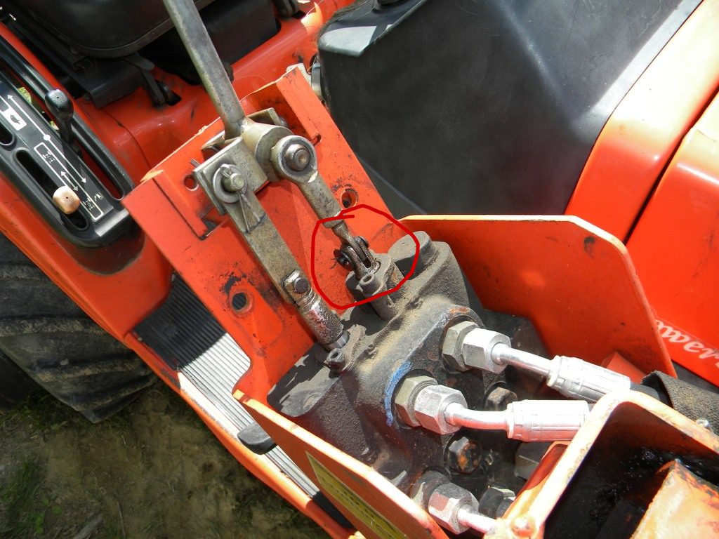

If you disconnect the linkage at circled area you will be able to find out if it is the joystick or inside the valveView attachment 758774
I did this and still cannot get the rod in the manifold to pull out. With the cover out of the way I was, however, able to move the rod inward and back about 1/4". I tried this with the engine running and it had no effect on the loader movement. I also rotated the the rod around and it turned freely. I have a sinking feeling that I have internal manifold issues.

Yes, it appears to be locked in the float position. One way to try to unlock it is to sharply hit the lever in the raise direction. This should "pop" it out of float. If not, you will need to remove the spool and disassemble the detent assembly, being careful not to lose the balls. Clean it up and reassemble.

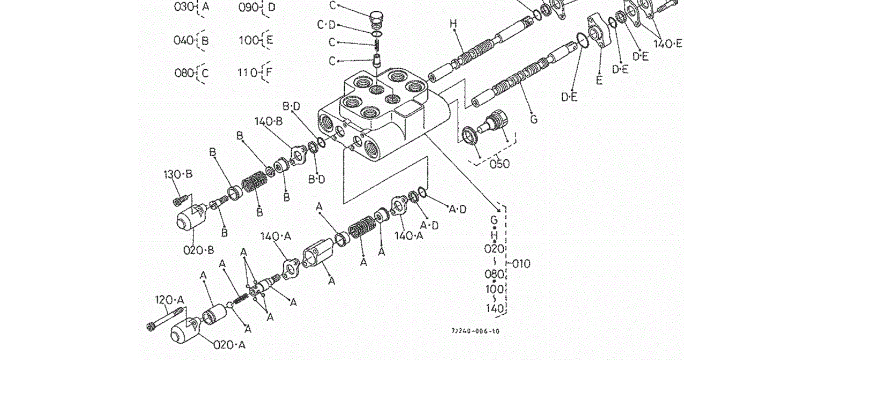

Item "A" and "020-A" are pretty much the detent portion. There 4 small balls and 1 larger ball at the end of the small spring. these all go in the inside of a sleeve. Items from "140-A" to the left are the detent itself.
I spent a few years as a quality control engineer and one of the places I covered was a hydraulics equipment manufacturer. As such I have always hated to beat on anything having to do with hydraulics controls, especially manifolds. But, I thought, what the heck. There's nothing external to this unit that I can do to fix it. So, I took your advice and gave it lone sharp, but not to hard, blow with a brass headed hammer. It worked!! I found that I can still get it stuck if I go too far with the control arm, but ,after I reinstalled the cover, it can't go that far and the loader works fine so far.
