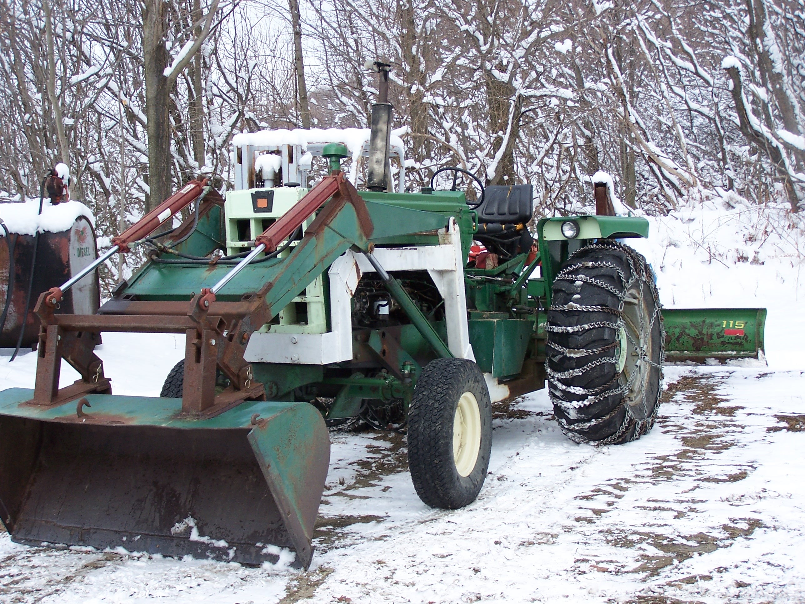

the Oliver 1550 utility with 2 link spaced ladder chains,

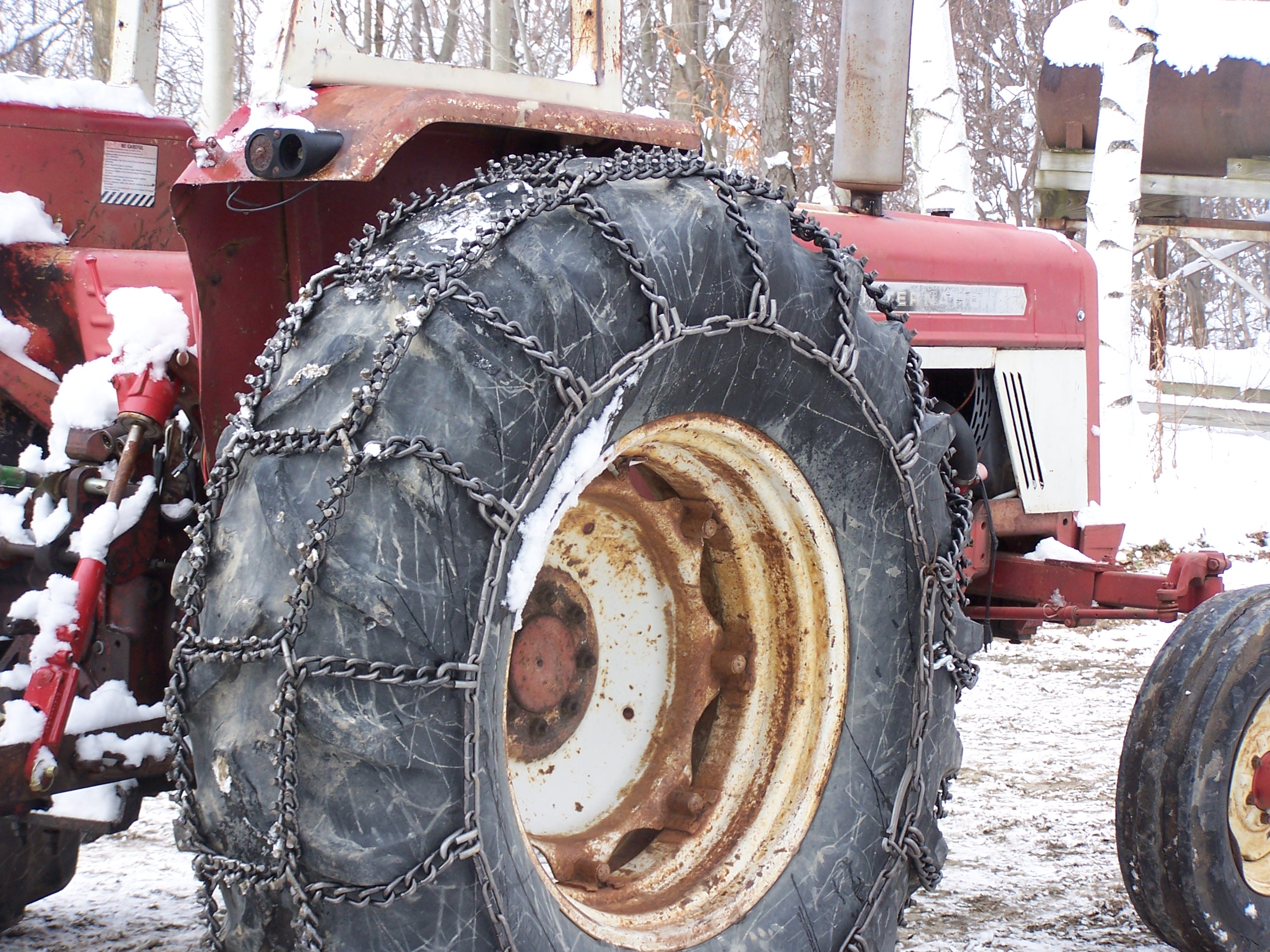

the 574 with talons, ( the 574 is about a 1000 to 1500 pounds lighter on the rear axle then the Oliver)

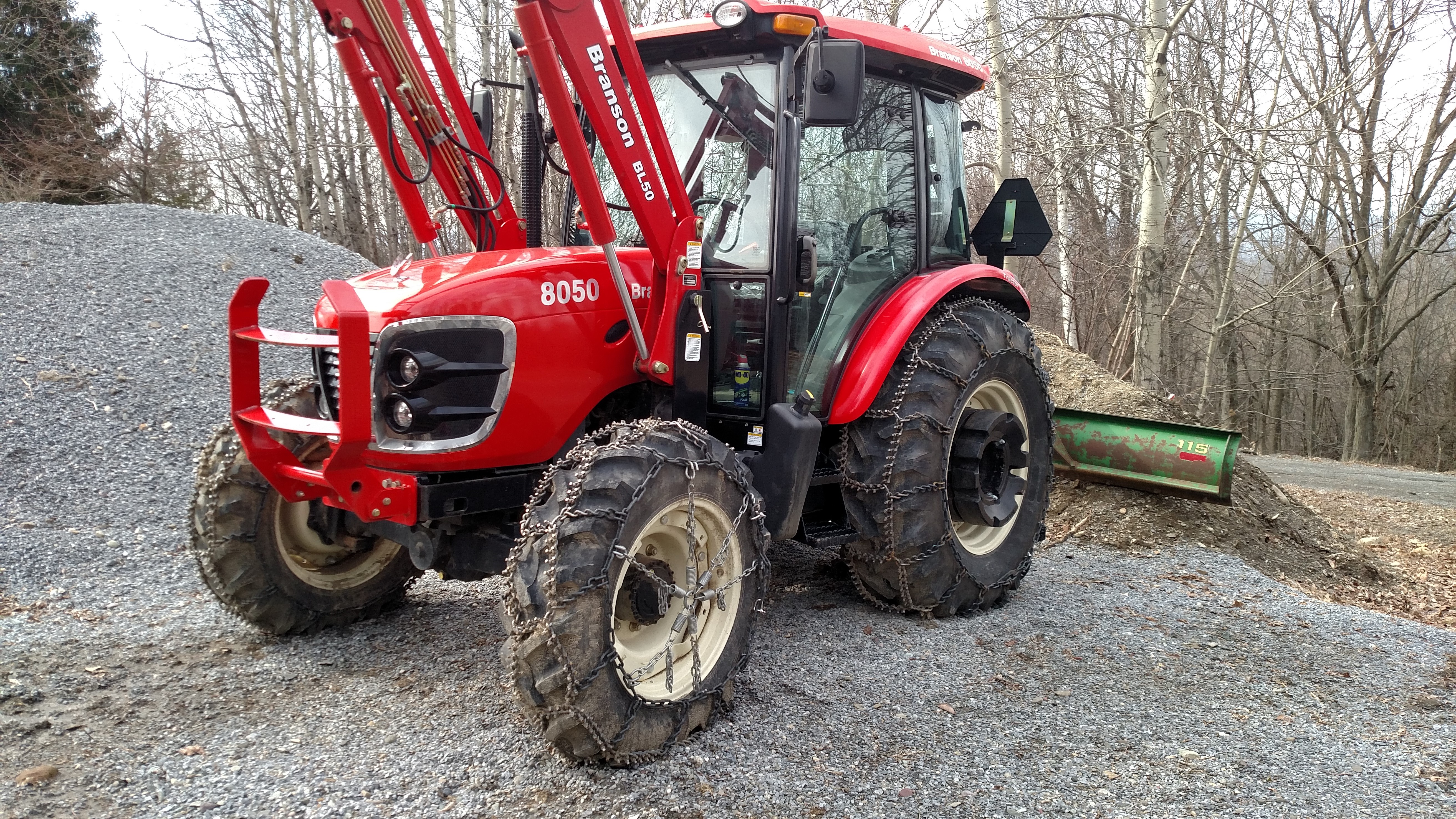

the 8050 with Talons rear, and OFA's front

Yes they do cost more, no question about it.
The greater traction is amazing as is the ride.
I also believe that they will do less damage to paved driveways as you are much less likely to spin with them.
