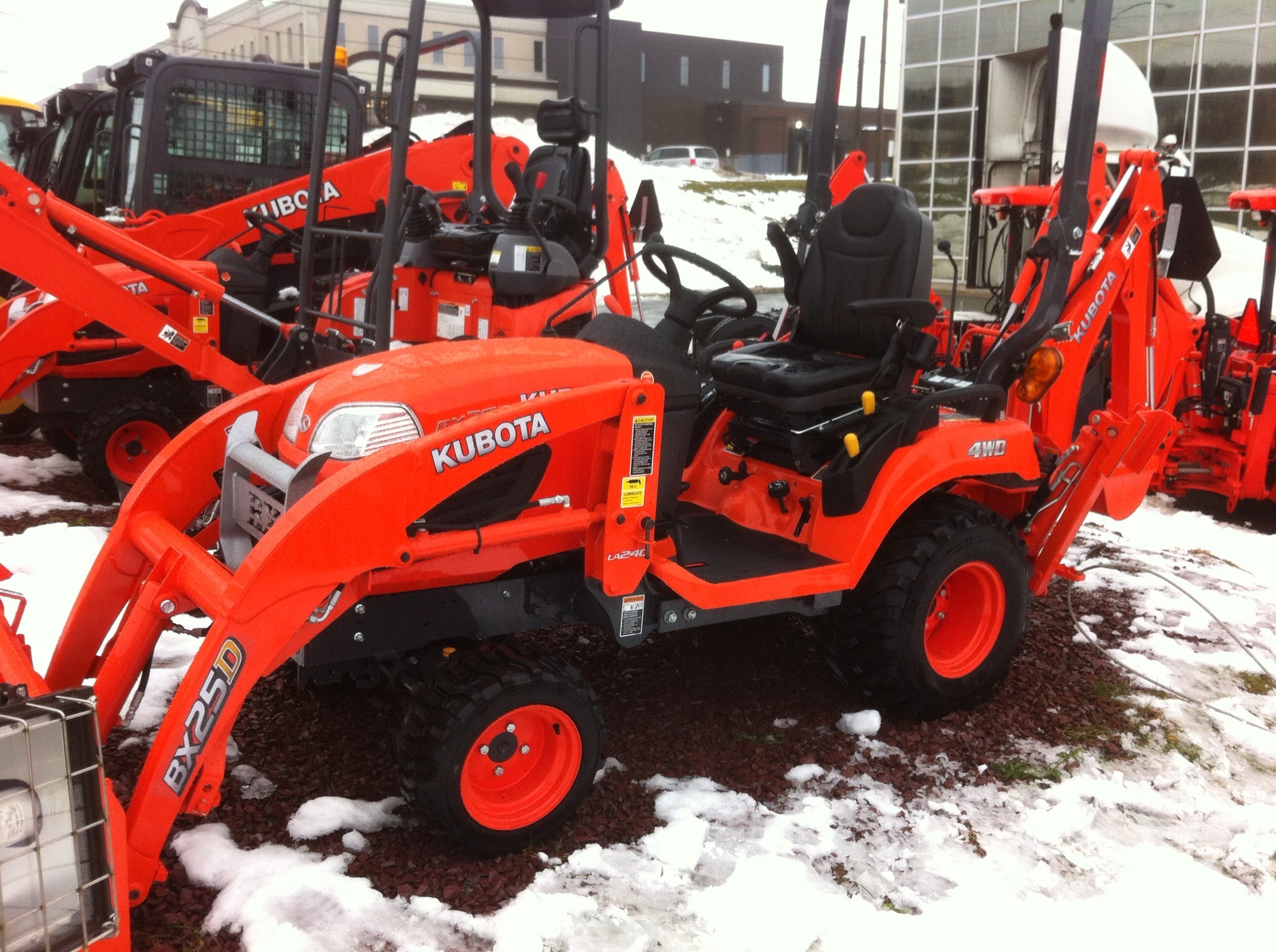

That looks more like powder coat than paint. I despise powder coating. I was looking at the BX25D today when I was in the city. Actually thinking about getting one. Wish it wasn't raining so hard at the time. :mad:

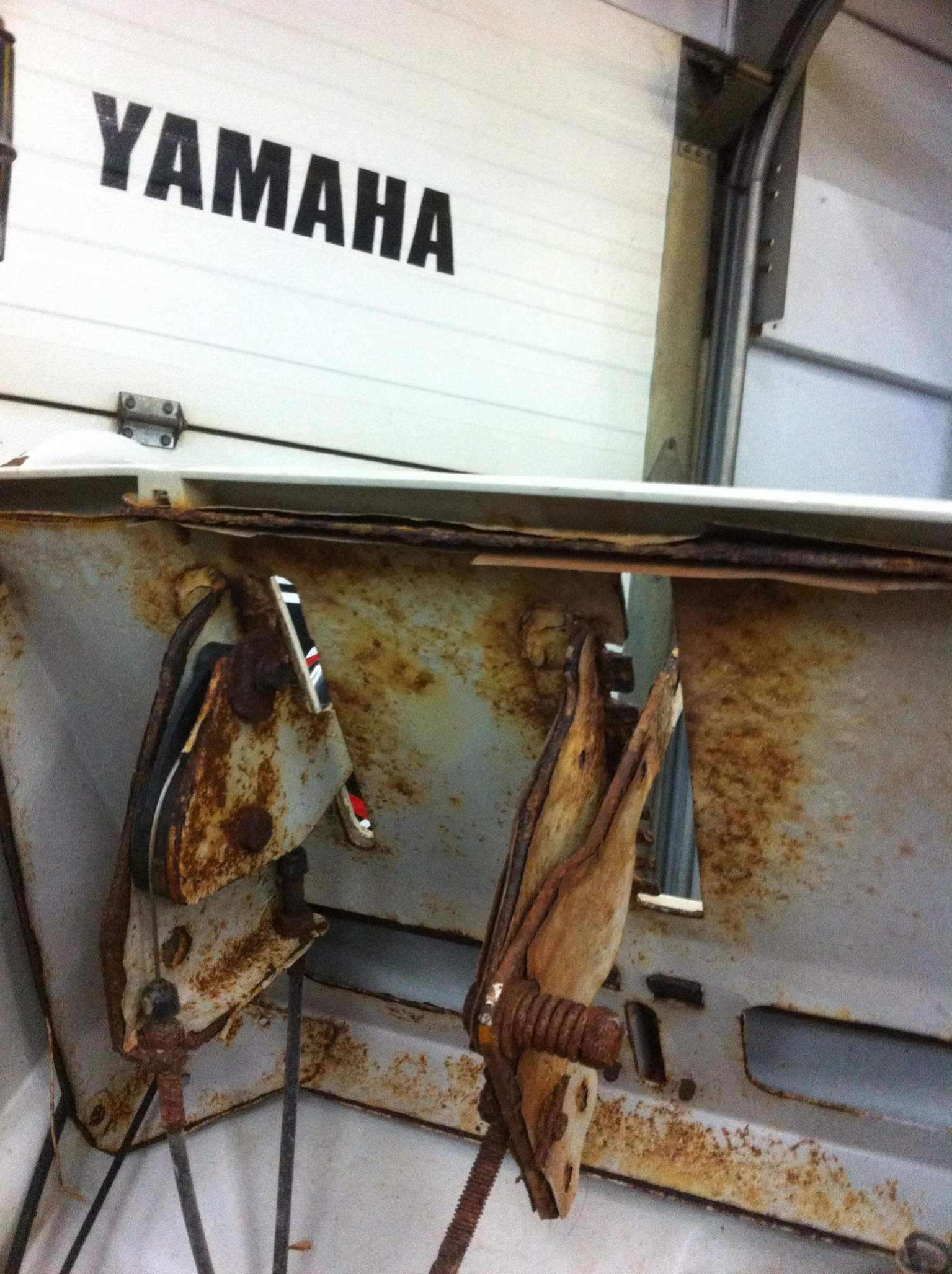

Powder coating is GARBAGE! Used because its cheep and fast during the manufacturing process. No primer used or needed to apply. The only thing thats not powder coated on the Grand L's FEL is the cylinders and I've seen plenty of them around here peel. I have tooling and equipment here and lots of it most of which is either US/Canadian made and my equipment is very well cared for because I make my living with it and in all cases the powder coating failed. It peeled off in sheets. Yes in all cases. It's undiluted garbage. In some cases I've removed the powder coating and applied primer and paint via spray gun and never had an issue after.
I've heard people say its good IF its "applied right " well EVERYTHING I have here and none of it have been applied right because its all peeled.
I've seen a BX 1800 here at my shop that I've converted into an ice resurfacer. The hood peeled, the floor board peeled and it was on there 1/8th thick. I've seen a BX 2200 do the same. I remember the 3rd function cover on my less than 200 hour Kubota GL4240 peeling and having to get the powder coating off and repaint it. I have vehicle hoists, tire changers and snowblowers here I seen the same way. Powder coating is either garbage or EVERYTHING I have here has had it applied wrong and i doubt that very much. :mad:
Pictured is a Canadian built snow blower I had in the shop last week. Look at the powder coating on that! Yes its an extreme case and Yes it's a 6 year old unit BUT this is what happens when it do peel and not dealt with.....
