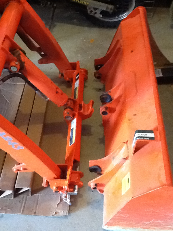

Very simple 15 minute job to put the QA on; it fit perfectly. I did look at the new loaders briefly and didn't notice any difference, but again, I didn't examine it too closely.

Its very simple to switch over. I have a different brand QA but really its pretty much unbolt 3 small bolts, drive out bucket pins, line up QA to FEL arms and tap in the pins to attach QA. Replace safety bolts and you are good to go. You will need a second set of pins for the bucket but that is just as easy. Okay it may take you 20 min if you need to look for tools.LOL
Give it a try you will love having a QA.

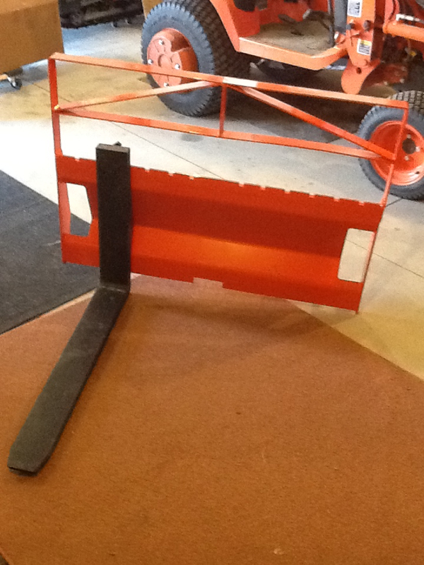

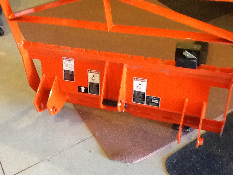

Kubota has a factory made QA for $275. I got one a week ago. It took under 30 minutes to put on. I did forget to order another Pin 3 for my bucket. I also got the Kubota fork carriage and 32" formed forks. The warning sticker on the fork carriage says that max lift capacity is 310lbs. With the bucket( no QA on) it says max lift is 518lbs. I haven't had a chance to try it out as ther is still so much snow on the ground here.

I was looking at the Kubota forks on the "Build" portion of the Kubota site for a BX25 and didn't find much info, other than $338 for the K9184 32" pallet forks. No pics or other info, and I couldn't find anything with a web search either.
Would it be possible to take a pic or two of your pallet fork set-up and post 'em?
/ Kubota BX25D / BX70? #372
Here are some quick pics. I just put one fork on. From the last pic you can see why I haven't had it out
/ Kubota BX25D / BX70? #373
Thanks Van. :thumbsup: Do you have any idea if the $338 on the Kubota site if for everything, or just the forks? Thanks.
/ Kubota BX25D / BX70? #374
QA is $275. Both carriage and forks is $900. Not the cheapest option, but this is going to make setting boulder walls easier.
The QA should have come with a pin, mine did. Did you get the arrow sticker? Mine did not come with it, so the dealer is ordering one.
Do you have a way of weighing the forks assemble? I would be interest in what the Kubota forks weigh.
/ Kubota BX25D / BX70? #377
The carriage has a sticker that says it's 90lbs. I don't have a scale. The forks are 32". Each one feels as heavy as the carriage. I'm going to guess 80lbs each. I'm curious about the exact weight, I may have to buy a scale.
