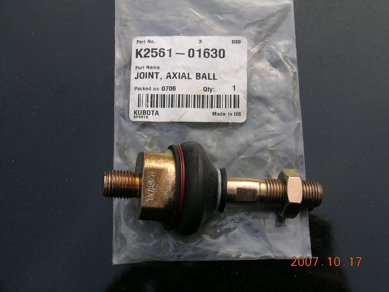

I tore mine on a BX23. It looks like the same set-up, probably just smaller. I don't think it is difficult, as it will unscrew without removing anything, if it the same design. see pic of part.
   / Kubota Dust Cover Replacement Advice #6
Pricey little part, I replaced one of mine that had been torn for about 4 yrs. and had become loose in the joint, only hard part was finding an old wrench to grind down thin enough to hold the steering cylinder while I unscrewed the culprit. The other side had a small tear so I covered it with a piece of bicycle innertube and wire ties before it got dirt in it, hope I can prolong the replacement of that one.
