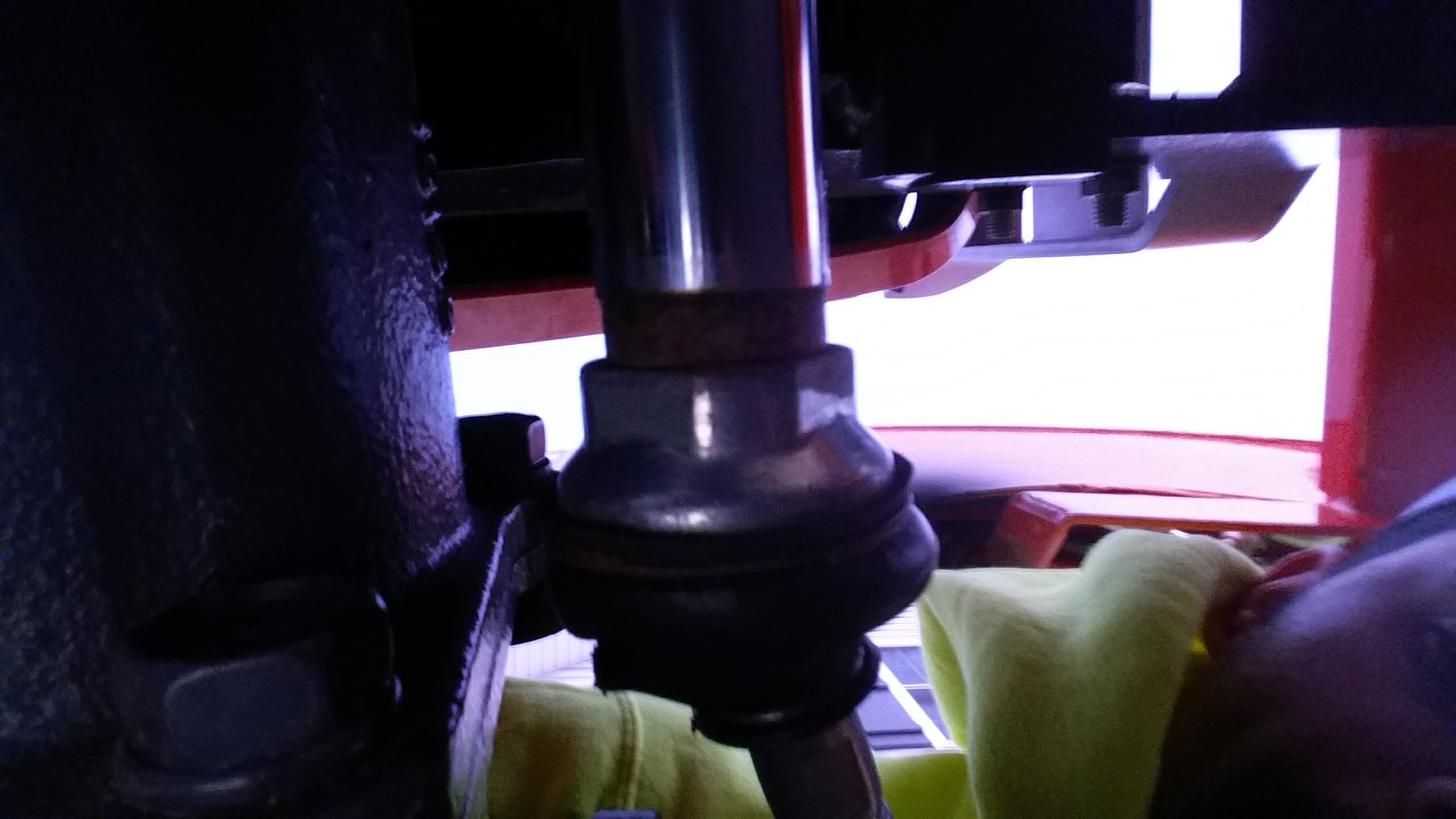

Hello All
I know that this is an old thread but I was wonder if we could revisit this issue. Any advice on changing the dust cover. If I need a jack, tools, etc. Also, approximation on how long it would take?
Since I am new to this, any advice on keeping my kubota BX 25 (purchased in 2011) in prime shape. I store it outside but will eventually get it inside once I have the money to build it something. I do the 10 working hour grease up and changed the oil once since I had it. My wife would say that the house is the best thing we have and I would say the tractor. :)
Thanks in advance for any help on this
Roberto
   / Kubota Dust Cover Replacement Advice #16
Your tractor is practically new so the tie rod should come out fairly easy. Just back the nut off and hit upward with a hammer using a block of wood on the nut. If that doesn't work, see post #4. Good luck.

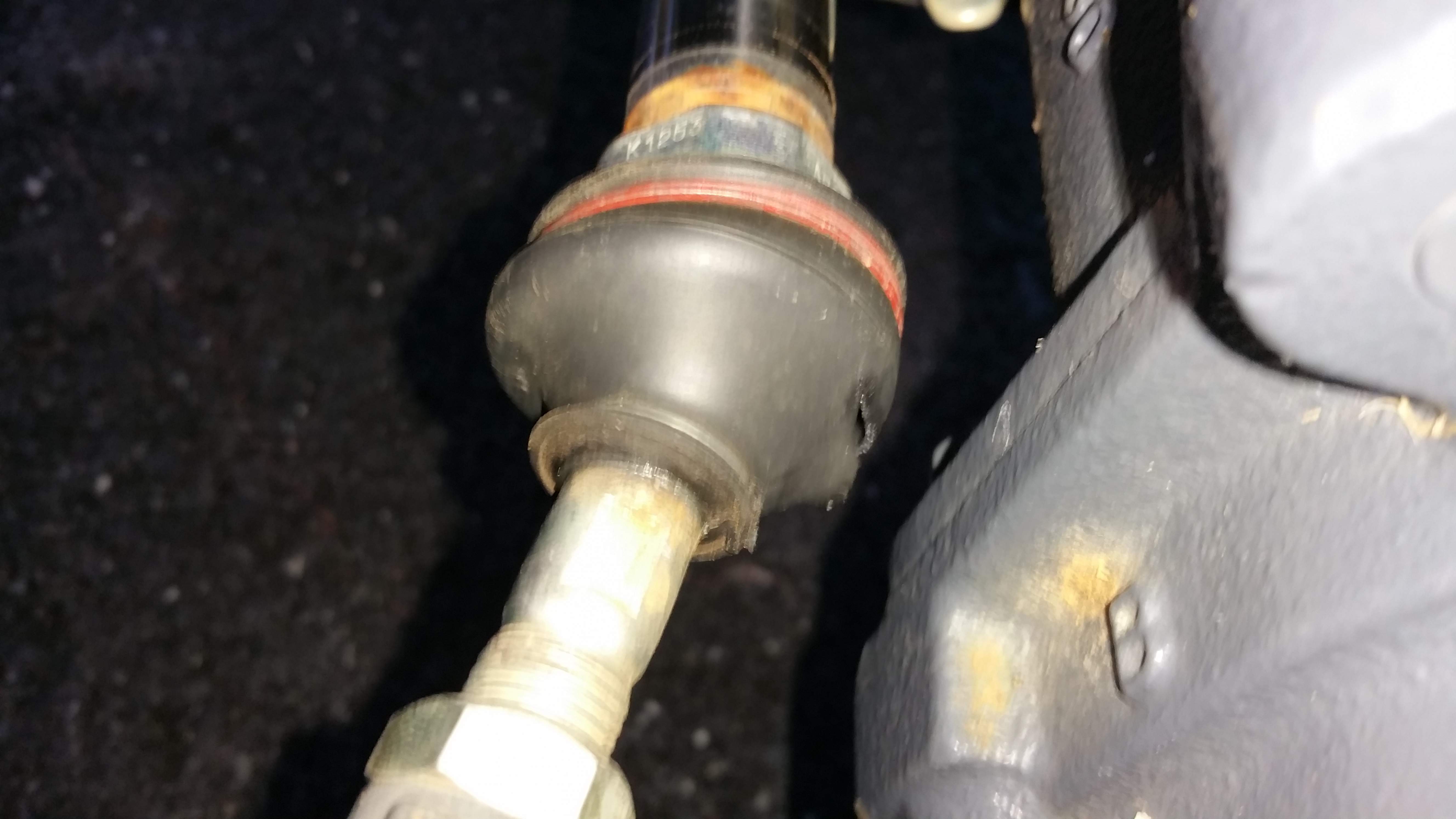

Hello All
View attachment 408677View attachment 408678
Roberto
If your dealer is like most, you will be told it can't be done with just new boots, replaced the set on mine because of this, here is a good thread that should help: http://www.tractorbynet.com/forums/parts-repairs/310869-replacing-bx24-tie-rod-boot.html#post3757492
   / Kubota Dust Cover Replacement Advice #18
Thanks for the info in the link, when I replaced mine, I had to replace the joint as well. Price is ridiculous for such a little hunk of metal and not much tougher rubber than a condom.:eek:
