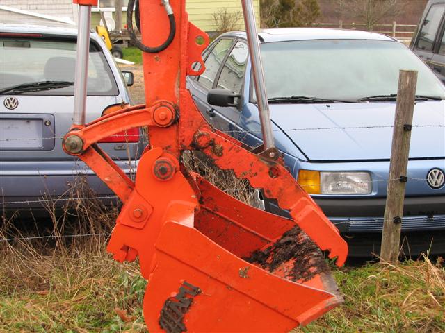

Here are a couple of pic's of my hydraulic recently modified thumb. When I added the QA the thumb was about 6" too short and would just go inside of the bucket. I added some stock to extend the thumb, but also had to widen it as well. The new 16" bucket had the teeth in a different configuration and I had to add a couple of inches to the width so it would go between the teeth or catch the cutting edge of my three buckets. If you also notice the gold coloured pin with the grab handle that I use to keep the thumb from creeping down over time. When I need to use the thumb I just pull the pin.

Here are a couple of pic's of my new H&H quick attach. The quick attach hooks its two bosses on to a couple of hooks on the bucket and then the other end lowers down and is secured by a wedge and bolt. At present it appears easy to change and tight. Time will tell how it holds up, but I am optimistic.

Nice modification on the thumb nobull.
I hope that QC system works for you. I'm not a fan of that. I haven't had good luck w/ it.
