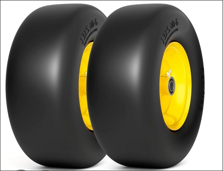

If I end up replacing the gauge wheel holder assemblies due to wear in my 72" deck, I would certainly convert to much larger diameter gauge wheels at the same time!
Maybe 13" or 15" OD solid rubber tires would do it?
