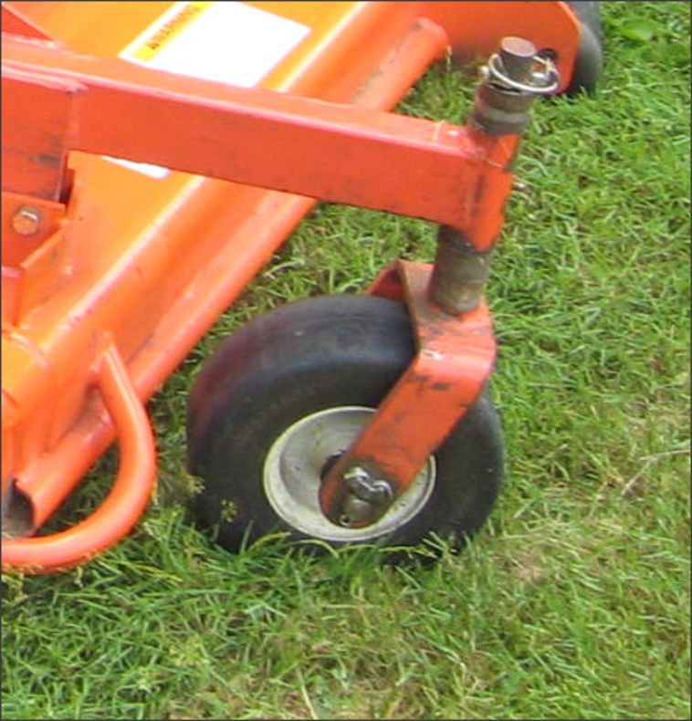

Here is a very good posting by johncar back in 2015 about replacing worn gauge wheel holder/assemblies in his F mower:
DIY replacing worn out gauge wheel assemblies Kubota F series

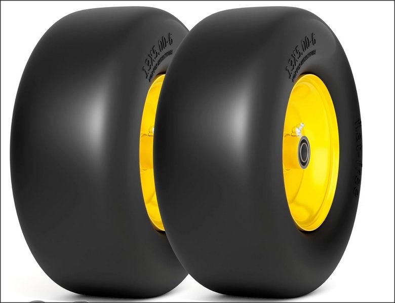

If I end up replacing the gauge wheel holder assemblies due to wear in my 72" deck, I would certainly convert to much larger diameter gauge wheels at the same time!
Maybe 13" solid rubber wheels:
THIS is what I need to do IF I buy a F mower (y)
Put some 15” front hard rubber tires from a ZD Zero on those bearing casters

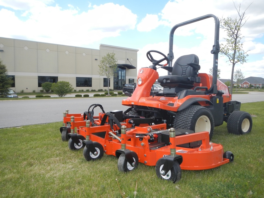

Heck, the Kubota WAM was my F-3680 with a 100” tri-deck.
Ain’t no big deal.

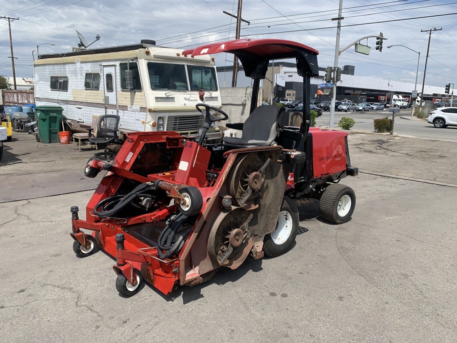

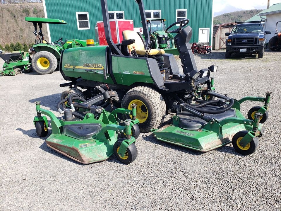

This JD WAM has really big leading & trailing wheels/tires that would fare much better on holes & bumps than a Kubota F’s tiny wheels.
Same with this Toro.
Looks like they both have air ride seats, too.
Even the Kubota F-3680 WAM 100” has bigger leading edge front wheels/tires…..
Ain’t no big deal.
Awwwwww
Prolly not a heated seat, neither? :ROFLMAO:
The gauge wheels in my F3060 72" Rd deck are 9" outside diameter.
Would you know how large are the wheels in the three mowers shown in you photos?
