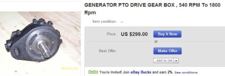

Here is the gearbox. I run it backwards to get 540 from the 2000+ rpm mower PTO. Then use a Kill-O-Watt device to set mower throttle to get 60 Hz. My 22hp F-935 get s me at least 11kw if I'm too lazy to get the big JD out.

I've been considering a 4 pole generator head that would turn 1800 rpm for lighter load days rather then the tractor on the 25 kw pto unit.
But that 3-1 gear box would be nice also.

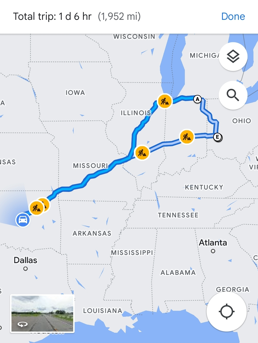

What a journey! This has to be some kind of F series record, 2,000 miles and museum visit lol
   / Kubota F2880 Out Front Mower #25
You have company. I have purchased quite a few things “long distance”. As long as the shipping doesn’t kill the deal and you can feel satisfied it’s not loaded with problems mechanically, its fine.

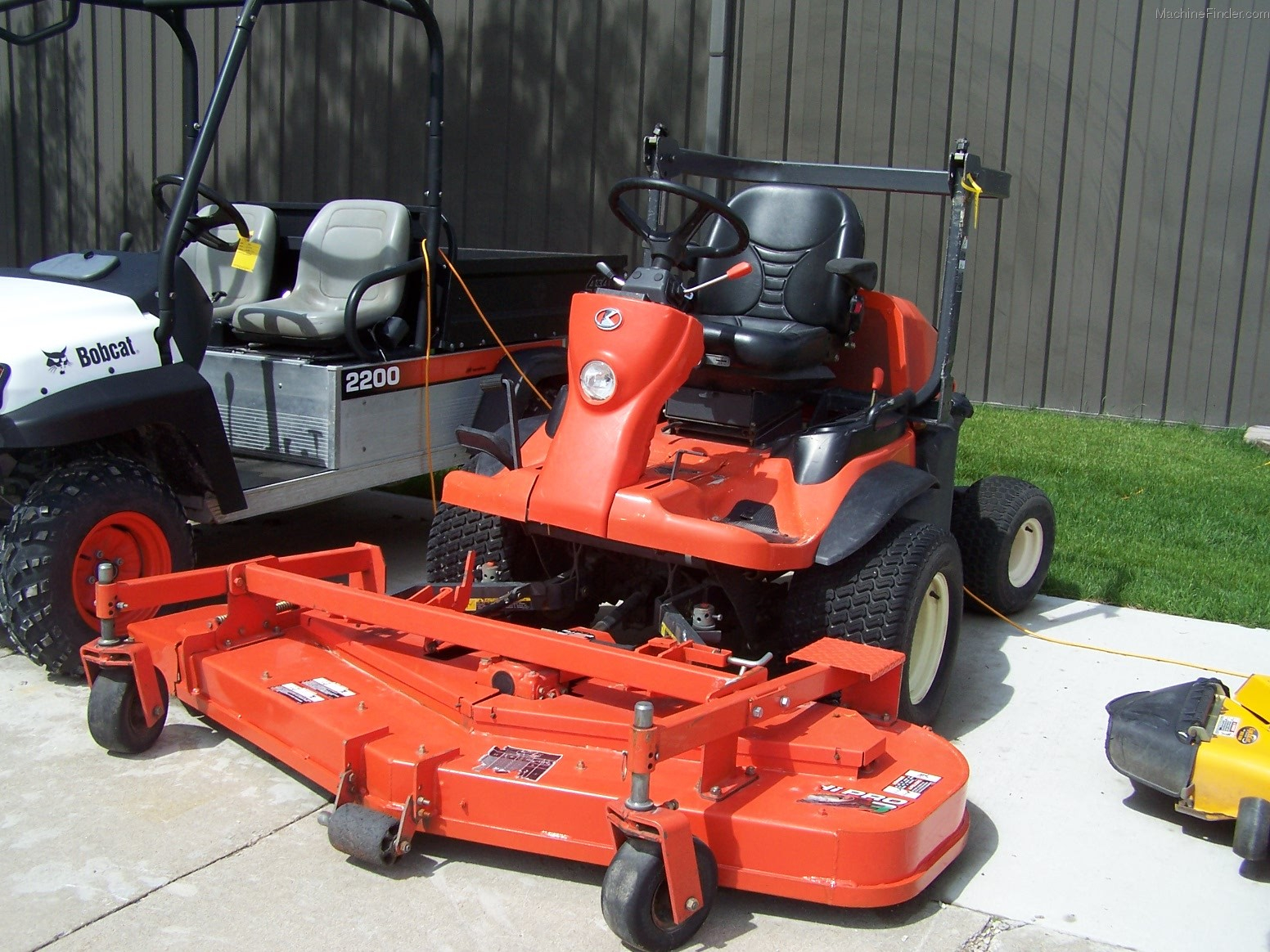

I have a 3680, it came from Iowa 13 years ago and I gave 10.7 grand for it with 545 hours. It is an '07 model. It now has like 1,400 hours.
The worst that has happened is someone (hired hand) didn't grease the pto shaft slide splines and the stress wiped out the mower gear box; nearly a grand in parts. Same person also dinged up the front of the foot pan, broke a light, broke the glass of the temp gauge, broke the engine cover grille, broke the plastic steering covers when broke the headlight etc. He became unaffordable.
There are some zerks that are just downright hard to get to and they are underneath. So here is the list of be awares:
1. When you turn watch out for barb wire, the sidewalls are paper thin and I have lots of plugs that should be inside patches
2. Grease it all at least every tank of fuel. You may need a few angle zerks to help yourself.
3. The bellville cup washers wear out. I found after market ones this year from an outfit on Amazon but they seem too ductile. Figure on replacing those about every two years.
4. Keep an extra belt
5. Ninja blades are not worth the trouble. I mow 2 to 3 acres a week and replace about every two years so I now have a stack of used blades. I buy them in bulk every few years
6. Roughest riding machine on the place. I will try replacing the seat suspension soon. Keep the front tires between 10 and 15 psi to help yourself
7. I have had to replace the casters on front and back
8. Rebuilt the spindles and replaced all mower shaft seals this year. The gearbox sprung a leak. I used generic seals and got all of them for about the price of two or three Kubota seals. Seals are seals if they fit. Ditto for bearings. Again, I got an aftermarket kit for all three spindles for about $100, nearly the same price as one spindle kit from Kubota. It runs a whole lot better now as I also replaced one pulley that had wallowed out somehow.
9. Old Kubota paint turns Pinkish in time even if you keep the machine in the barn like I do.
10. Blow it clean with a leaf blower when you are finished mowing.
11. The things are heavy so don't go mudding.
12. I run without the belt covers or discharge chute. Just too much grass and junk get beneath them.
13. I had difficulty finding a battery around here that fit properly.
