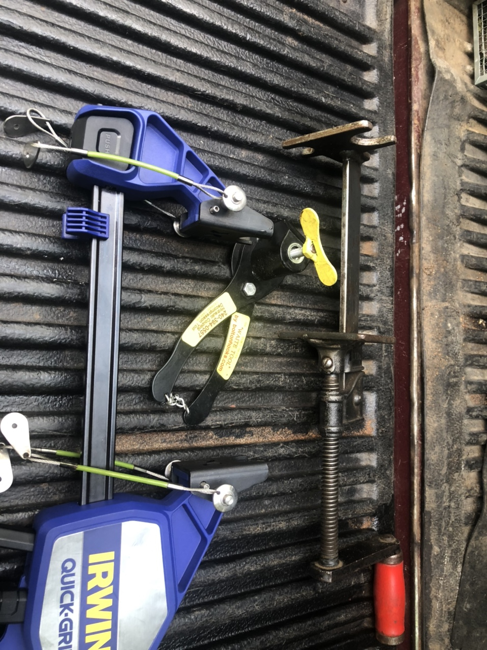

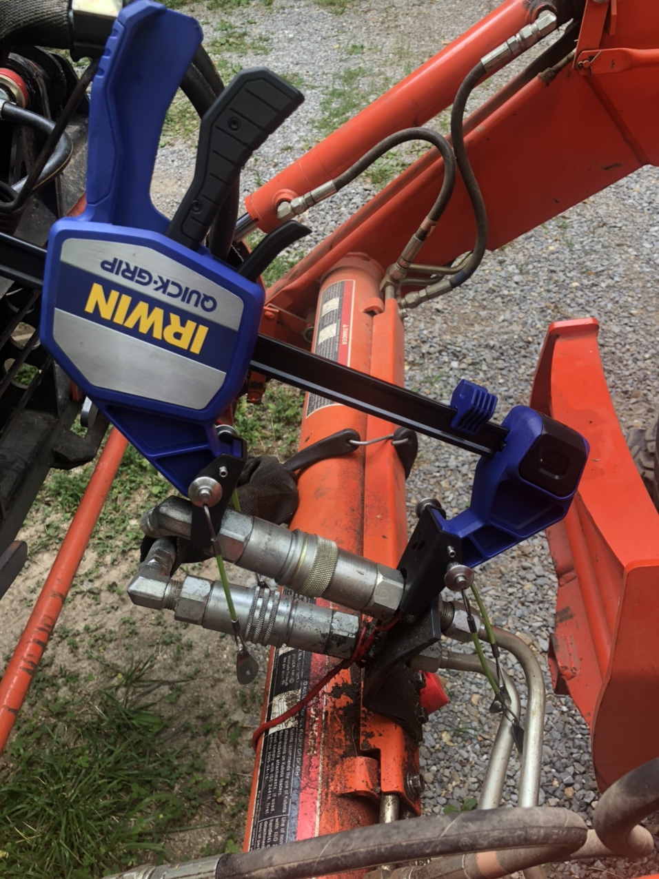

Normally I would agree with you. But that doesn't seem to be the case for me. I'm careful to relieve all pressure before I disconnect and before I re-connect. It doesn't seem to matter. I know this because after disconnect anything, just for grins, I peridically re-connect them (tractor is still off). They snap right on with zero resistance. So there isn't inherent pressure. But let me tell you - when I go to reconnet. . . impossible. I have to crack a fitting every single time. It's incredibly annoying.

3 options
1. buy one of them clamp tools
2. Change them out to AG style (iso 5675) couplers that you can manually relieve by popping the poppet or ball
3. Change them to flatface that are designed to connect under pressure.
