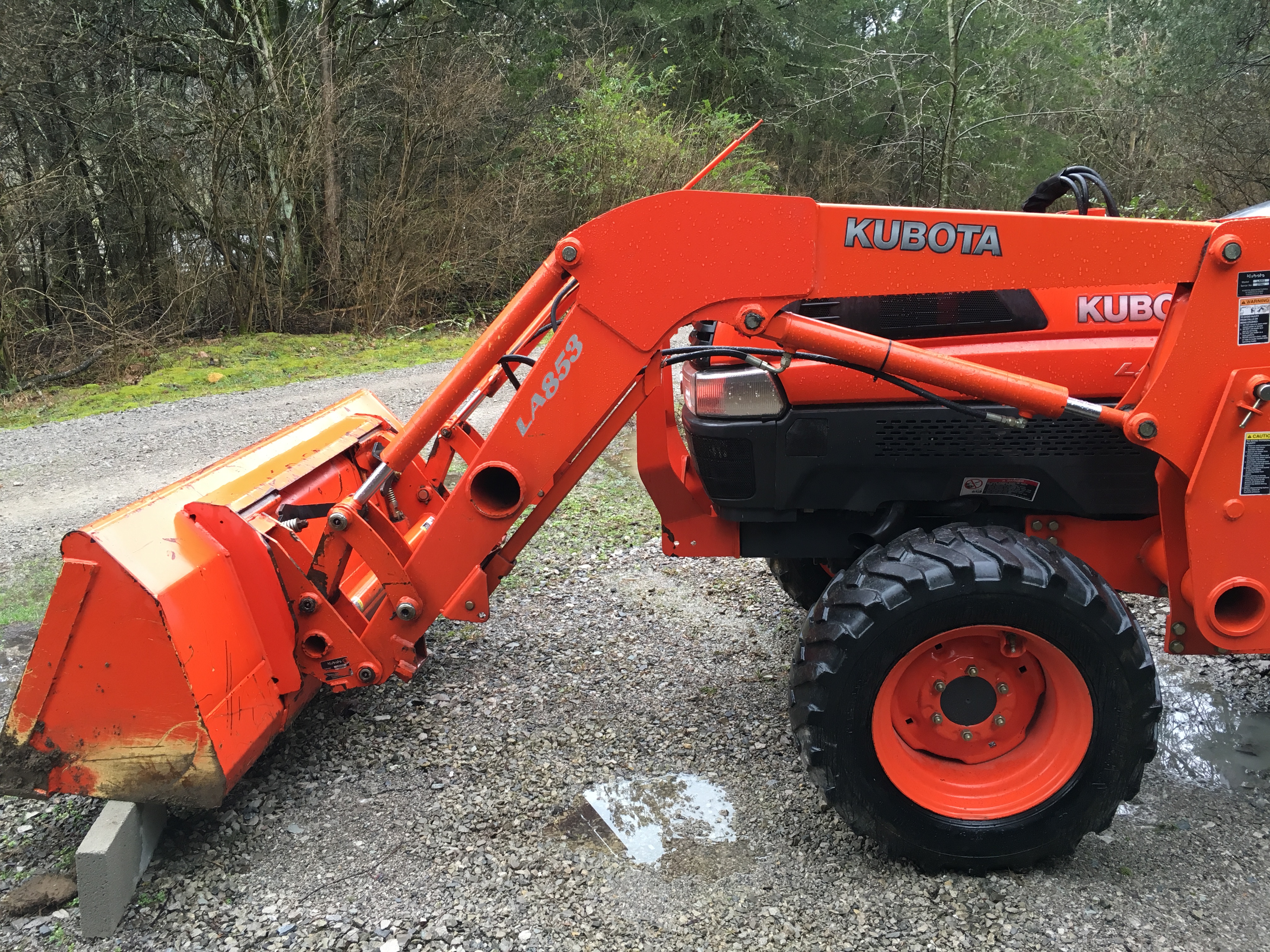

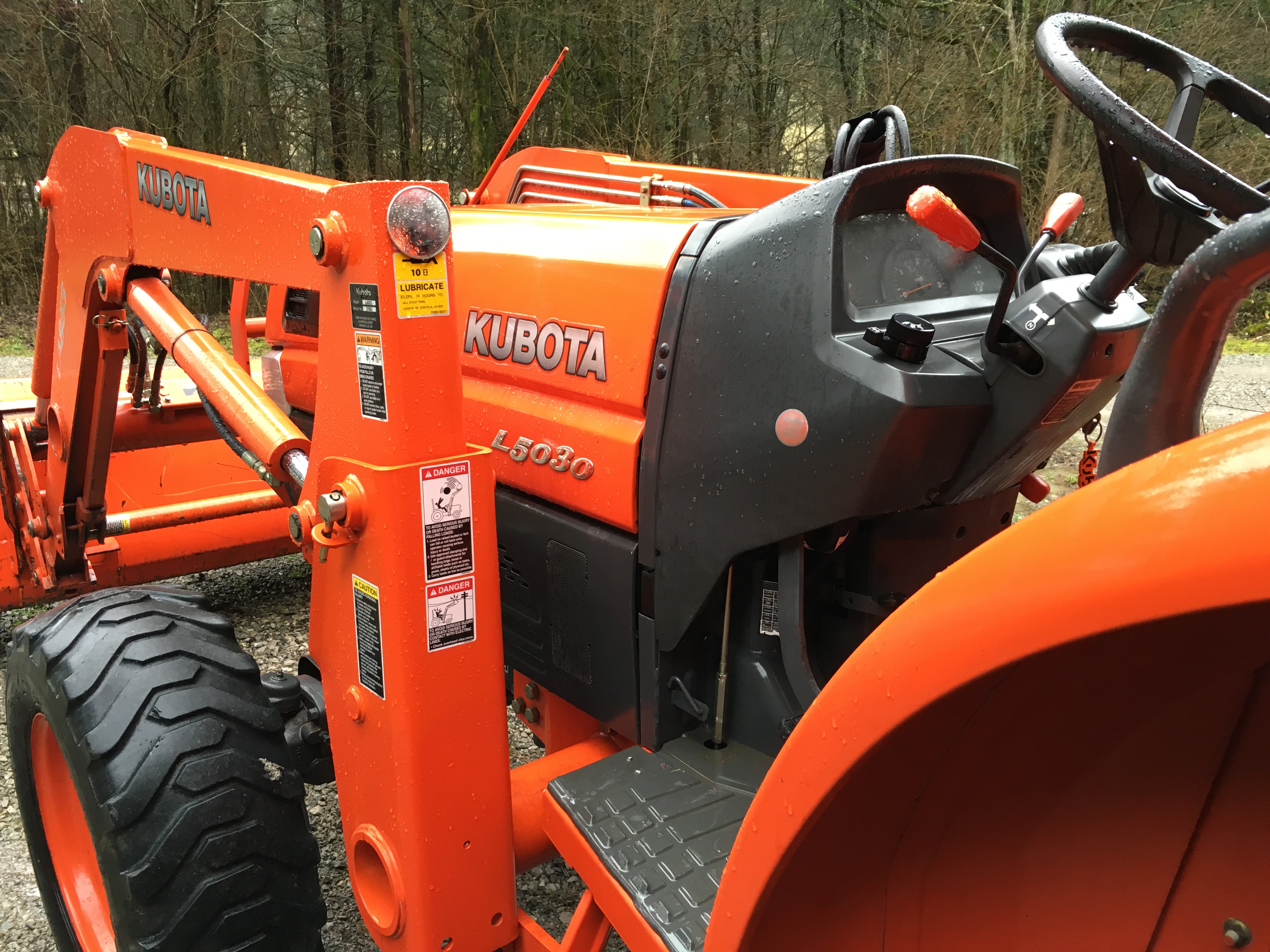

OK, my bad. My tractor is L5030 and the loader is LA853. Sorry.

That's a nice looking tractor. Mine only acted funny when the hoses weren't hooked up right. I unhooked all of them then hooked them up again, I took the loader off frequently; sounds like yours is something else.

I just had the same problem with a friend's L4200. It turned out to be the 3-point hitch adjustment. If you lowered the 3-point a little the FEL would work fine. Adjusted that and no more problem. Worth looking at.
   / Kubota Front Loader LA953 acting strange #14
Check to make sure the 3-pt hitch isn't pegged and putting the system into relief.

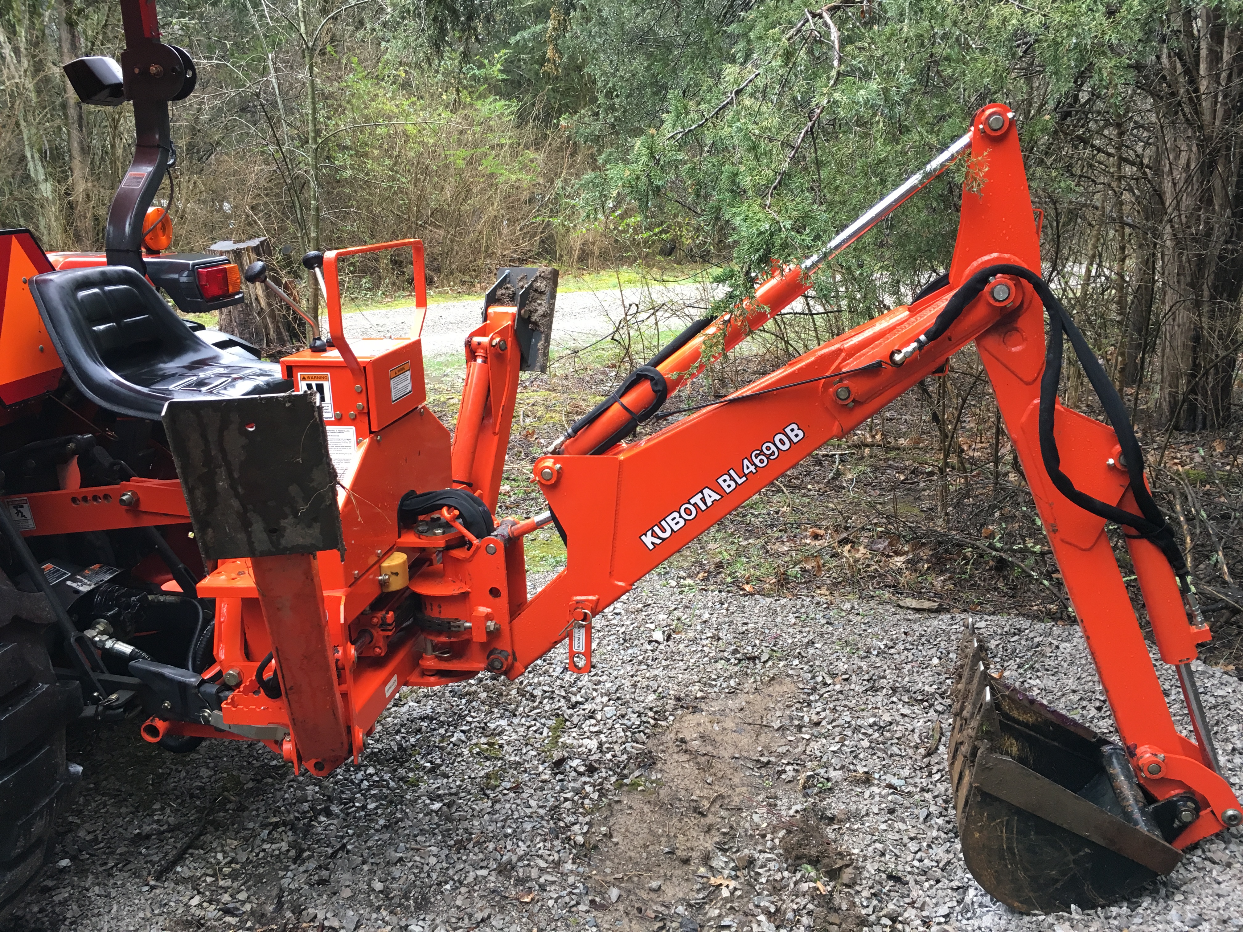

That would definitely be something that could have started when you hooked up and lifted the backhoe.
The 3-pt is last in line to the tank -- taking PB flow from the loader. But if it's being pegged in a lift setting, it will mess up the loader functions.

3-pt hitch it was! It was set at the highest position, and lowering it completely solved the problem with the FEL.

OK, so if that tractor has position control, which I believe, that means you need to adjust the rod/stop that cuts off the hydraulics when in the "up" position.
But first, I'd run it without the backhoe on to make sure the backhoe wasn't interfering with the 3-pt getting to the up position. If it does, use a knob or stopper on the 3-pt lever to prevent you from trying to raise the 3-pt all the way up when the backhoe is on.
Some tractors will have a flip-down lockout to prevent the 3-pt from being raised above a certain point when a backhoe is attached.
If this tractor doesn't have position control, then check the 3-pt lever linkages to make sure it's not sticking in the up position, and again make sure the backhoe isn't blocking travel.
