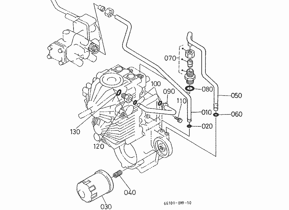

I've noticed a number of G1900 owners complaining that there mower was slow to get moving - took a while to get the hydrostat warmed up and moving. Reverse was slower to respond than forward. I had this same problem. One observation I made - when the hydrostat was acting up, the fluid on the dipstick was creamy/milky (full of air - not condensation).
Just wanted you to know that I repaired my Kubota G1900 hydrostat today, and it works great! I removed the seat, rear cover, and fuel tank to get to the hydrostat. On the top of the hydrostat, I noticed a very small hydraulic leak at the suction connection. The connection is just an o-ring in a groove in the pipe, pushed into a bore in the hydrostat. Actually a poor design - but it worked fine for 10 years
Drained the fluid, removed the pipe, and replaced 3 o-rings on it. It was sucking air through this leaking connection on top of the hydrostat. Put in new fluid and filter and away we went. Very responsive - like new.
This repair made my day!

Attached is a picture which includes the hydrostat tube I was referring to. The suction tube is on the right hand side of the schematic. It draws fluid through the suction screen at the bottom of the reservoir and delivers the fluid to a bore on the top of the hydrostat.

My G1900S (over 2000 hours with only regular maintenance) has been dripping hydraulic fluid from around the filter assembly for a year or so, and today it finally let loose (I happened to notice a trail after crossing the driveway). The leak appears to be from the bottom of pipe 010 in the diagram below, so the repair will presumably involve replacing O-ring 020 (and perhaps O-ring 060 for pipe 050 while I'm at it). Will removing the seat, rear cover, and fuel tank as described above provide the required access, or would it be wise to leave this one to a pro? Advice appreciated!
attachment.php
66101-36430 010 PIPE HST
04811-10090 020 O RING
66101-36444 050 PIPE HST
04811-10090 060 O RING
   / Kubota G1900 Hydrostat Problem Repaired #6
I gave it a shot this afternoon and things went smoothly. Pipe 010 was readily accessible after removing only the seat and rear cover, but pipe 050 would have been much trickier without removing the tank, so I held off on that one. I unscrewed the compression fitting, pulled out pipe 010, replaced broken O-ring 020, reinstalled the pipe, replaced the filter, topped off the fluid and found no leaks. Success!
