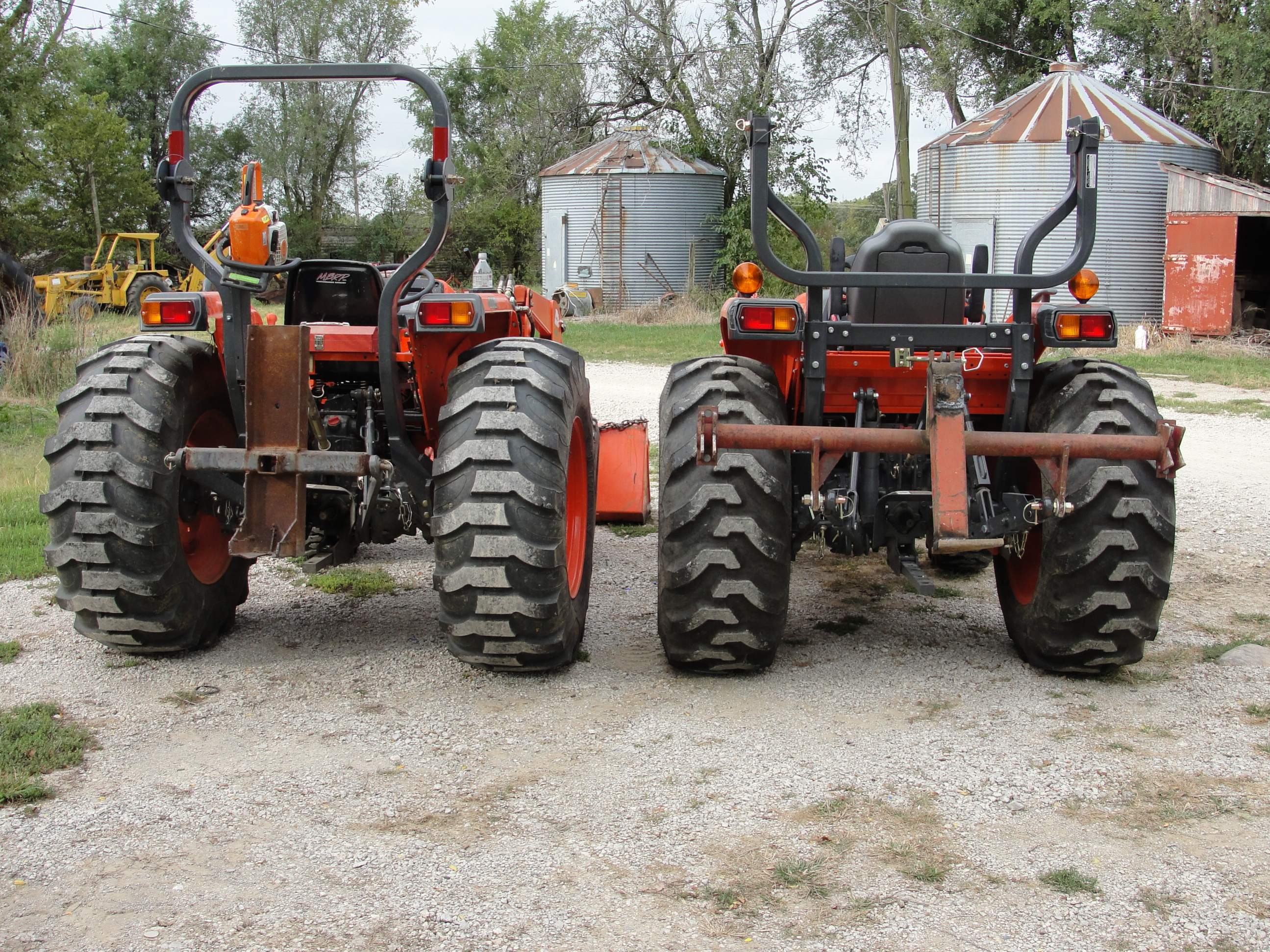

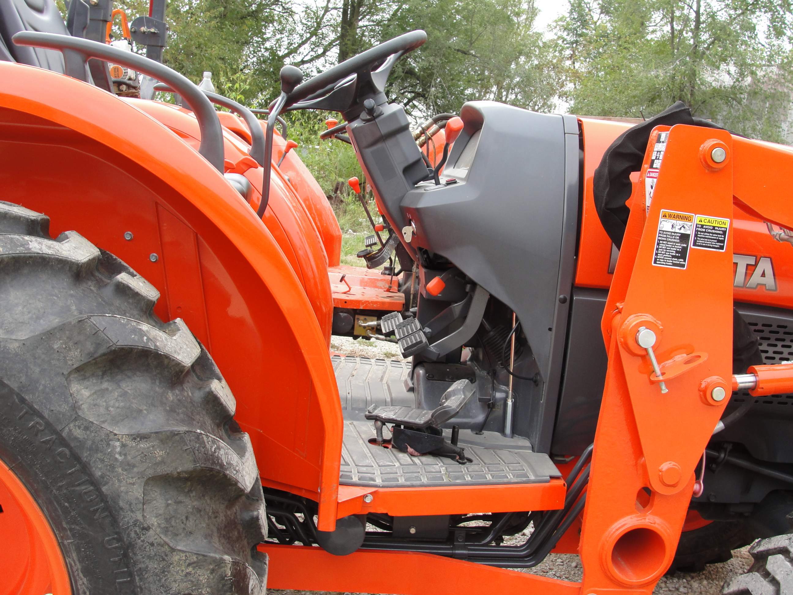

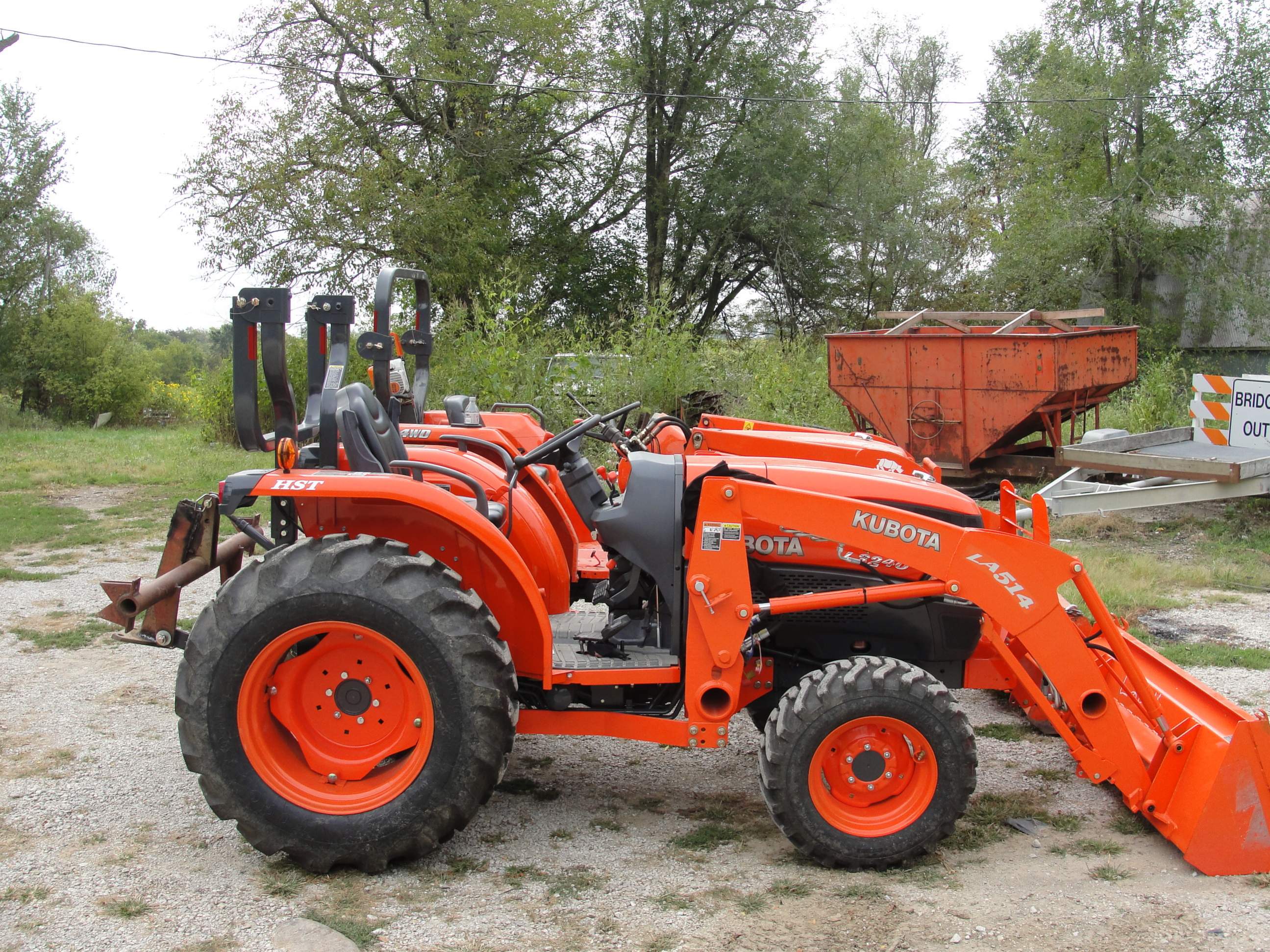

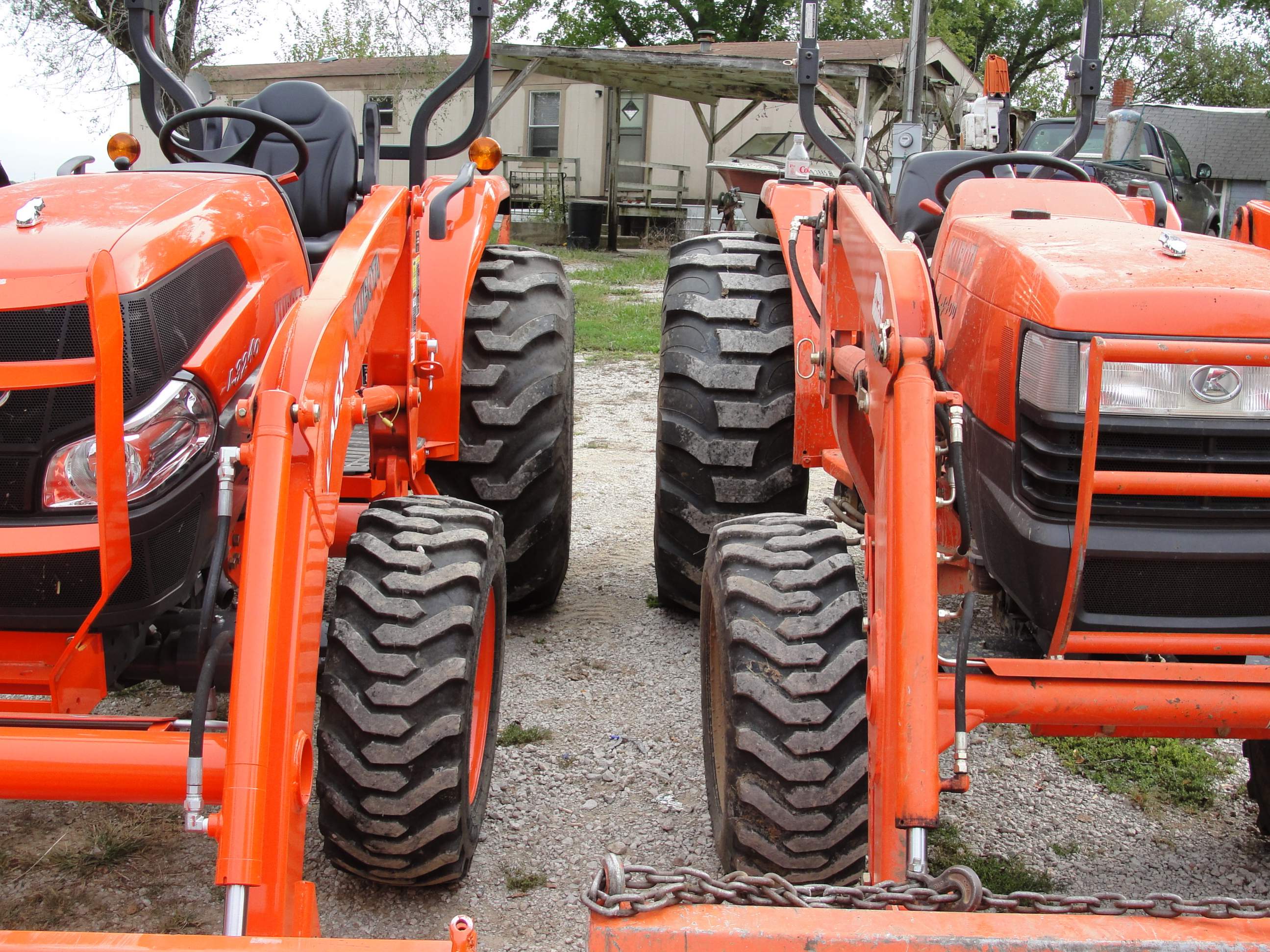

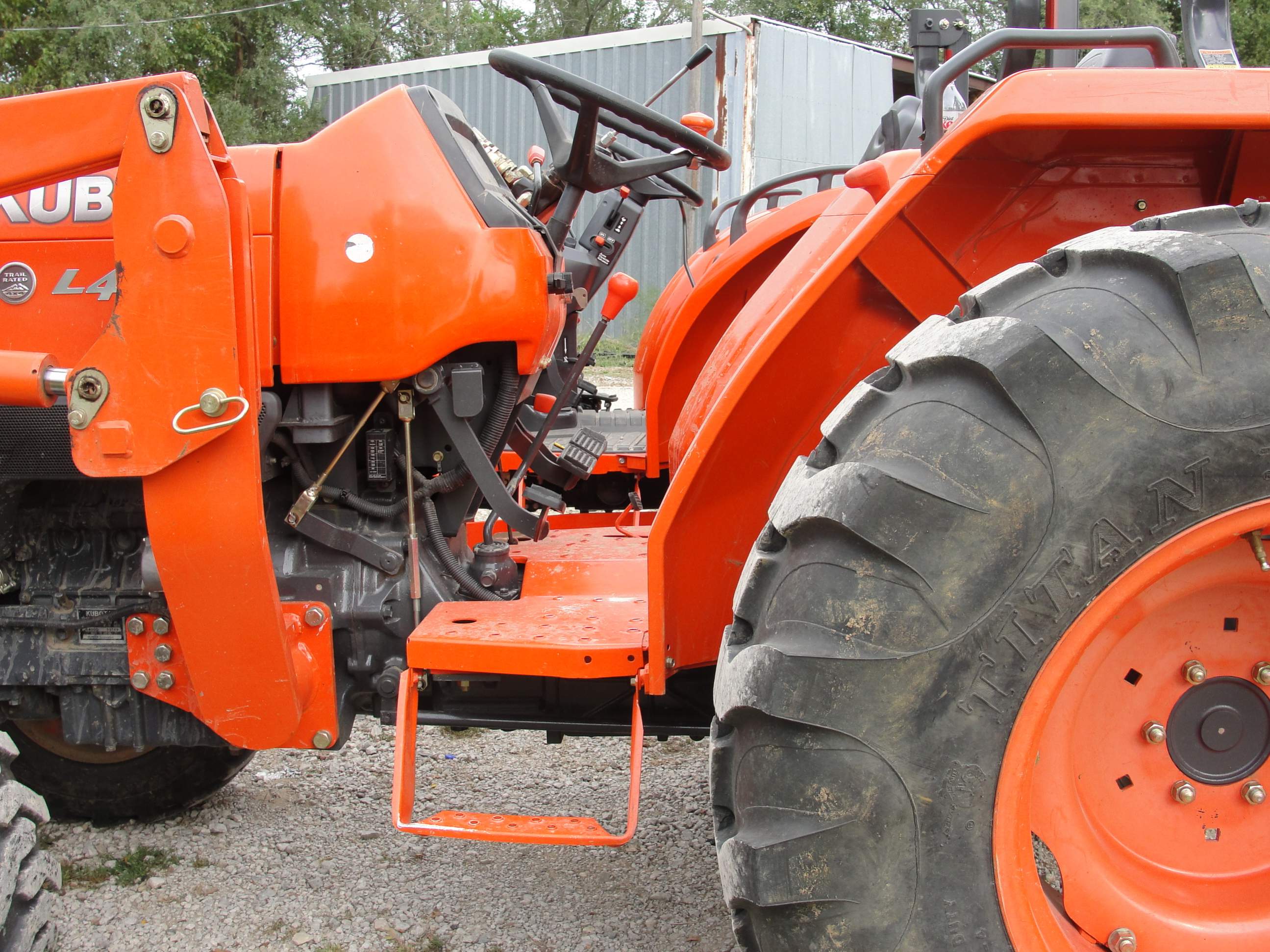

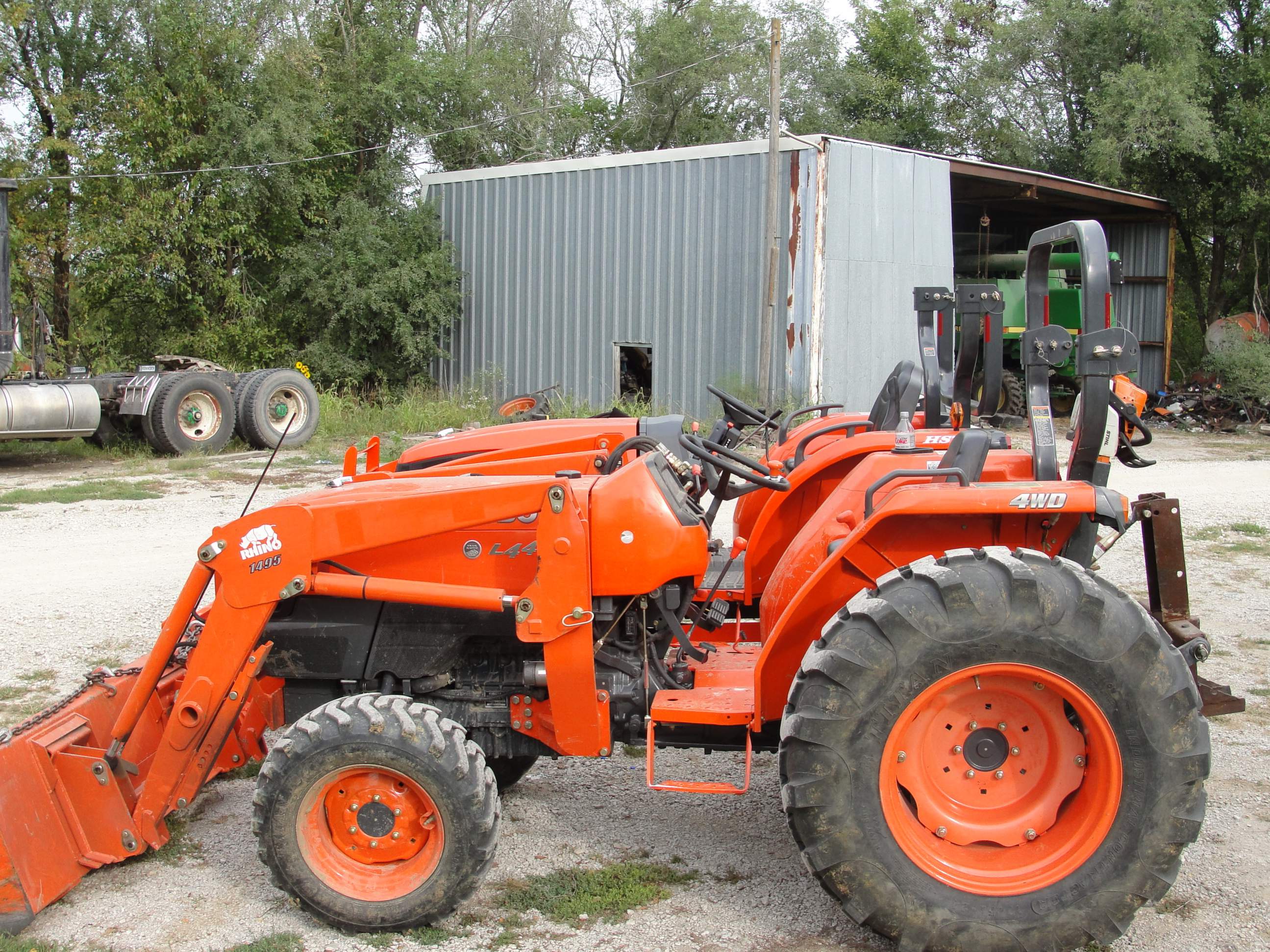

I've owned my L4400DT for 18 months. My Brother recently purchased an L3240. Both tractors have loaders.
So, my comparisons relate first to the difference in gear drive and HST. Both have their good points. Since you have already decided to go HST I won't waste your time talking about those.
My second comparisons are more related to your question. The Grand model has rubber floor mat, tilt steering wheel, wayyyyy better suspension seat and extendable 3pt arms. The comfort items, especially the tilt wheel are important. The extendable arms are almost a necessity if you use your 3pt a lot.
The chassis size of his 3240 and my 4400 are almost identical. The primary difference being different rear tire size. The 4240 might be a slightly longer wheelbase but the difference won't be much. lift capacities will be almost the same.
I'm not familiar with a 4400HST so can't answer questions about the HST+ features. What I mean is I'm not sure those + features are available in the 4400 model??
HST+ is quite an animal. It allows a multitude of selections concerning the HST. Some you will love. Some you'll rarely use. Me being accustomed to running my L4400, I turn off things such as "stall guard", "auto throttle", "auto shift" when I run the 3240. I prefer to be in charge of what happens when I push the HST treddle. If you have all these options turned on the computer completely takes over. You can be sitting still with the engine idling and the range selector in "high" and mash the treddle to the maximum speed and the engine will rev with the tractor crawling off and increasing speed until it can't pull the load any faster. A monkey could drive the tractor in that mode. But I'm not a Monkey, I want to know what's going on. All these options make it hard to determine what's happening?? Are my wheels spinning?? Why can't I go any faster?? Why does the HST feel spungy and soft?? In certain work situations these options are great. In certain work situations they are a hinderance. Again,,,,, just my opinion,,, based on comparing my gear drive tractor,,, I turn off most of the HST+ features after a few minutes of operating the tractor.
I've attached some pictures of our two tractors together for size comparisons.
Keep in mind with this last statement that I'm comparing a L4400DT to a L3240HST+. My Brother's 3240 is like working with a Super Duty 5.4L V8, Auto Trans. My L4400DT is like working with a Super Duty Powerstroke, manual trans. The HST feature takes horsepower to operate, a lot of horsepower. The 32 series struggles with that load
Okay, I admit it,,, I'm a power junkie. If I bought a 40 series it would have to be the 4240. Is the price difference between the 40 series and 00 series worth it?? Only you can answer that. :thumbsup:
