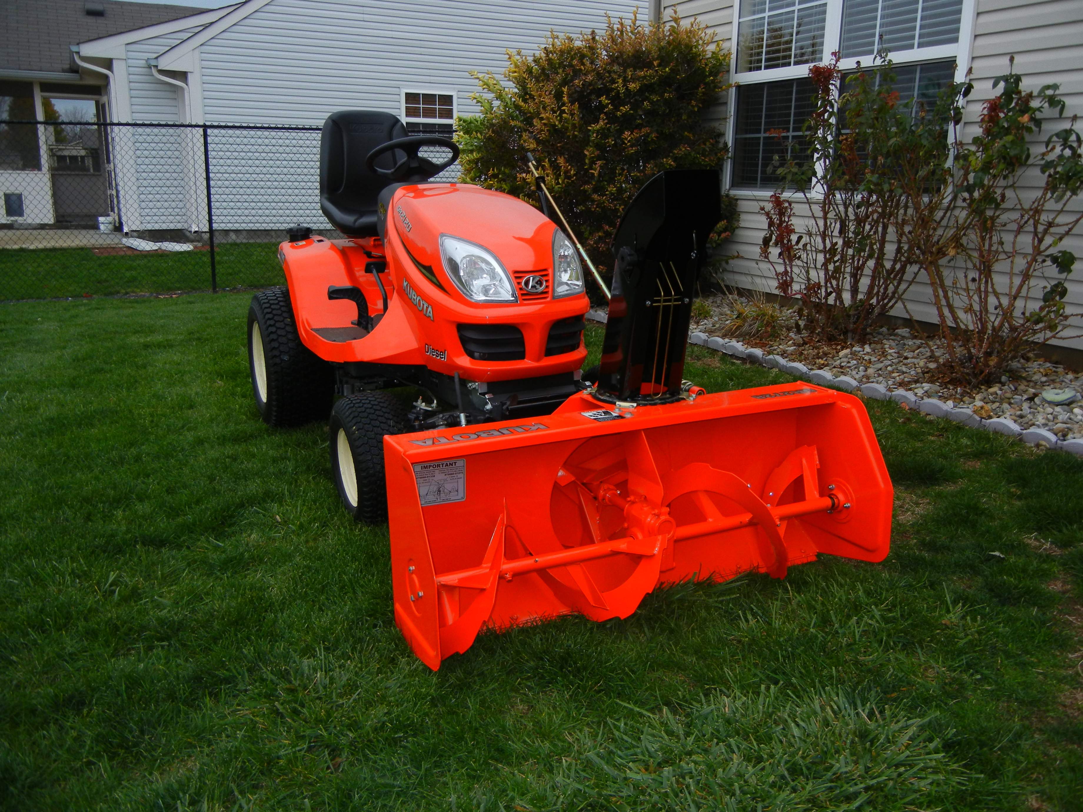

I think you could part it out and make more money. You have the MMM which is worth some cash, and the diesel which is worth a pretty penny. You still have all the other parts which are worth money. How does the snow blower mount? Will it fit another tractor like a BX.
   / Kubota GR2100 Dead Tranny - Sell As is or Fix & Sell #14
Here is how the GR2728 snowblower mounts. I do not think this would work on a BX. Philip.
