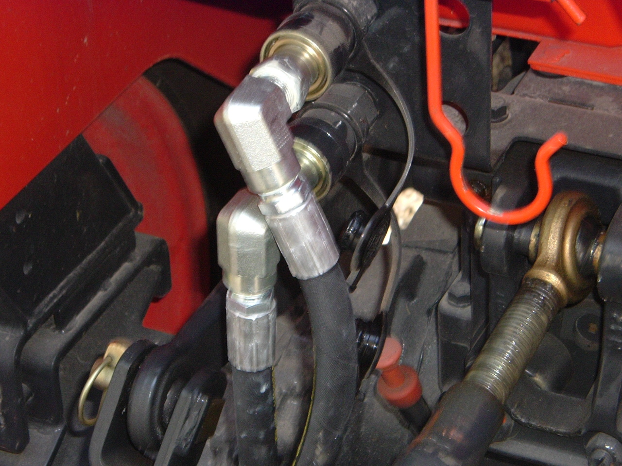

Totally confused on what makes up a remote. I have 2 little hydraulic plug ins in the rear. Does the 2 plug ins equal 1 remote or 2 remotes? Or is those 2considered 1 remote with 2 functions? And if its 1 remote with 2 functions is there a way to add a 3rd function for rotational angle?
Thanks,
Mike 2 plug in hydraulic connections = 1 set of remotes. You can do one thing at a time. It is what I have.
   / Kubota Grand L3540 HST+ or Kioti DK45SE HST #53
Mike to help you understand the 2 little hydraulic connections a little better, the lever down below the FEL joystick, goes two different directions, forward and backward. one direction pushed high pressure hydraulic fluid out of one of the A connector and will take fluid back from the B connector , and the other direction pushes out fluid from the B connector and takes fluid back from A connector. so it is bi directional.
So it is typically used to extend a hydraulic cylinder to extend and retract, both under pressure, not just one direction and rely on gravity or some other force to retract the cylinder. It can also be used to spin a hydraulic motor as long as the lever is held in one direction, and spin the motor in the opposite direction when the lever is thrown in the other direction. When in Neutral, no fluid is pushed or accepted back in on either port..
Now that brings up another discussion about do you still have your detents in the lever or where they removed by the dealer before delivery?.. when you push the lever all the way forward for example does it stay there like to run an hydraulic motor or to supply hydraulic flow to some downstream device. If so, you must make sure not to accidently leave that lever in that position for more than a few seconds without being hooked up to a device which will return the flow back to the other port, because if you have nothing hooked up, the flow will have no where to go, except to the end of the sealed connector. Then the pressure will build, until the relief valve opens on the main hydraulic pump.
This is not good, as it creates heat having the fluid run over the relief valve, and bogs down your engine. You can check this operation by running your tractor at idle, and pull or push the lever and hold it, and notice the engine rpm decreases and strains. Don't do this for more than a few seconds to prevent overheating, and possible damage of the pump.
James K0UA
   / Kubota Grand L3540 HST+ or Kioti DK45SE HST #54
Mike now look at the pictures TripleR posted of his 3 sets of hydraulic remotes. notice he is using one set of remotes for his "top" and the second set for his "tilt" cylinder and has a 3rd set that he could use for instance for an angle cylinder on a rear scrape blade. Or for anything else he wants to rig up and use at the same time as his top and tilt, without taking off hoses and rearranging his connections.
Thanks,
Each "remote" has two plugs....fluid going out, and fluid coming back. R,
Here all three are in use, Top and Tilt with hydraulic shanks on the box scraper.
